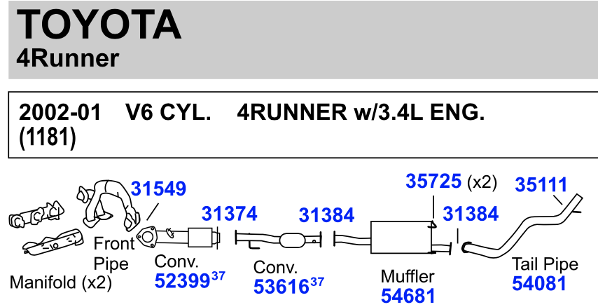

Going by Walker Exhaust's lookup the '01-'02 are dual cat regardless of emissions standards, they do have different listings for Federal and California. See attached diagram.
Drew's right about the '00 Federal cat having a different flange than the CA.

oops forgot to attach the image...
If it seems to be running ok I'd try an O2 simulator or spacer (two spark plug defoulers). I'm going to try the spacer myself; just got a pending 420 code on mine but appears to be running normally.
In '01 and '02 the emissions standards for Federal and California are exactly the same and are indeed dual cat. The reason for the different parts listings is aftermarket parts in sold in California must be specifically approved by CARB (California Air Resources Board). The Federal parts are built to the same standards but have not been through the CARB approval process.
