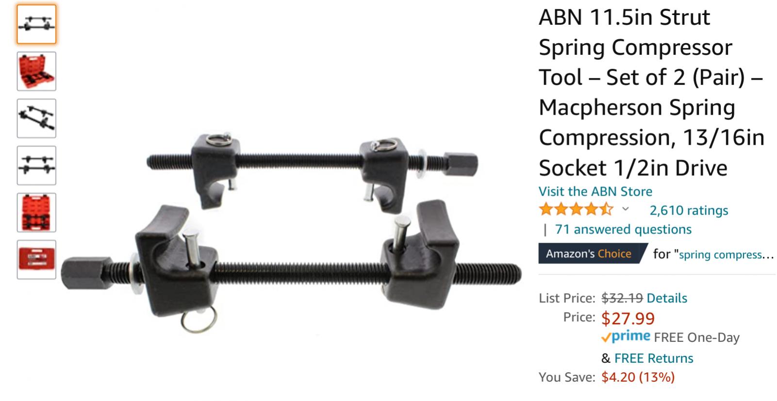

I purchased a spring compressor from Amazon and found it to be and easy job with no issues. Just soak all hardware with penetrating oil such as Kroil or your favorite product beginning a week or so before tackling the install.
Below is the spring compressor set I purchased.
I used it when installing the rear springs as well though it really wasn’t necessary.
