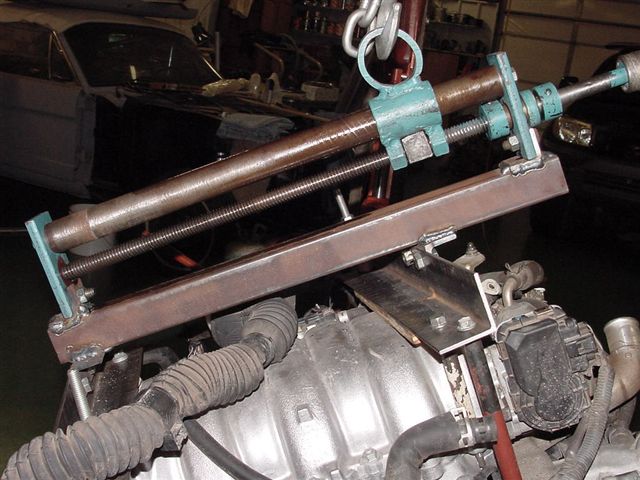

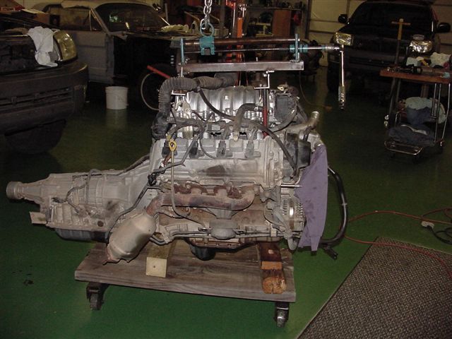

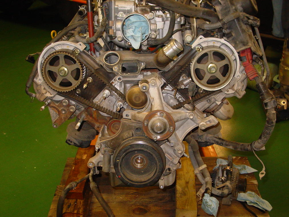

I have done it. I had to make a bracket and make some bolts adapters so I didn't have to pull the intake. I also pulled the transmission with the engine. This is also a good time to do the timing belt!

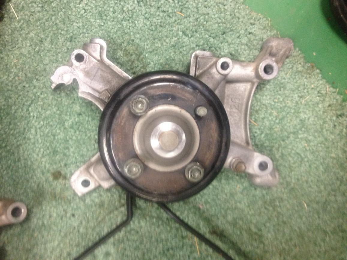

If you keep the engine or can get a part, I need the water pump/fan drive bracket.
Ok send me pics of what yall need, why didn't you use the hooks on the sides of the intake to pull the motor, and why a so did you pull the tranny

I bought the SR5 (#2) with a bad motor, replaced it with the motor and transmission from Sport (#1) that I knew the complete history of since I bought it new.
The hooks will not allow you stab the tail of the transmission under the firewall while clearing the radiator support. They are used on the assembly line for installing the motor/trans to the frame without any body around it, guessing here. Using the old chain and hooks for the engine might work, but you will have very little adjustment to align the torque converter and the flywheel bolts. The picture shows the homemade balancer that will allow the engine/trans to almost stand on it's tail.

Ok shoot me a message Friday and I'll take it off and set it aside

Alright the motor is out and ready to part out. By the way the intake valves look the heads are good, I think some of the rings are bad atleast one so that's what I know about the bottom end. I'll start a for sale thread
