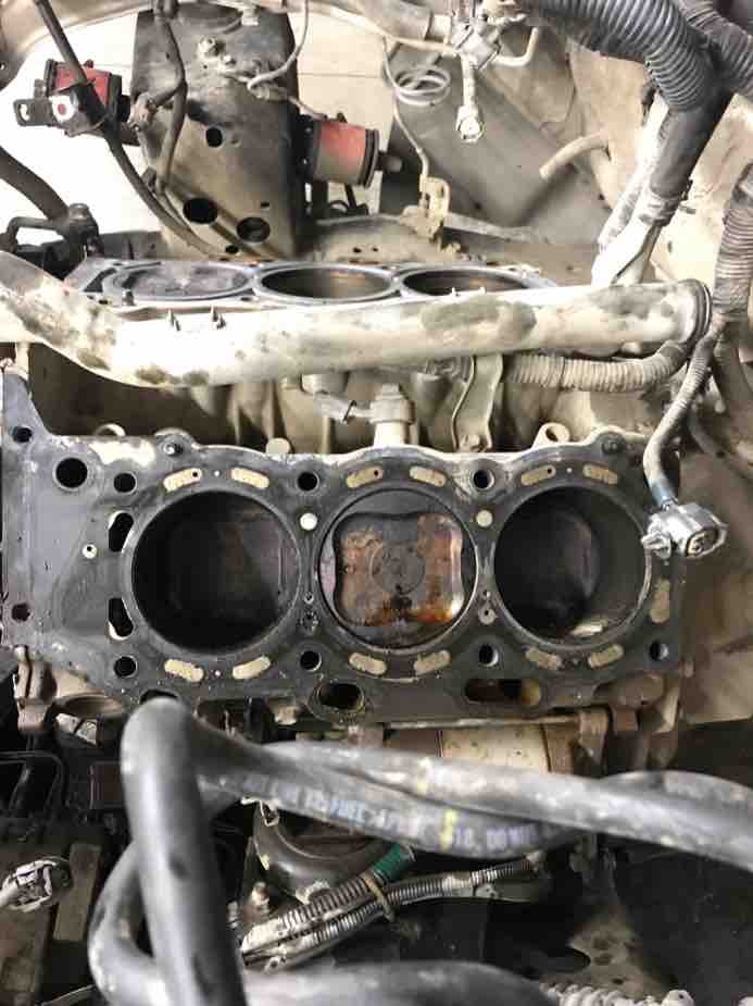

Mine never overheated, reservoir was always full (radiator wasnt pulling from it due to air pockets), could hear air pockets in the heater core (waterfall sound) for months, got the cold start cyl 4 misfire code once randomly, did a leak down test shortly after, failed. Opened up the motor and it was obvious it had been leaking. $3900 later and it’s fixed, that’s including discounts for working at Toyota. But I also took care of a lot of other parts while I was in there. IMG_6287.jpg
