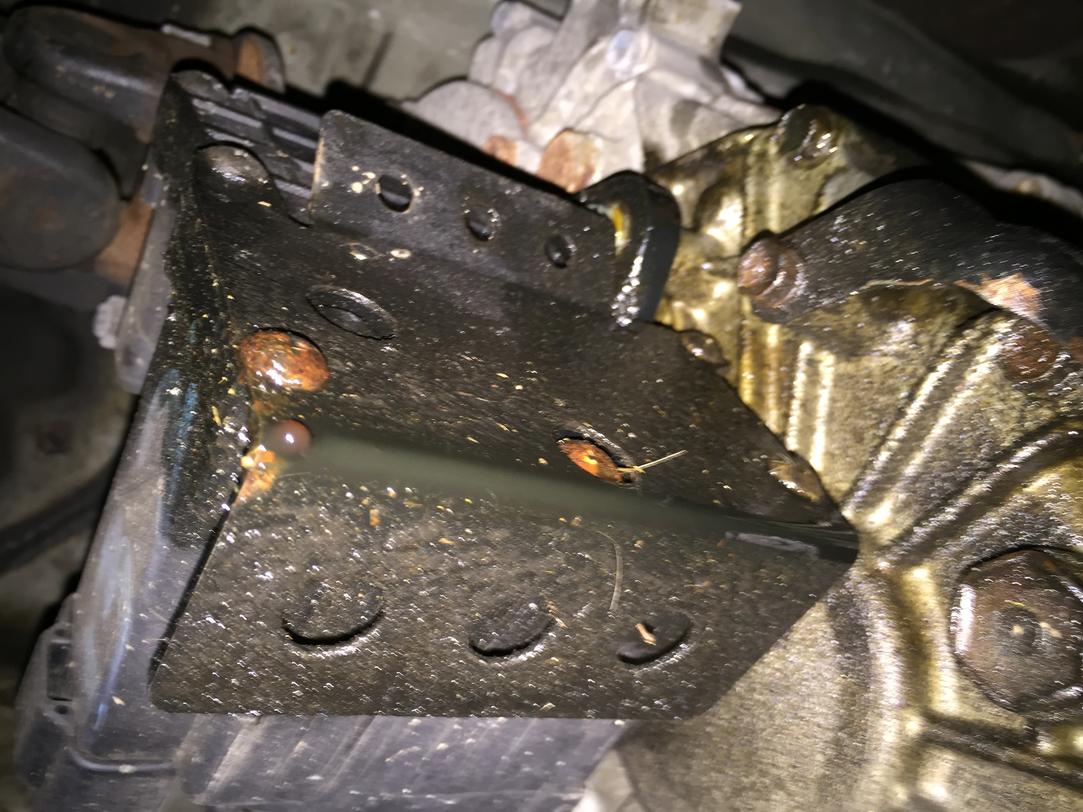

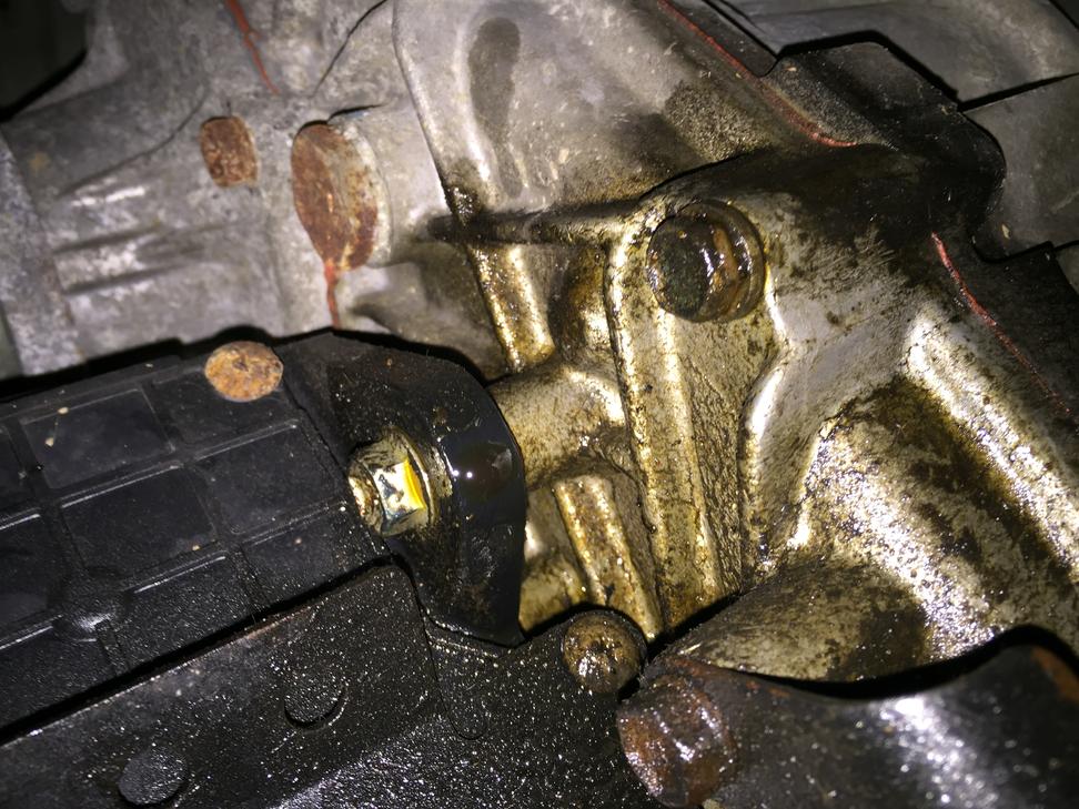

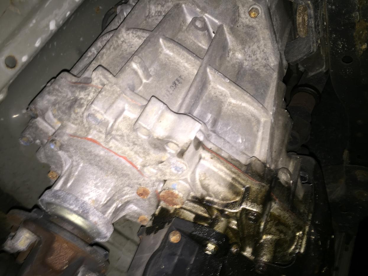

Does this look like a transfer case leak?
Hey guys what do you think is going on here?
Is this the leak you guys are talking about? I just bought this 2003 4runner about four months ago and actually saw this leak when I bought it but I only paid $4500 for it. It's got 180k miles.
I got to get this fixed.

I also had a drip from the transfer case where it meets the actuator box. A reputable transmission shop estimated it would cost $2500 to remove the transfer case in order to replace the ($5) seal.
Instead, I added a few ounces of Blue Devil Oil Stop Leak when I topped off the transfer case gear oil. It worked great. I haven't had a single drop leak out since.
2004/120k miles

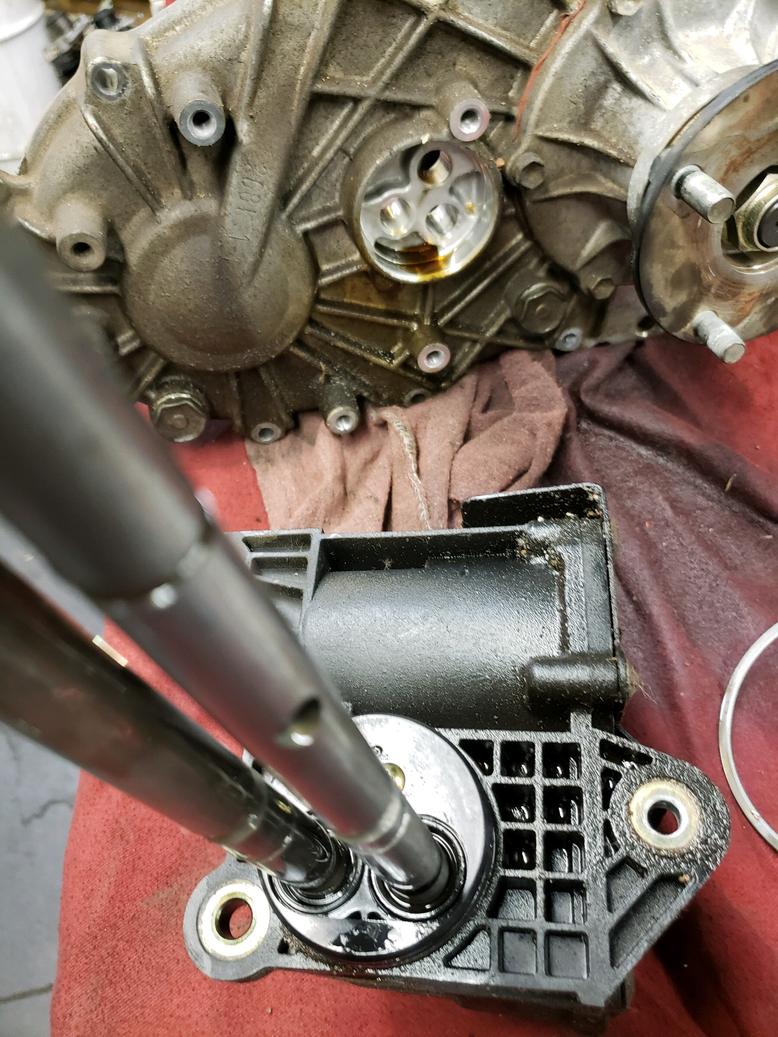

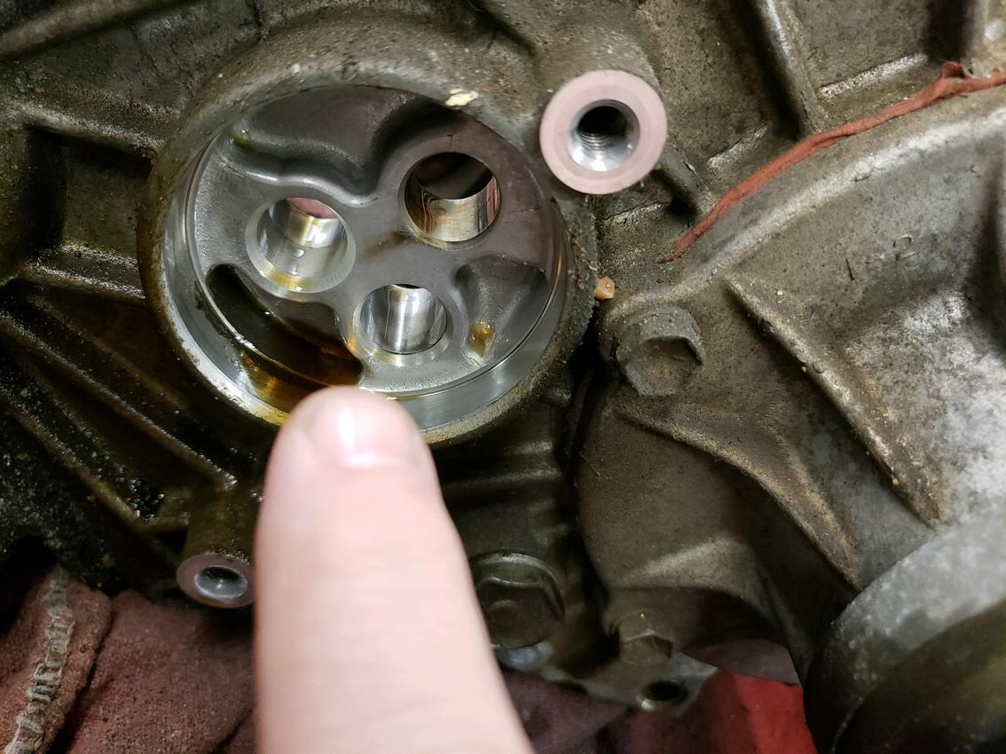

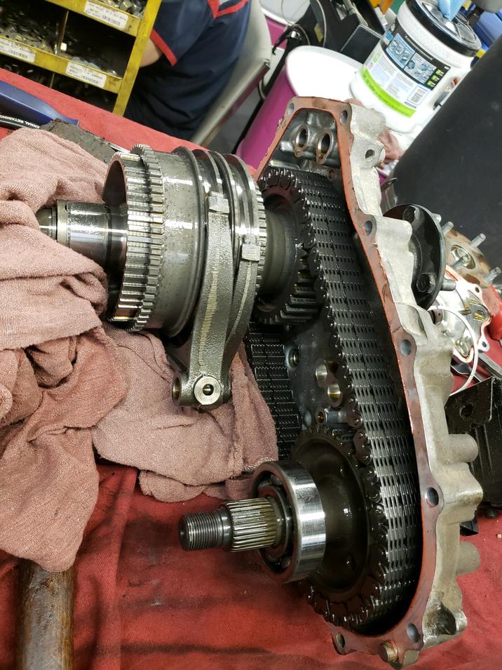

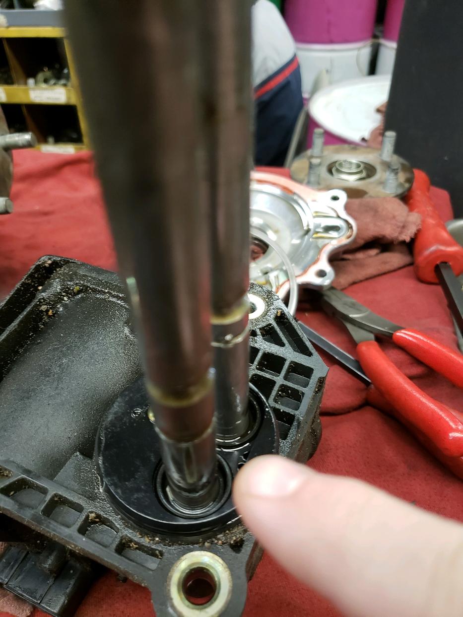

Hello, newbie posting.
I have a 04 V8 that was leaking fluid from what turns out to be the transfer case motor seal. They are replacing the seals and now are telling me I need to replace the actuator because fluid went past the seal and soaked the actuator motor. They said it went past the rod seals on the actuator box assembly and has wrecked the actuator (second picture). They also say the rods are loose or have play. I’m headed over theee today to have a look but I’m wondering what you guys would do? Is there a way to test the actuator? I don’t remember having any shifting problems from LO to HI. Is the actuator box sealed or is it possible for fluid to be inside and cause problems? Is it possible for there to be play in the actuator rods?
If it turns out you guys think I need to replace it, what sites are you getting it from? Toyota here in Denver wants $994 for the new part but Im wondering if you all would recommend a different manufacturer?
Thanks!
Thanks!
Hey Mach, what did you end up doing?
I'm about to fix the seal myself soon and I'm curious how they knew oil was getting into the actuator from those pictures? the oil I see on the TC I would expect to see (Am I wrong, should there not be oil there?) so how do they know oil got past the shaft seals on the actuator itself without opening the actuator? I'm hoping to find this out so when I take mine off to fix the seal I can make sure my actuator is still good.
Anyone else know about this?
Thanks!
