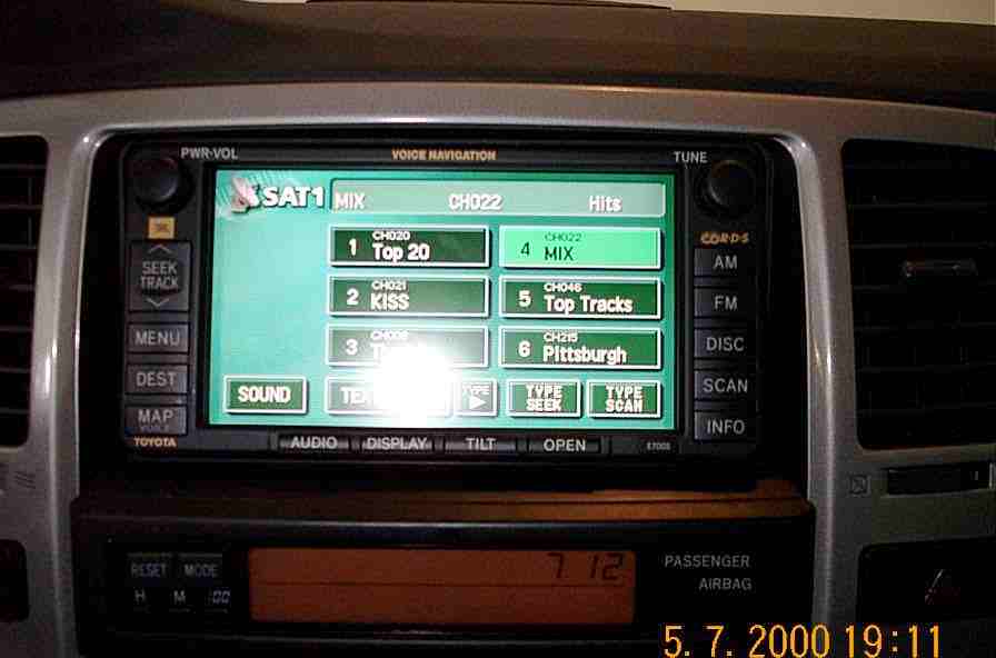

2005 Factory Nav w/XM integrated.
irpete - nice documentation on the install. Thanks for the plug also. Give me a call. 877.885.2900. I've got a question about the y adapter.
Thanks.
The XM kit was really plug and play. Just press the AM button once for AM, again for SAT1, SAT2, SAT3.... There was no other wiring issues to deal with. I'll try to take pictures tonight when I get home from work.

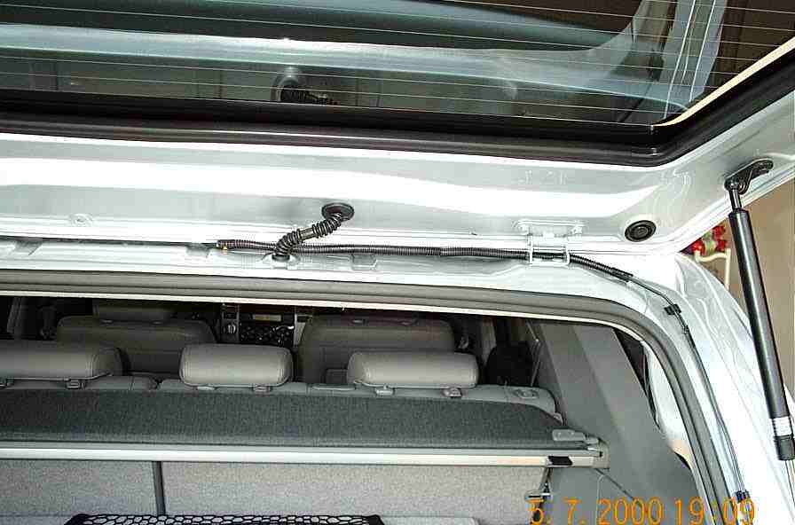

For those interested here are a couple of pictures of my antenna install:
This one shows how I routed the antenna cable along the weather stripping.
Here is another picture that shows the antenna wire leading down to the tail light assembly. I made sure to have the wire enter the tail light from the bottom and included a drip loop to help prevent leaks.

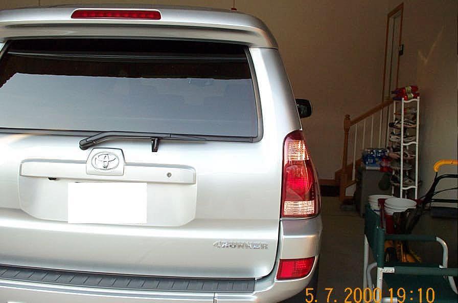

Here's a view from the rear with the hatch closed. Doesn't show much but I guess that's the idea! No wires visable.

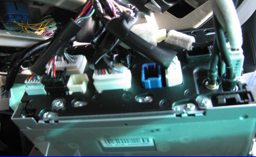

Mark86, I do have the rear seat audio. In the thread where I posted the picture, I thought that the CD changer port was the small, white, unused connector to the bottom-left of the fan. From the other link in this thread with the detailed labels, I think the rear seat audio/cd changer port are the same thing and is the black used port to the left of the unused white one. So I'm assuming that Y adapter will be neccessary to keep the rear audio and add XM, cd changer, or IPOD.
I attached another pic where you can see this black port better... this is angled looking upward from the bottom of the unit. The port I'm thinking is the cd changer and rear seat audio port is the black port that is 2nd from the left.
grunner3,
You are correct. The Black one is the cd changer/RSA/XM and the small white one is for the Microphone should you want to add voice activation to your Nav.
