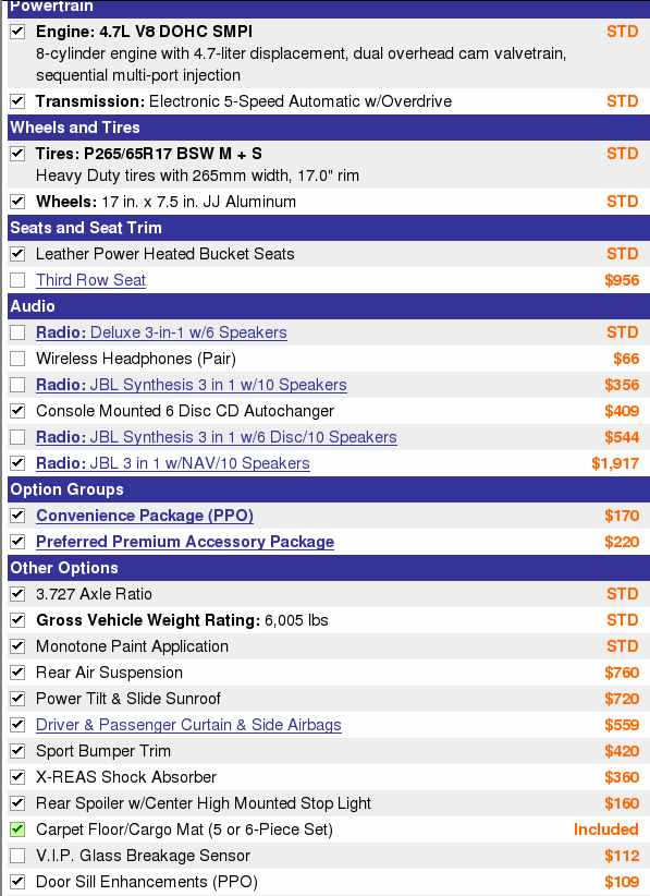

Just went and looked at 2 - one with Nav and base JBL - no changer.
Here is the carsdirect build of what I want -

The 2005 navigation system only has 8 speakers instead of ten. That is a change from 2004 to 2005. Carsdirect is still listing the nav as having 10 speakers. Toyota replaced the two speakers in the cargo area with the mirrors.

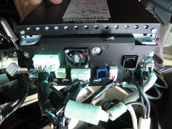

OK, I ripped apart my dash this weekend on my 3 week old 4Runner and pulled out my '05 Nav unit. I tried searching old posts and can't find a complete picture labeling all of the various connections on the back. Can anybody who has attached a cd changer or IPOD verify that there is a connection on this for a changer? I'm thinking that the small unused white connector near the bottom and a little to to the left of the center is for the changer but I can't find a past post to verify this.

If I remember correctly, that is the location where I connected the y-adapter for NEO Ipod control. The IPOD adapter emulated the CD changer.
