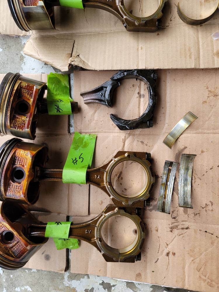

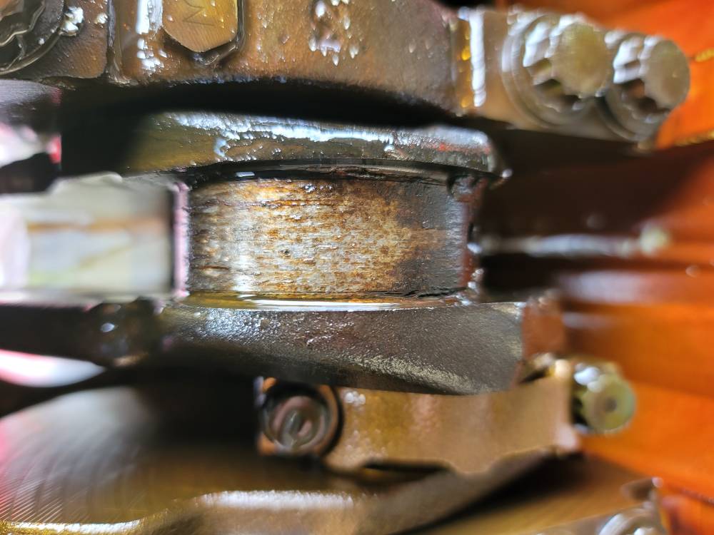

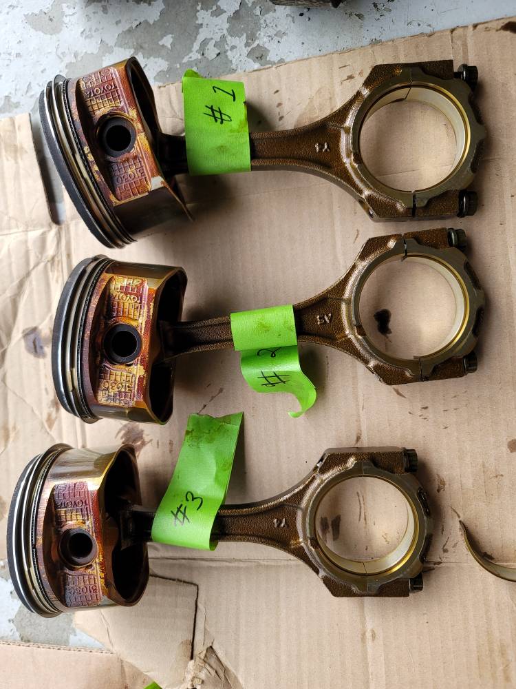

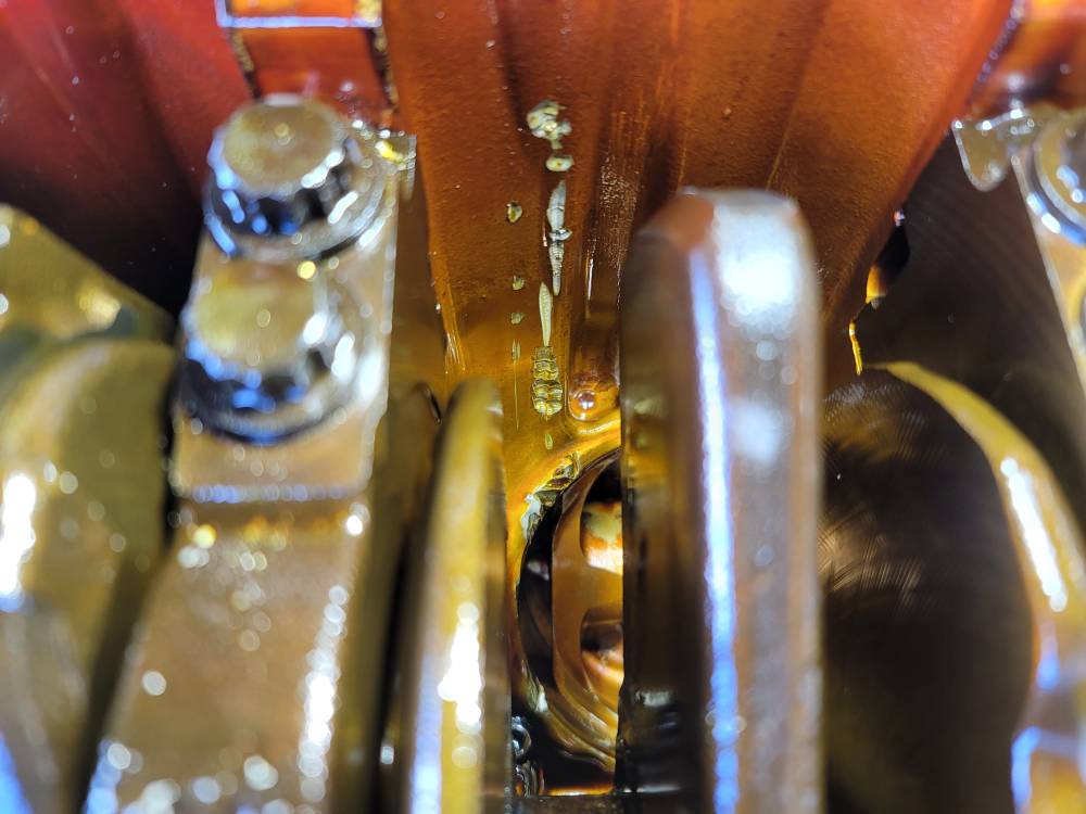

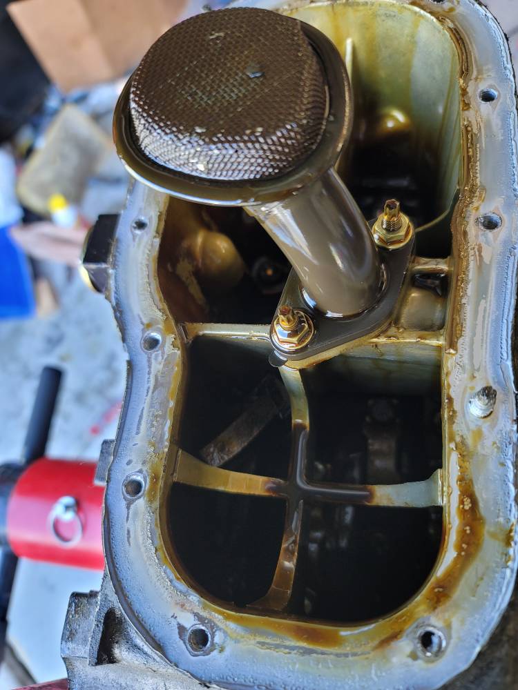

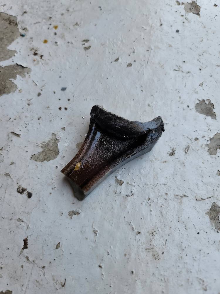

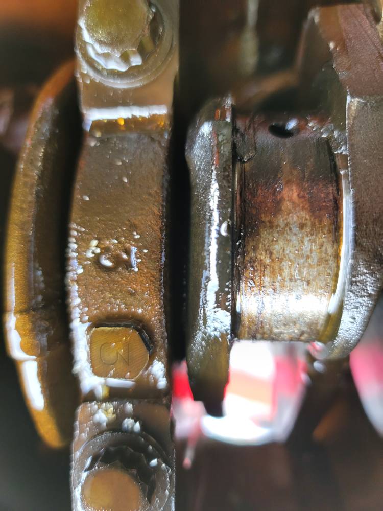

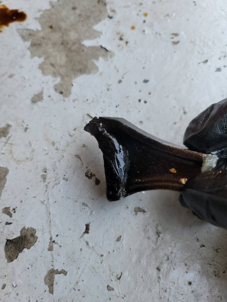

More bad news... definitely spun a bearing. The crankshaft cap bearings very worn as well.
Engine block and crankshaft may be toast. Very concerned about those deep scratches below the cyclinder wall.

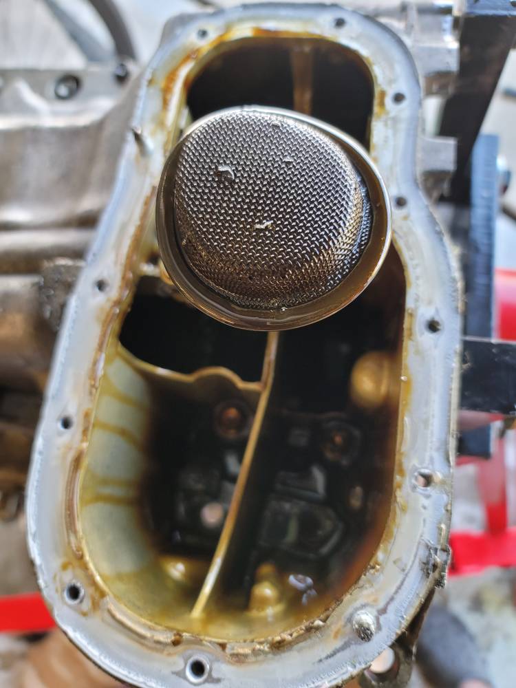

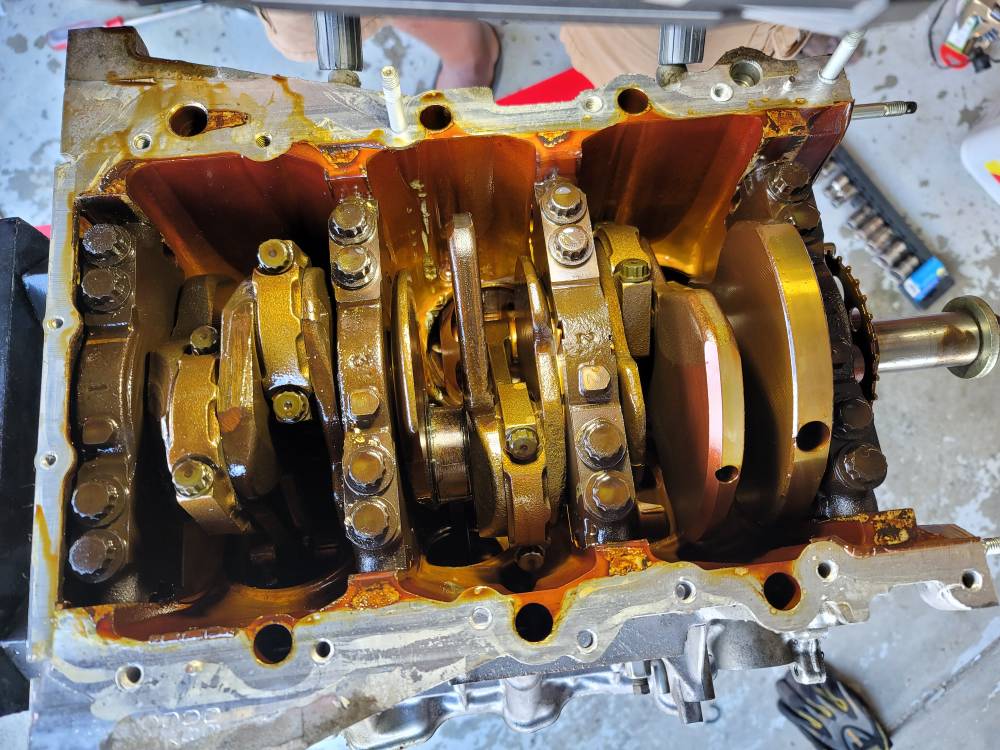

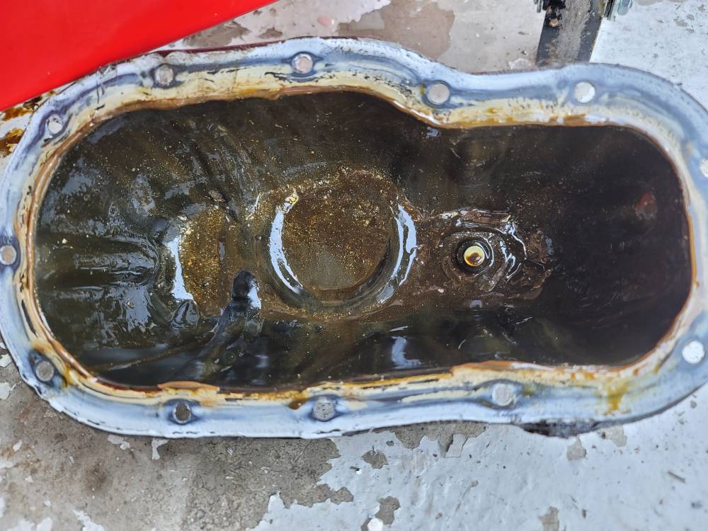

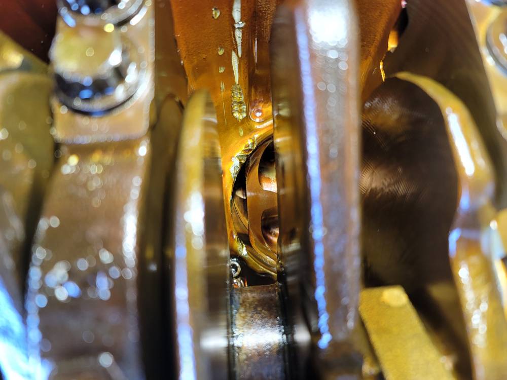

Taking block and heads to machine shop tomorrow.20210705_171744.jpg20210705_171736.jpg20210705_145507.jpg20210705_145451.jpg20210705_143409.jpg20210705_143258.jpg20210705_141023.jpg20210705_141014.jpg

Have you called any dismantlers on what used engine would cost you? You will NEVER rebuild it back to original toyota specs. These engines are precisely built in clean rooms by experts. It may sound like fun until it grenades on you. Just sayin
Drcoffee,
I do get the point you are trying to make but I need the challenge and with the help of this forum, it can be done. I really hope I can avoid the grenade part though.
Sent from my SM-N986U using Tapatalk
Ouch, that's a lot of carnage. Good on your for tackling this but personally I would get a used engine. It would always be in the back of my mind that I may have missed a damaged piece.
Crank definitely scrap, but block and heads should be salvageable.
The damage is fixable in my humble opinion. The crankshaft can be definitely fixed...re-grinding and polishing can be done by a specialty shop and oversized crank shaft bearings can be used.
My vote would be, buy a used engine, replace the timing chains while its out, and get the truck running again.
Keep the pile of bits so you can tinker with rebuilding it and then trash it. If you had bottomless pockets and a full machine shop at your disposal, I’d tell you, your nuts, go buy a used engine. :tea:
This is what I would do as well. All of those bearings are trash, crank is f'd from all of the washout of the head gasket leak, a couple rods are cut/broken??, it's not going to be cheap to fix all of this.
