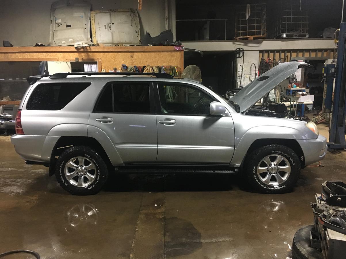

Here's one I just fixed for my daughter
The rear-end ratio is different for the V6 (3.9x) vs V8 (3.73). So, swapping in the V6 will leave you with a little less low-end response than stock unless you swap axle gears as well.
Pictures are louder than words
Awesome Job man. I bought my V8 at an auction too - the only thing wrong with it is its missing a upholder insert and shift lock button. If you wanna sell any extra ones you may have hit me up!
