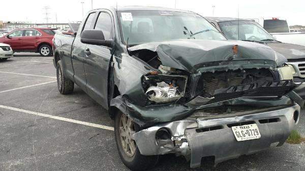

Just picked up my "donor" also. I am going a little different route than you haha!

Best of luck on that transplant, please do a very detailed build thread if you do get it working. That's something that'd be nice to see 5.7L V8 4th Gen. :)
My life goal! Don't forget the Magnuson supercharger!

I don't care if they even get it working! Just taking a picture of that 5.7 shoved into the engine bay is enough to make me cry.
