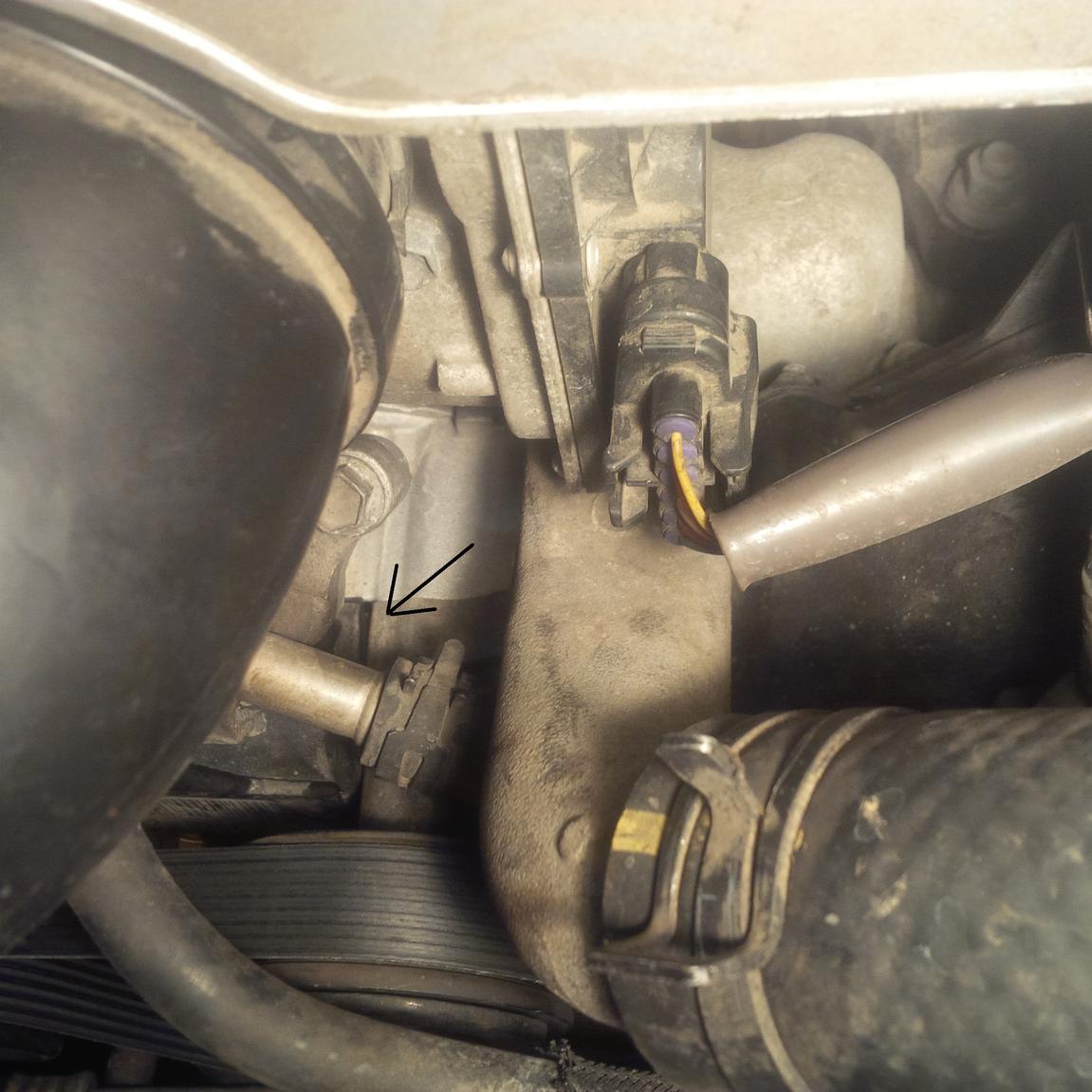

I got my timing belt replaced about a month ago. I started to get random misfire codes on every cylinders a week ago.
Yesterday, I brought the T4R to the carwash. Hikes! Engine stalled as soon as the water jets hit the front.
I brought the truck to my mechanic friend. We spent the after noon trying to figure what kind of human error during the belt change process could be causing it.
We finally nailed the spot. (See attached picture)
We suspect the mechanic might have damaged the CamShaft positioning sensor/wiring or circuit as we are getting a OBDII P0345 code.
What do you think?
Picture - One table spoon of water poored in that crack (see arrow) kills the engine. Then it is very difficult to get it start. We also get P030(1to8) codes aka misfires.

Here's a follow up question - When you do a close up on the picture - you can clearly see a gap and a misaligned rubber part. Could it be something as simple and stupid as a Timing Belt cover not properly put back in place?

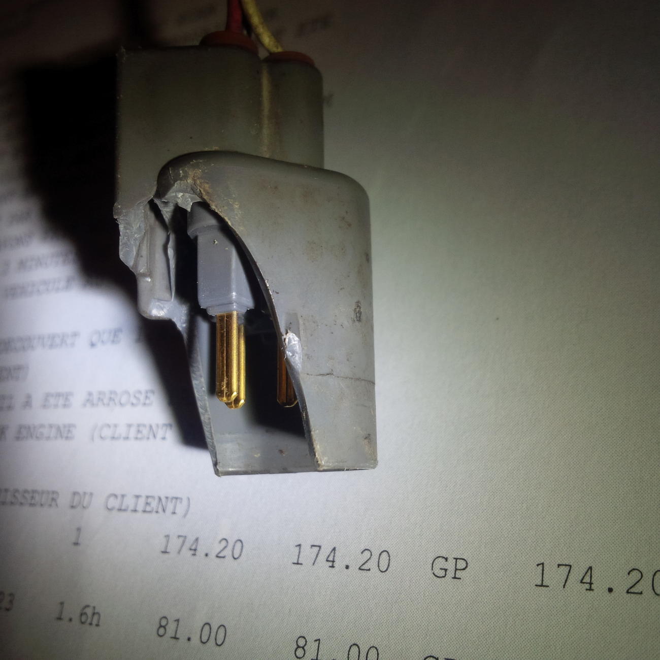

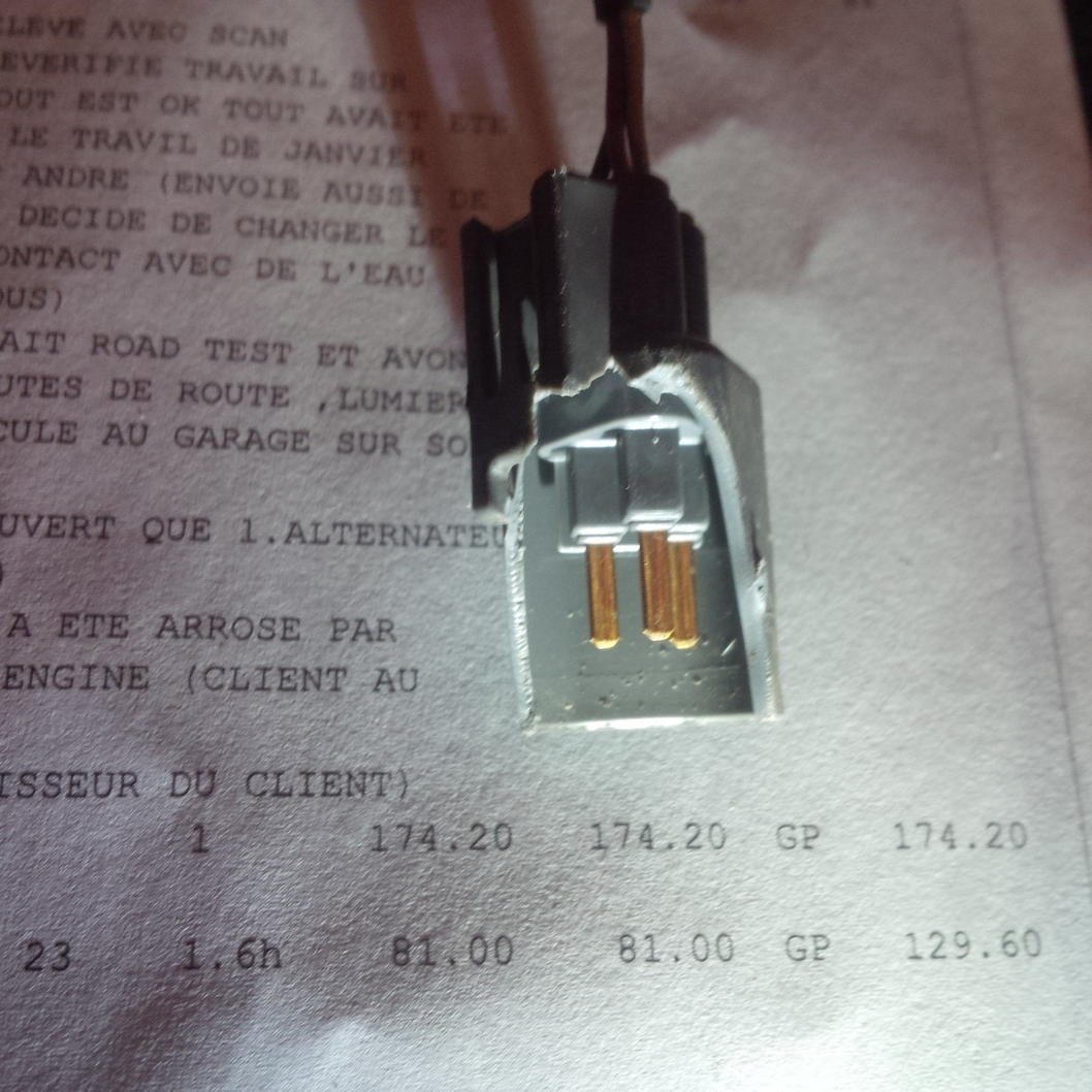

Finally got my truck back today...
7 days later, towed twice, burnt alternator, camshaft position sensor replaced and $500+ hand and labor.
Here's the terminal of the so called defective camshaft position sensor.
No wonder it didn't like water... There is a big chunk of the plug missing. The connectors are exposed.
But it is all coincidences and have absolutely nothing to do with the timing belt service...
Whatever...
I'm just glad to have my baby back.

That's been recently broken. Recently. JMHO.
I'm sure it is. Just by the lighter color on the edges of the fragments.
The thing I'm not 100% sure is. Did he brake it during the timing belt service?
or while replacing it because it was "defective".
I lean toward the first option - Because it would also explain why it was so sensitive to water.
