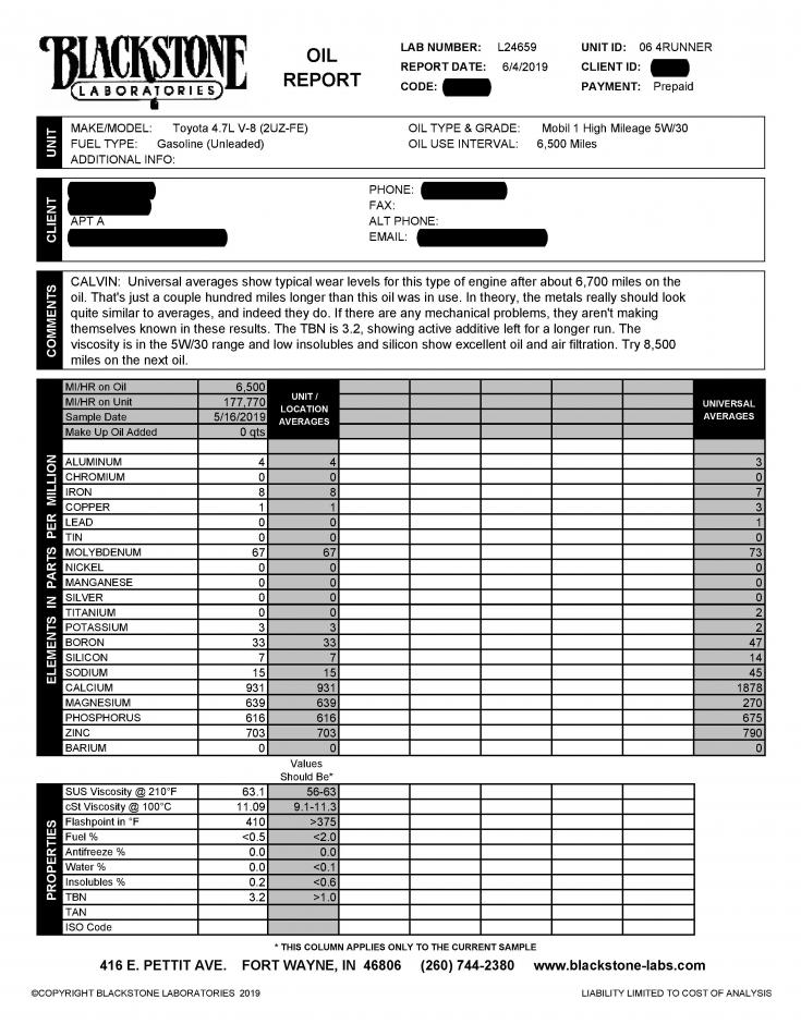

Here's my last oil analysis on M1 5W-30 High Mileage. I've only put about 22,000 miles on the 4Runner since owning it, so no idea what was used before me. I'm a little skeptical about running to 8,500 miles for the interval, but numbers don't lie and the engine is running fine!

Report looks good! Any particular reason you chose to go with M1 HM? Out of curiosity, how many miles are on the engine?
Honestly, it's just kinda what I have used in the past with my BMW and it did well on the reports with that car. It is pretty cheap and available at Walmart as well.
I just rolled over 181K, so a little up there but not too high :)
