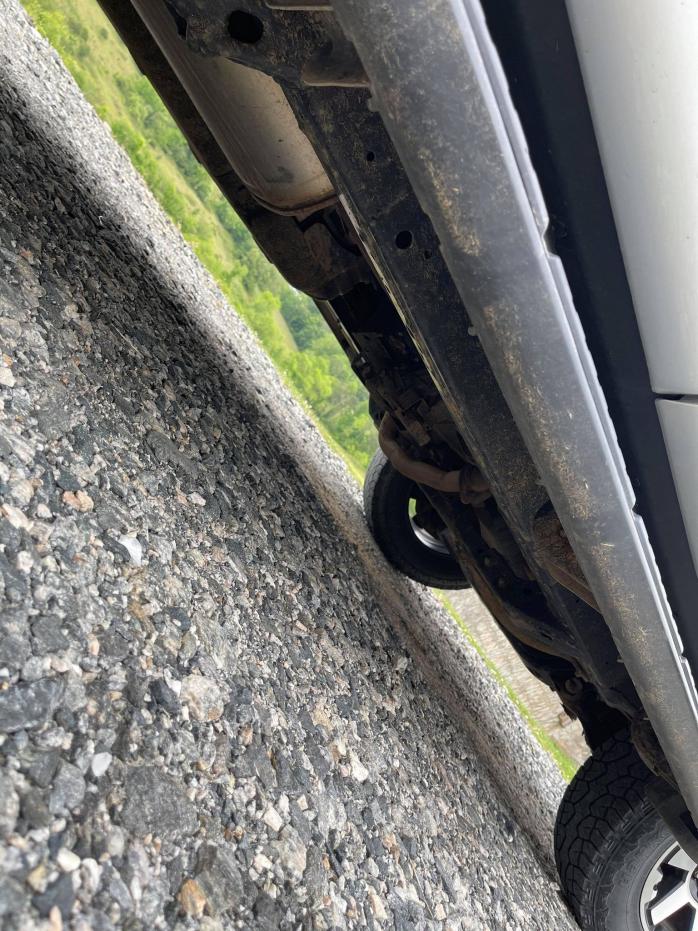

I have some pics of the underneath. I'm not the best at assessing this stuff, unless it's real bad and falling apart LOL

Yeah, it's impossible to know from a picture for the trouble spots.
Regardless, 60% of the problem starts inside the frame rail where no one can see it anyway... Then one day a hole shows up.
That's the trouble with the rubberized undercoating, its textured look hides the rust really well to visual inspection. In any case, once it's applied to a surface, eventually water infiltrates behind it in spots and starts to collect in the void, keeping the metal wet, accelerating the corrosion process. In perfect world it would have flawless adhesion, where nothing can get between it and the metal... but alas, 'tis not this world.
You could/should get an inspection done at a reputable shop. Those are one of the many things they should be looking at.
