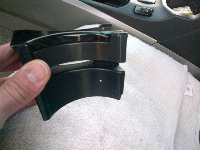

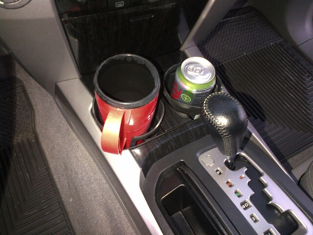

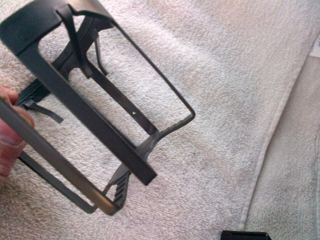

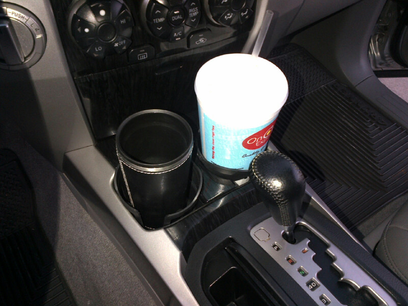

So, I picked up my 2007 Limited from the dealer on Friday evening, and on Saturday morning I proceeded to spill some coffee from my 20 ounce Oncue Styrofoam cup. Because I read my owners manual, I knew that I could adjust the center piece for a tighter fit. Did that, and noticed that it was really too small on my side, and waaay to big on the other side.
So, I check out T4R.org to see if this is an issue, and sure enough, there are some other threads discussing this horrible design and methods to fix it. Because I don't want to be chained to a certain type of travel cup/glass, and I am cheap, I wasn't quite satisfied with the options presented.
Here's what I came up with...

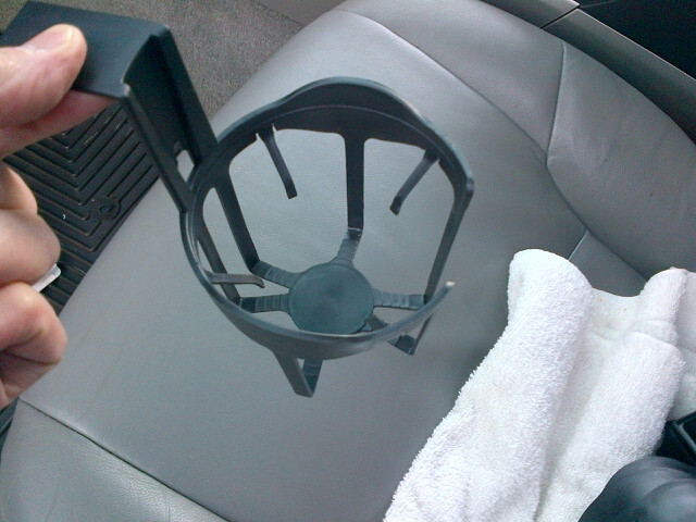

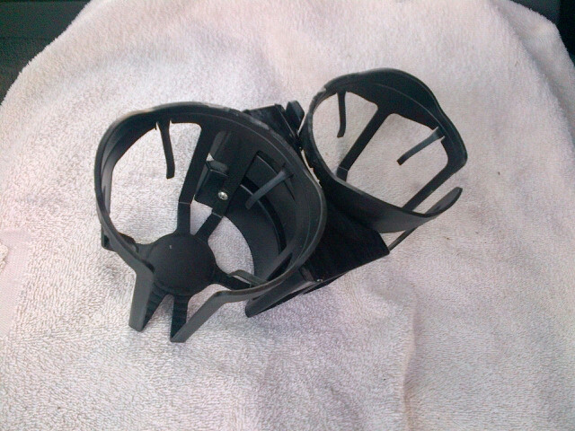

1 - Purchase package of four "Bell Drink Holders" (with inner "springs") - $2.99 at Autozone.
2 - Remove Hangar and smooth out with a utility knife.
3 - After placing in the cup holder and finding a "natural position" drill holes through the cup holder and the center piece (I used one screw per side, but you could use two).
4 - Screw 'em.
5 - Fits any size cup/bottle/glass I could find (tight fit for my Nalgenes).
This is easily removable, and easy to revert back to the stock configuration, with nothing but two unnoticeable holes in the center piece.
