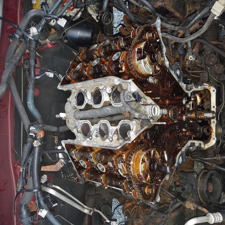

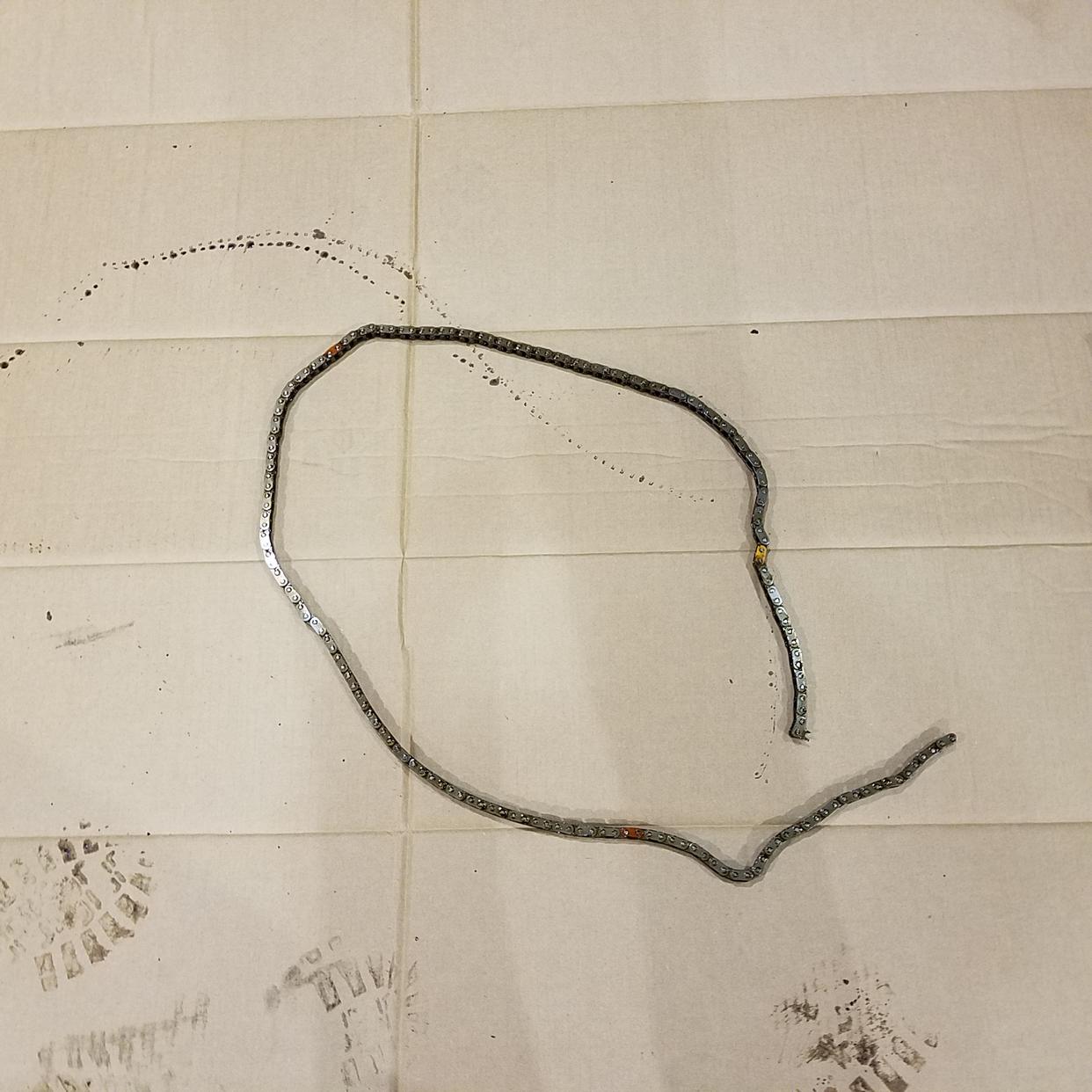

While in there, make sure to throw a new timing set at it. All that will have to come off anyway, very smart to do it now. I'm in the process of doing this job now. Chain broke, possible bent valves, the job is A LOT of work.
Hold crap! Don't take this the wrong way but how often was the oil in that motor changed? That's more crud than I've ever seen, no wonder the chain broke - check the guides and everything else under there. I had a valve cover off on mine with 130K to replace the leaking gasket and all the galleys, bearings, etc. look like brand new with none of that golden crust all over yours. Haven't seen that much buildup in an engine in many years, modern oils will take a lot of abuse before they start that kind of breakdown.
I bought it this way, has 246K on it. Engine is CLEAN, no sludge at all as you can see in the picture. Only thing on the engine is the normal brown oil staining, absolutely no crud at all not even down on the oil pan. None of the crusty crap you normally see inside a neglected engine. Cam lobes are spotless, tappets are spotless.
