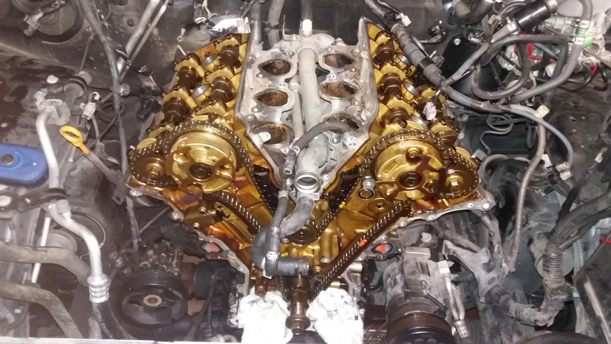

This is what the inside of a 2005 v6 with 160k looks like when well maintained. I put the chain and tensioners and guides back in being that they looked new with no stretch at all.
The job was time consuming for sure, especially if an exhaust bolt strips or you have to run to the auto parts store to get more supplies, run out of beer etc..
