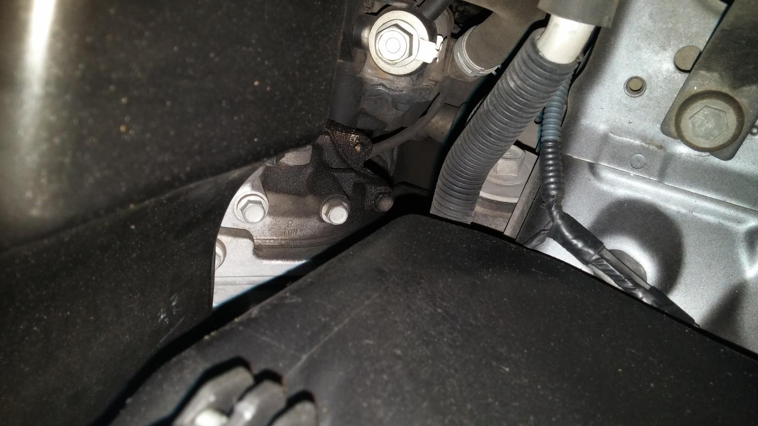

I only have 112k, but I suspect my alternator is toast. I just
had my transmission replaced at the dealership for the rumble strip torque convertor issue (covered under a 3rd party warranty I bought with the truck). I literally picked it up this afternoon, drove 10 miles to work with no issues other than I noticed all my radio and trip memory was reset which I assumed was because they disconnected the battery while changing the transmission.
On the 5 mile drive home from work I noticed a whining/groaning noise from the engine bay. I traced it to the alternator. I then tested the battery with a multimeter and the engine running. 12.4 volts. I then tested the alternator directly through the wheel well by removing the gray plastic cover. 12.4 volts also with the engine running.
Im guessing this is completely coincidental from the transmission work, just a bummer they didn't catch it while it was at the dealer. I'm also surpised it seems to be dying at a lower mileage.
I did notice I have what look to be a valve cover gasket leak above the alternator area, but it doesn't look to be bad enough to drip onto the alternator.
Sorry for the dark picture. Thanks for any help. Just want to get another opinion before taking it back to the dealer (alternator is also covered under warranty)

12.4V with engine running is too low. Alternators go bad. I had to replace mine also

I don't like the voltage under load... I would either have the dealer test it or stop by an autoparts store, they usually have a hand held battery/starter/charging system tester.
