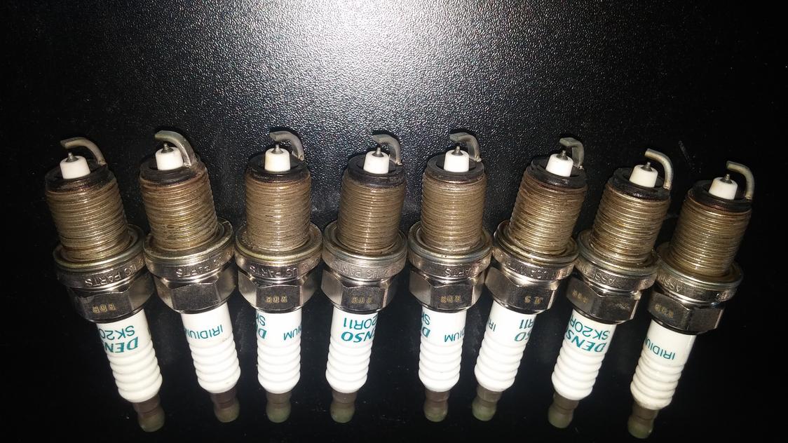

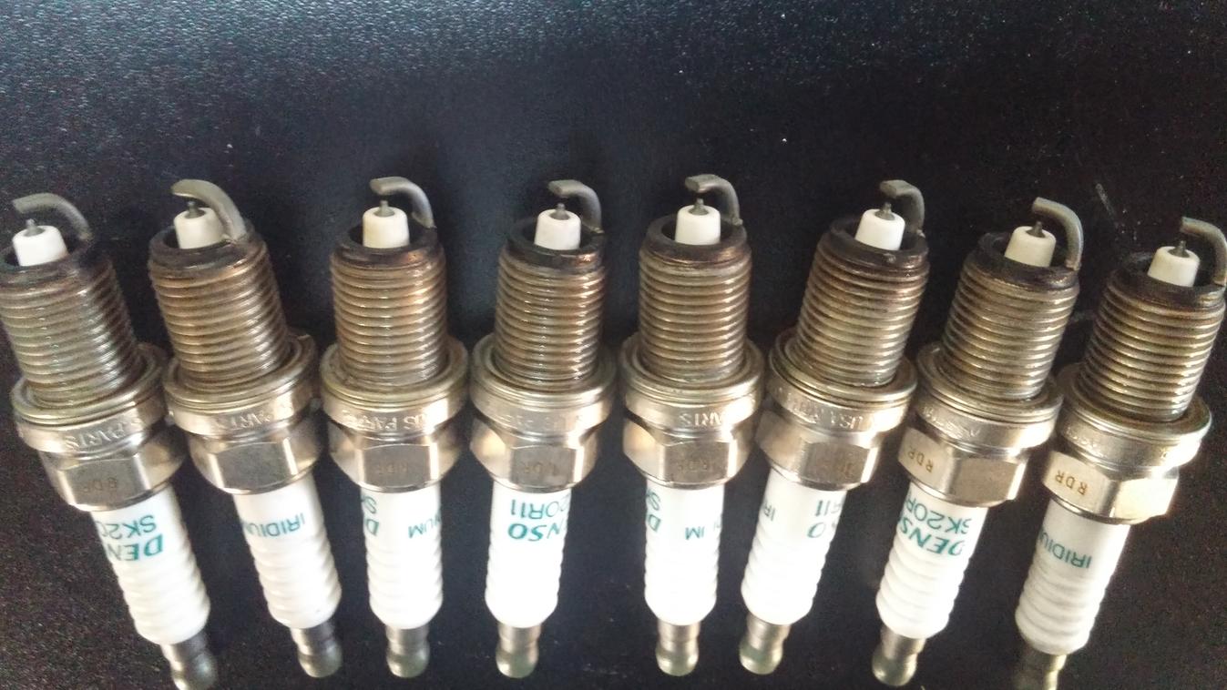

Thanks everyone for the help. I got the job done today. I just recently purchased this 4th gen, 113k Miles. I don't have any recent service records. I don't know much about spark plugs, but the old plugs sure didn't look like they had 113k miles on them. They also seemed to have antiseize on them as I ended up with a shiney metallic grease on my hands after touching the threads. Do y'all think these were the original plugs?
Those look good. They may have been replaced at around 100,000 miles if the service was done at that time.
