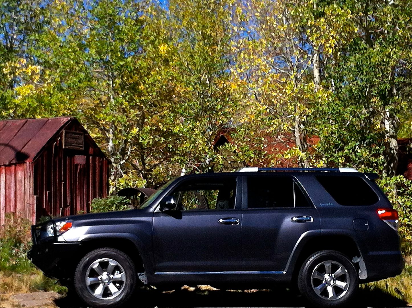

2010 4x4 Limited
Rollin on 18" 08' Limited wheelset now. Much better for the dirt!
