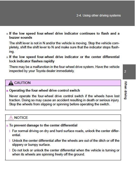

From what I understand the manual says about drivertain damage if you drive on dry pavement with locked central differential on Limited or locked rear differential on Trail. And it's just not recommended for SR5 and Trail to use 4Hi on dry pavement. Correct me if I'm wrong but I got a feeling that transfer case is more forgiving that cental or rear differential and turning on dry pavement with 4hi on Trail or SR5 would just cause unnecessary wear for driveline and front tires, but it won't immediately damage drivetrain. Sort of like towing a heavy trailer or driving overloadrd truck. So it's not a good idea for Trail and SR5 to use 4hi on dry pavement (and there is no reason why to use 4x4), but it perfectly fine to use 4hi on wet pavement or on pavement with patches of snow in winter. As I said that what I got from everything I've read on the topic so far, please correct me if I'm wrong.

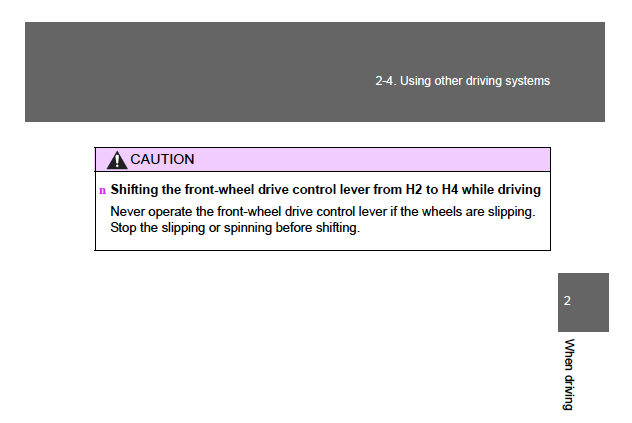

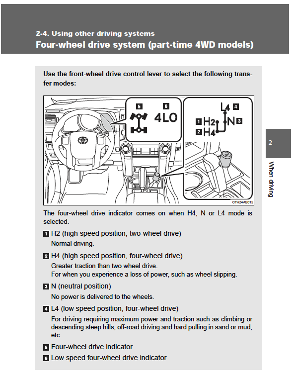

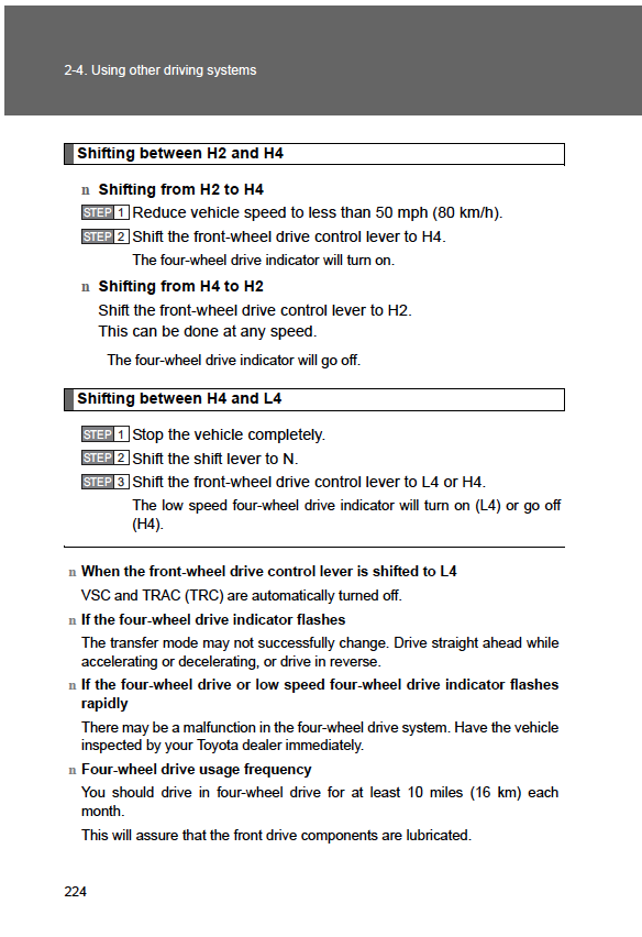

Here what it say in the User's manual on how to use 4wd System. I don't see they mention or warning anything about not to use 4wd HI on hard and dry road surface except the warning about central differential on the LT. see screen shots.

I did not debate if you are write or wrong, all i say is, something that important, why doesn't state in the user's manual.
Whether its in the manual or not, don't do it. I speak from 20 years of off-roading experience with ten different four wheel drive vehicles.
Your right about the owners manual Snow, I guess Toyota thinks everybody knows these things already. It's not very clear .
