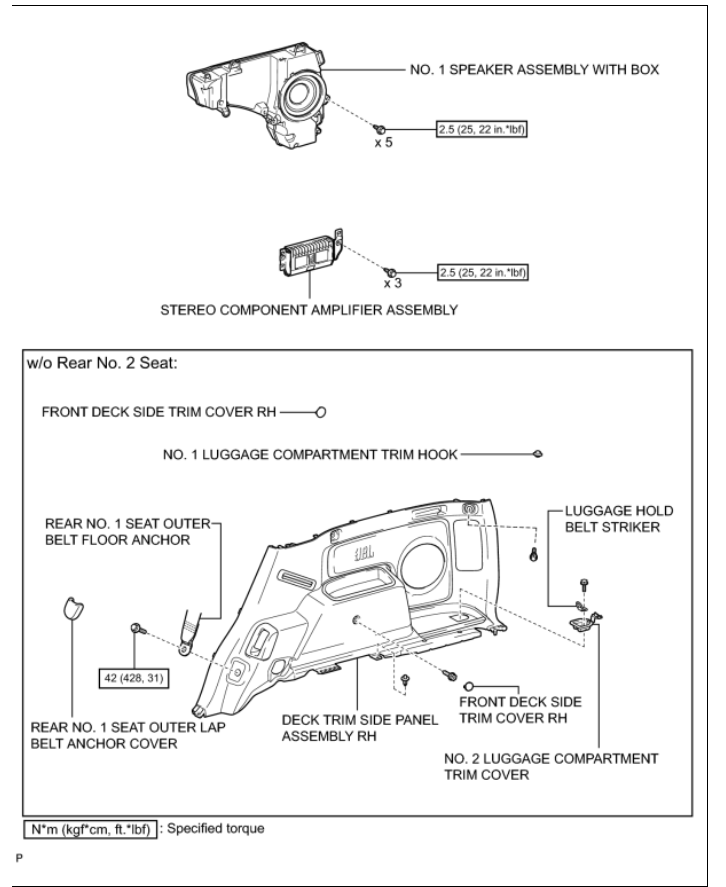

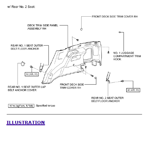

[MENTION=136015]Arkansas4Runner43[/MENTION] this may help. from the 2010 repair manual for 4runner without 3rd row
edited to add panel config with 3rd row (u have LE not sure if those do or dont have 3rd row?)
Awesome! I have a third row! Going to give this a shot after I order a sub. Thanks much
