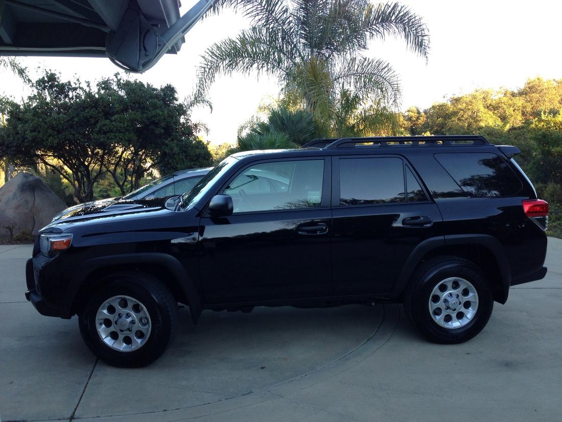

Joining the vibrating steering wheel club
Picked up a 2013 Trail with KDSS on 01-18.
After 2 visits for rebalancing, alignment and cross rotation the truck runs straight, the wheels don't "wobble" but the steering wheel humms/vibrates and "rocks" slightly and rythmically to the point that your hands tingle after a few miles on the freeway.
My guess is poor engineering in the steering geometry/mounting that's not isolating the engine/tranny vibrations and road grooves from the steering hardware. The loaner Corolla from my last visit and my wife's Prius have none of this.
The fact that the 4R is so rattle free and tight otherwise probably makes the sensation seem worse. The Lexus fix (beefier steering hardware) I've seen on here makes sense. The vibration is definitely stronger at freeway speeds and more so on deep grooved freeways (Calif rain grooves I think). The steering hardware isn't strong enough to overcome and isolate normal tire contact to the road.
