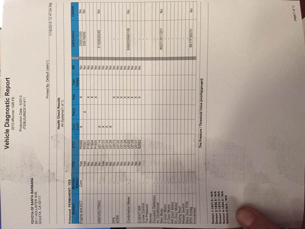

Did you ever a print-out of the healthcheck that shows all the DTCs listed and so on? I would have them print/provide you with all the information/notes they have currently for you to review and/or keep on hand. It's unfortunately not uncommon for [us] (the dealer) to ask for you to pay diagnostics and IF we can goodwill warranty it or if Toyota extends the warranty for that issue reimburse you after the fact. The problem is that typically Warranty does not want to pay for diagnostic time (seriously, it's worse than pulling teeth and typically technicians get the raw end of the deal here from Warranty) so they are just covering their ass. That being said, you're $600 in and from what little information you have presented; it seems like they don't know too much and/or have possibly not really done significant testing (not accusing them outright, just stating that based on information provided in the thread [we] don't have much of an idea what's happened to the truck.)
The interesting thing here is how accurate the service manager's statement that Toyota is now dictating testing and parts replacement, because that's typically something that happens under warranty (because they don't want to pay for things that may not fix the vehicle.) So I am curious what the story there is if it is accurate. It could be that they will not release an ECM for the vehicle until further diagnostics are performed as per their instructions. We've unfortunately run into this a couple times in the past with customers who are out of warranty but may need an ECM and we've had to open a TAS case as part of diagnostics.)
If you could get us a copy of the TIS Techstream health check data and their notes and scan them for us to review, we might be able to get some insight into what is going on here. Hopefully it's getting taken care of, it's always frustrating when a vehicle ends up being this weird/unusual and I can tell you from first hand experience that the technicians working on it are just as frustrated as you are.
Wow Thank you very much for taking a look at this. I will contact the dealer today and see if they can email me this report. Will post here as soon as I get it. I really miss my car. My third car which I have been driving for almost three weeks not is a 1972 Chevy 3/4 ton 4wd. I put a hundred miles a day on my car for work driving from job to job. I love my old truck but lets just say I am ready to stick needles in my eyes by the end of each day after driving that thing 100 miles around town...
OK here is what they gave me. Seems like there should be more but this is all they wanted to give... Update: I am being told that I have a leaking valve. Heads have to come off to fix this and Toyota might not cover it. They are opening up a new case with Toyota because apparently this is not related to the fuel pump problem that occurred in the past. The dealer is going to talk with the Toyota rep today or tomorrow and discuss to see if they are going to do a good will warranty. Man I hope so because I am sure pulling the heads and fixing the issue is not cheap...

Leaking valve huh? I mean... it's possible I guess? Do you know if they did a leak-down test on the vehicle vs. a standard compression test; I'd make sure all the ducks are in a row and that you're clear on who's paying for further diagnosis/repair before committing to anything.
