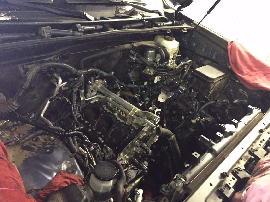

Well still no car. Dealer is still waiting for heads to come back from machine shop. Thought you might want to see a pic of the current state of my baby.
Wow!
That's impressively clean for the state of dis-assembly that it's in but at the same time scary. I sure hope they can get it all back together again!
