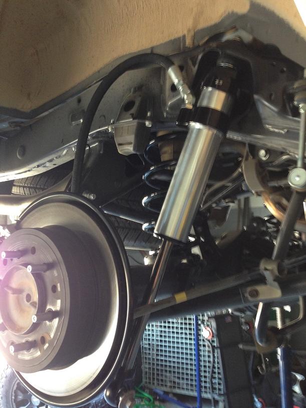

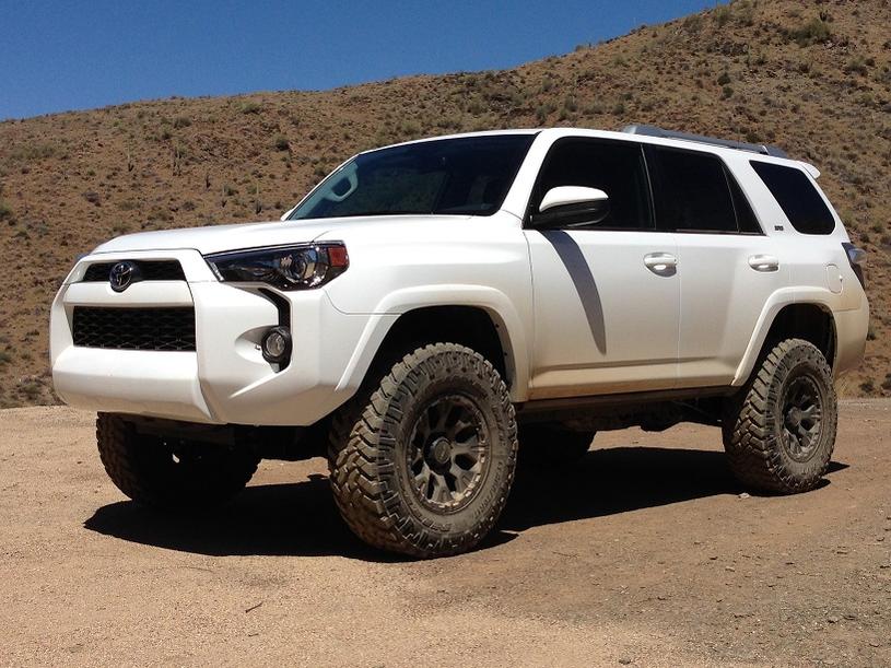

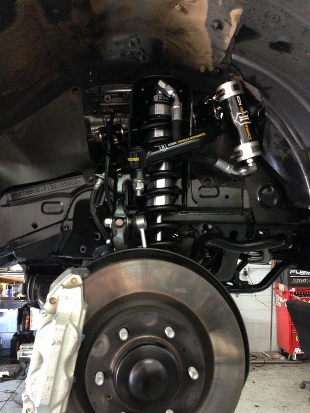

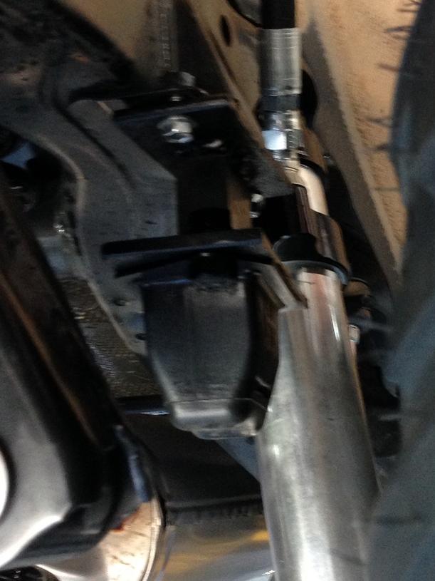

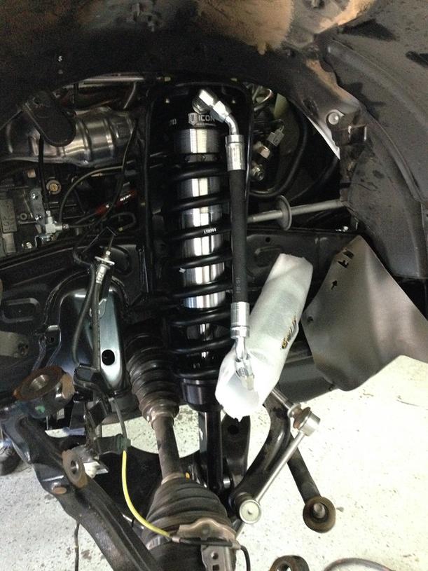

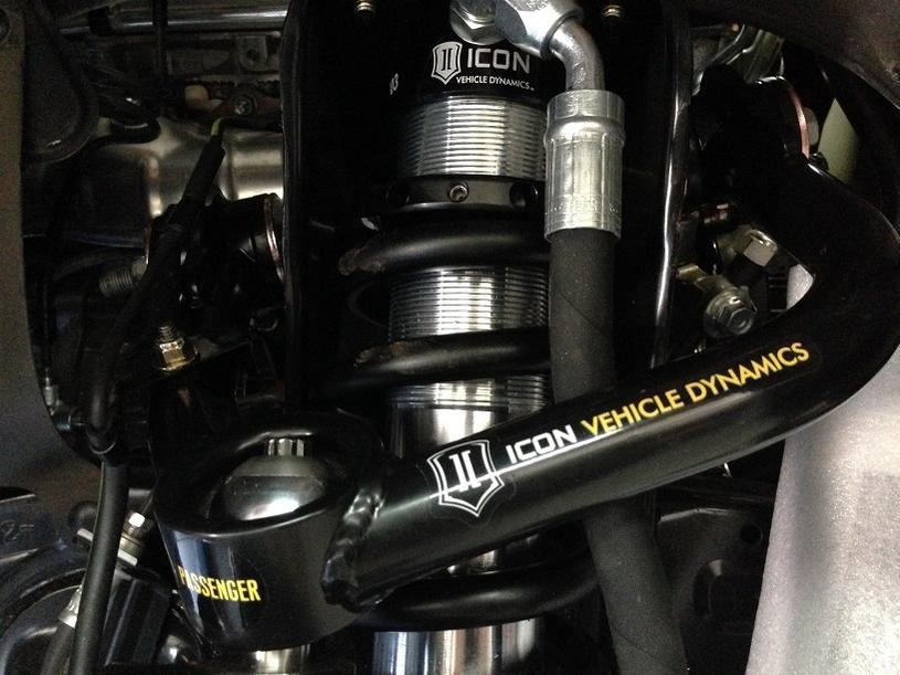

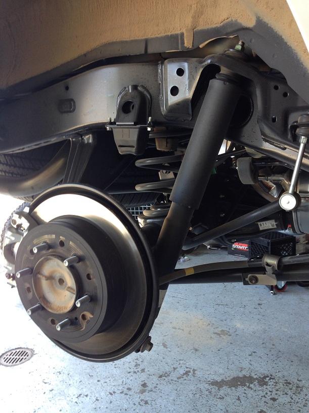

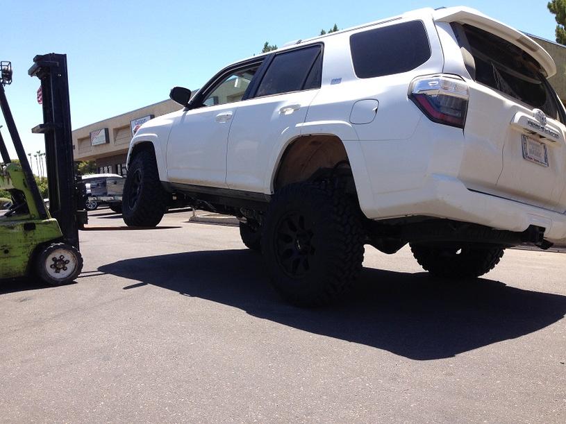

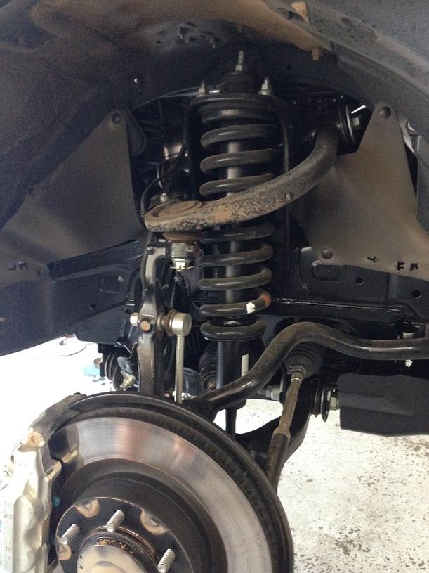

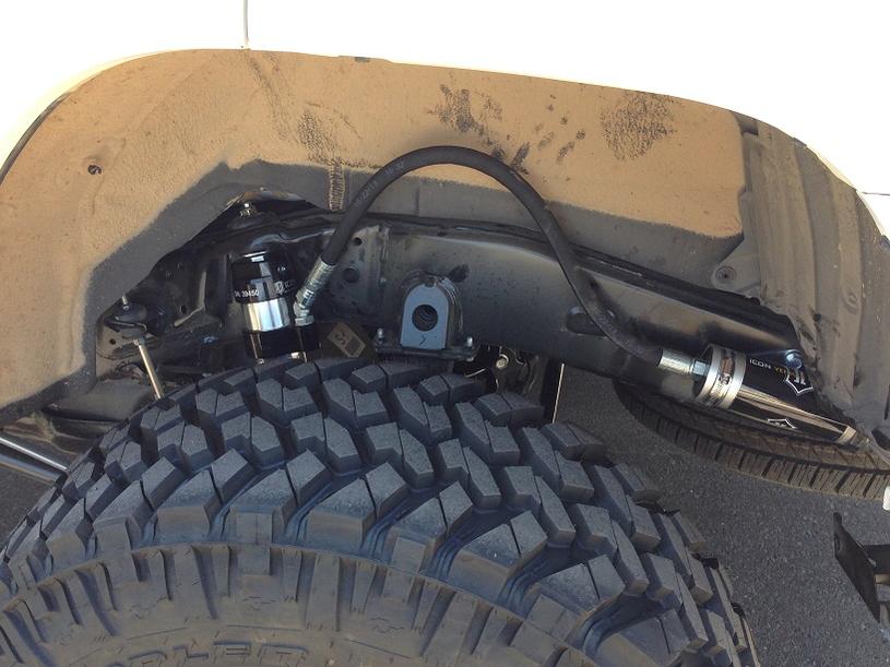

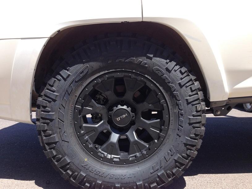

Purchased this guy about a week ago with 4 miles on it. I'm building it mainly as an expedition style nothing too serious or extreme. First step was to put on Icon Overland 3" rear springs with Icon 2.5" Remote Res rear shocks. Up front went with the extended travel 2.5" Remote Res Coilovers. Started with the lower spring rate but was too soft and immediately jumped up to the 700 after a couple days. Running 285/75R17 (34x11.50R17) on 17x9's with 4.5" BS. Rear didn't have any problem at all with rubbing and even at full flex didn't contact anything but just to be on the safe side built 2.25" extended bumpstops. The front I had to do the body mount chop and did a bit of trimming on the rear of the fender well where it bolts to the frame. I still have one small issue with it rubbing on the rear fender well when hitting a dip at high speed but I'm going to look at that tonight and get it figured out and done away with. Took it out over the weekend to the El Camino Del Diablo in southern Arizona. 130 miles offroad with a mixture of sand, rock, whoops, and some technical spots also very scenic. Ran 80mph through the whoops beautifully staying planted and the shocks soaking it up without any body movement.

Looks sharp. Watch your rear remote resi lines though, mine are routed the same way and I have some minor abrading from the tire while at full stuff. A well placed hose clamp will hold it in tight to the body

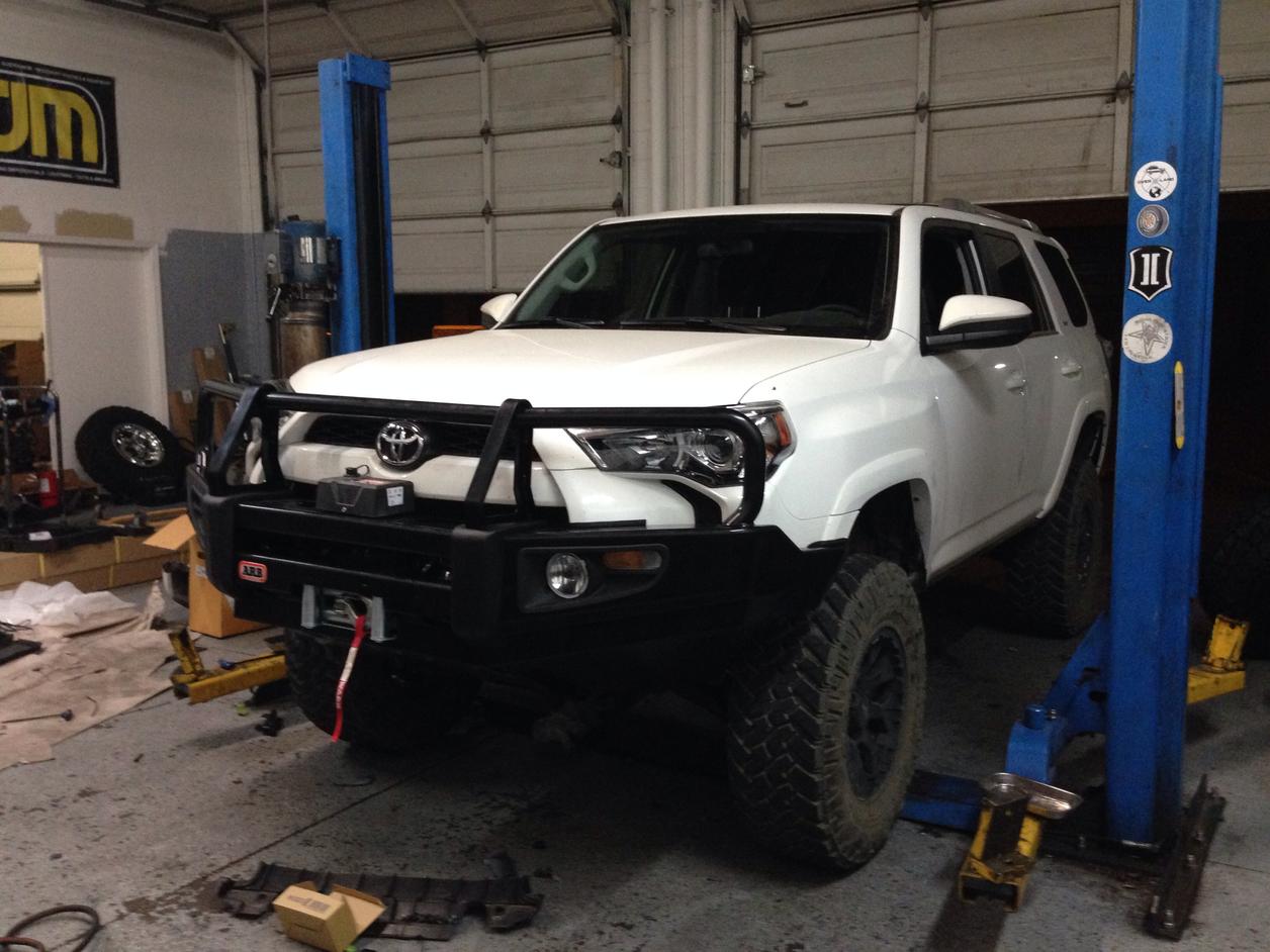

Finished getting the ARB bumper on last night at about midnight. Was a bit of work but it's on and looks damn good! Think it's the first ARB on a 2014 I want to thank ARB for working with me on this. I'm drawing up instructions and dimensions for them. I'll post pics tonight of install and finished installed bumper as I'm driving to Moab right now.

On the road all day but a quick teaser till I can get to my laptop this evening. ARB bumper on a 2014
