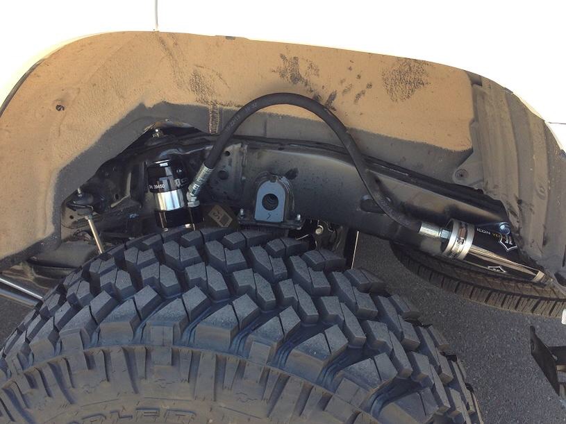

note: i think you may have your rear resis mounted too far forward. there should be an existing threaded hole further back on the frame (there is on the 2010, anyway) and if you mount it back there the line will tuck up more neatly along the outside lower edge of the body. there's a self-tapping retainer clip included in the ICON kit to screw into the sheet metal and hold it securely out of the way.
you may have also found, as i did, that ICON didn't include the right hardware for mounting the reservoirs. i had to co-opt a couple of my skid plate bolts in order to make do.
