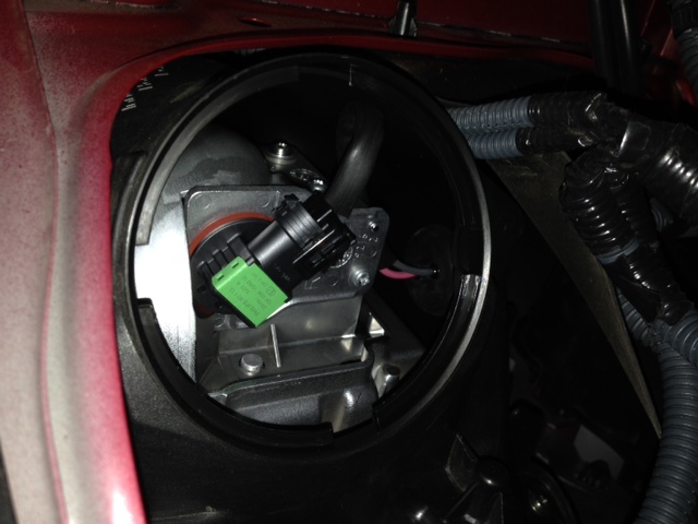

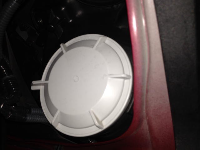

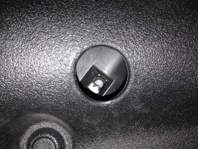

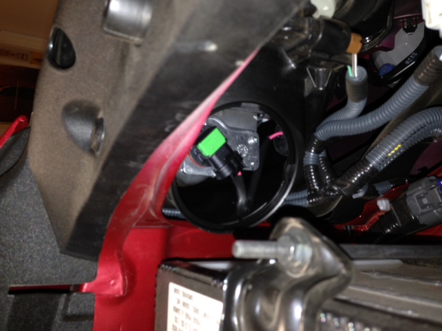

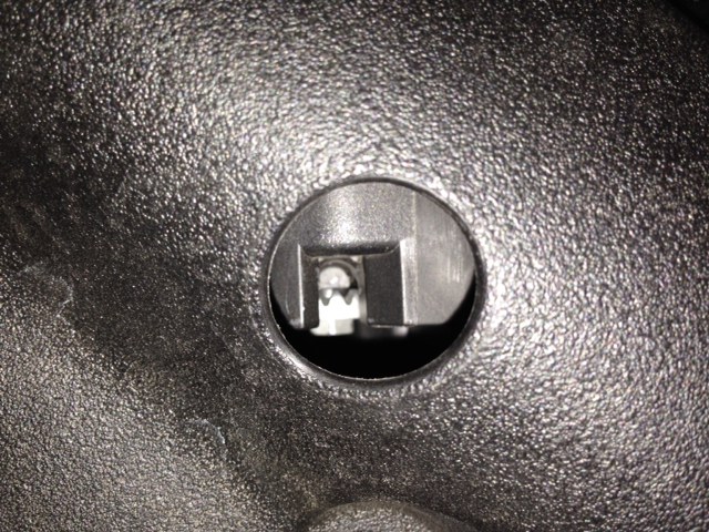

How do you adjust your headlights down on the new 2014 5th gen?
Here are pictures I took. First with the cover on this fancy 'sealed' area.
Second pic is of passenger side.
Third pic is of driver side. IF there is an adjustment, I feel that the battery would have to come out just to be able to get in that tight space.
I recently had the Bilstein 5100's installed set at 1.75. I just wanted to level the truck out. Wow, does it look and ride 110% better.
Thanks for any and all help.......

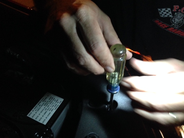

If you look above the headlight area there is a hole in that front plastic engine bay liner. Use a Philips head screw driver. Right is lower, left is higher.
I can see it in your last picture, upper left hand hole of that picture.
Thank you sooooo much!
Sure enough, there they are.......

I did mine a couple weeks ago. You'll want a #2 phillips and you'll want to lean it toward the front of the truck to keep it engaged. Expect to do a lot of cranking. After my 1.75" front lift I had to go down around 6".

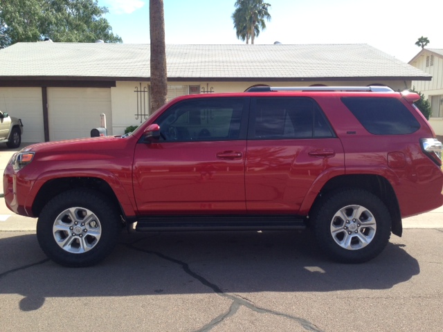

Gigi, do you have a profile view of your rig after the lift? Does it seem level to you or slightly reverse raked?
Here is a pic. I was waiting to post a pic since I have not finished plastidipping my roof rack ends. I need to touch up the one end that I did for practice. It was SO much work, I did not have the right supplies, I ran out of tape...I am going to drape the whole truck in plastic (spend most of my time the first time cleaning the overspray...blah!) and wait for a complete day to devote to doing better job.
Anyway, back to the point.....I do not see a reverse rake. The back is empty (no extra weight) in this picture. I actually think she will be level with a little bit of weight in the back. I have not loaded her down yet to see if she sags with a load of kids and gear. I will cross that bridge when I get to it...... I am happy with how she turned out.
I made the mistake and got the tape measure out. My passenger side measures approx. 5/8" taller than driver side. I searched (haha) and found that this happens and not to get OCD about it.

Rig looks good. I have done plastidip before so I understand it takes longer than you'd think. So, no visible rake but when you drive it, do you feel like it's raked back at all?

I do not feel as though she is raked back at all. I feel bigger and taller even though it is a small amount to level.

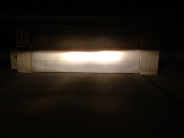

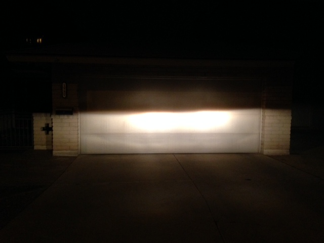

Ok, so we followed all the pointers given by you all, we finally found a Phillips screwdriver that would grab the teeth, we took pictures and we took notes....
Parked 4R in our driveway, thought it was fairly level, but pictures say not so much. Hopefully it is our old driveway that is out of whack and the truck is not leaning that bad.
Pics hopefully tell the story. There is a row of block on the house that is different than the rest of the block, use it as a reference point.
We turned the screwdriver a total of 15 complete revolutions and we estimate that the lights lowered 6". At 10 turns, we estimated it to be at 4" lower (no picture) and then we turned it another 5 and stopped.

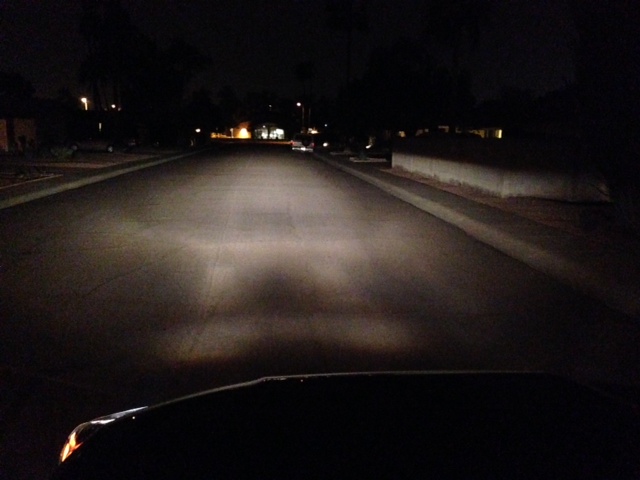

I then drove down the road and back and confirmed there was no blinding effect going on. We did not do this before we started so we really did not have anything to gauge it against.
Last picture represents what I think is good projection of lights on street.

"Counting turns" is not going to be the same from vehicle to vehicle. The adjustment is there because of tolerance build up during manufacture, NOT because the engineers knew some wahoo will change the rake of the vehicle lol. Same for tire alignment. No two are the same so they put adjustments there for critical alignment (headlamp and tires) to get uniformity that cannot happen during assembly.
Remember that one guy might have had 15 turns and another guy only had 5! Best idea is to measure the headlights before lift yourself. At night, find a wall and go back 20-25 ft as the distance won't matter as long as you know what it is. Measure this distance from center of wheel on ground to wall. Then measure up on wall the top of the headlight line that is the sharpest. Take a pic so you know where you are measuring. After lift go through the same measurement from the same distance at the same wall using the same method and you will be fine. Counting turns is the lazy man's way that is not accurate. Measurements before and after is the right way.

The 15 turns or so GiGi refers to sounds about right. I read in another thread in here that the goal is about 2 1/2" below the marked level line at 25' I measured my light's center height, then marked the same height on the wall with tape. I was almost 4" high at 25'. After adjustment I think mine might be a little lower than GiGi's pictured on the street, but as 1engineer pointed out a lot of that is objective observation. I did not measure before doing the lift because frankly, it just did not cross my mind until I was driving home on the interstate after picking the truck up. I honestly didn't believe that mild a suspension change would make that drastic a change in headlight orientation, but my high beams were for all intents and purposes useless because the low beams were so high.
