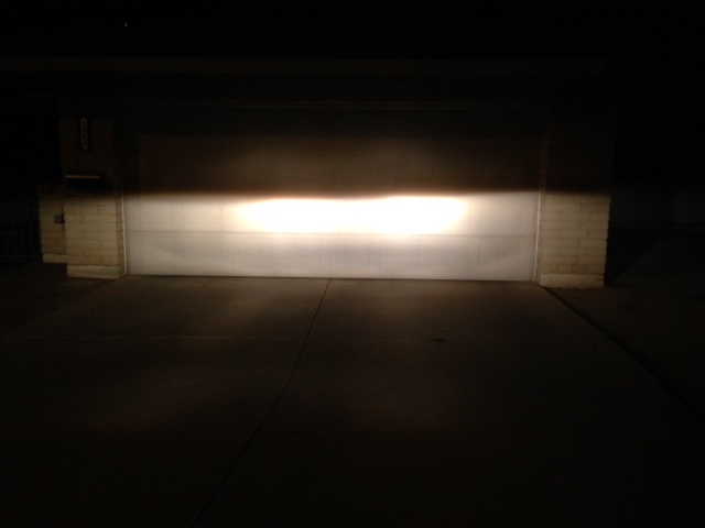

Parked 4R in our driveway, thought it was fairly level, but pictures say not so much. Hopefully it is our old driveway that is out of whack and the truck is not leaning that bad.
Pics hopefully tell the story. There is a row of block on the house that is different than the rest of the block, use it as a reference point.
We turned the screwdriver a total of 15 complete revolutions and we estimate that the lights lowered 6". At 10 turns, we estimated it to be at 4" lower (no picture) and then we turned it another 5 and stopped.
I then drove down the road and back and confirmed there was no blinding effect going on. We did not do this before we started so we really did not have anything to gauge it against.
Last picture represents what I think is good projection of lights on street.
And as they say, if Mama is happy, then everyone is happy! Done.
Thanks for all the pointers. Hope to help the next soul that comes along and reads this thread. Next, will work on popping those caps off and plastidipping them. :)
Thanks for the pics, the projectors have a nice and clean cut off line.
May I ask you something...do you see the bit of "glare" directly above the cutoff (right around the center of your garage door)? Is that actual glare or just light reflecting upwards from the ground? I've never been able to see a clean beam pattern shot on these OEM projectors and am very curious if they have built-in "squirrel spotters" to light up overhead road signs :)

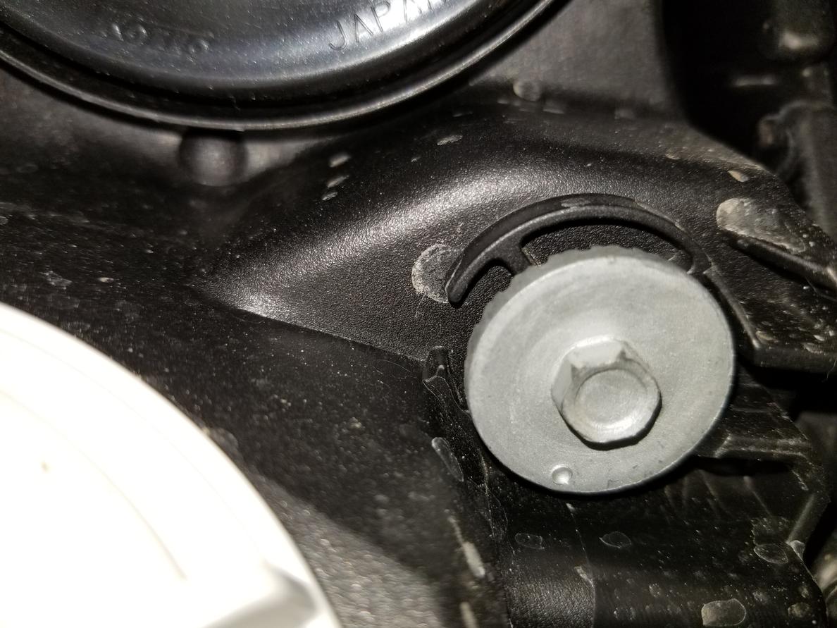

I realize this thread is old and this is probably one of the simplest things you can do with your vehicle, but i found a better way to adjust the headlight level.
Instead of using a #2 Philips (mine wasnt catching constantly and i didnt want to mash/grind anything down took ugly), I used my phone to look at the assembly that you'd be turning with the Phillips bit and it's all one piece.
I used a sharpie to mark the initial position of the adjustment. Then, i used a socket wrench with a 8mm socket at the back of the adjustment thing to turn the adjustment and just counted the number of teeth as it revolved.
Way easier and nicer to count/keep consistent/adjust.

Which direction did you move the adjustment to make it go down?
Doh! Now that i've had a chance to look at it i realize how simple your solution is. Thanks for the alternative.
