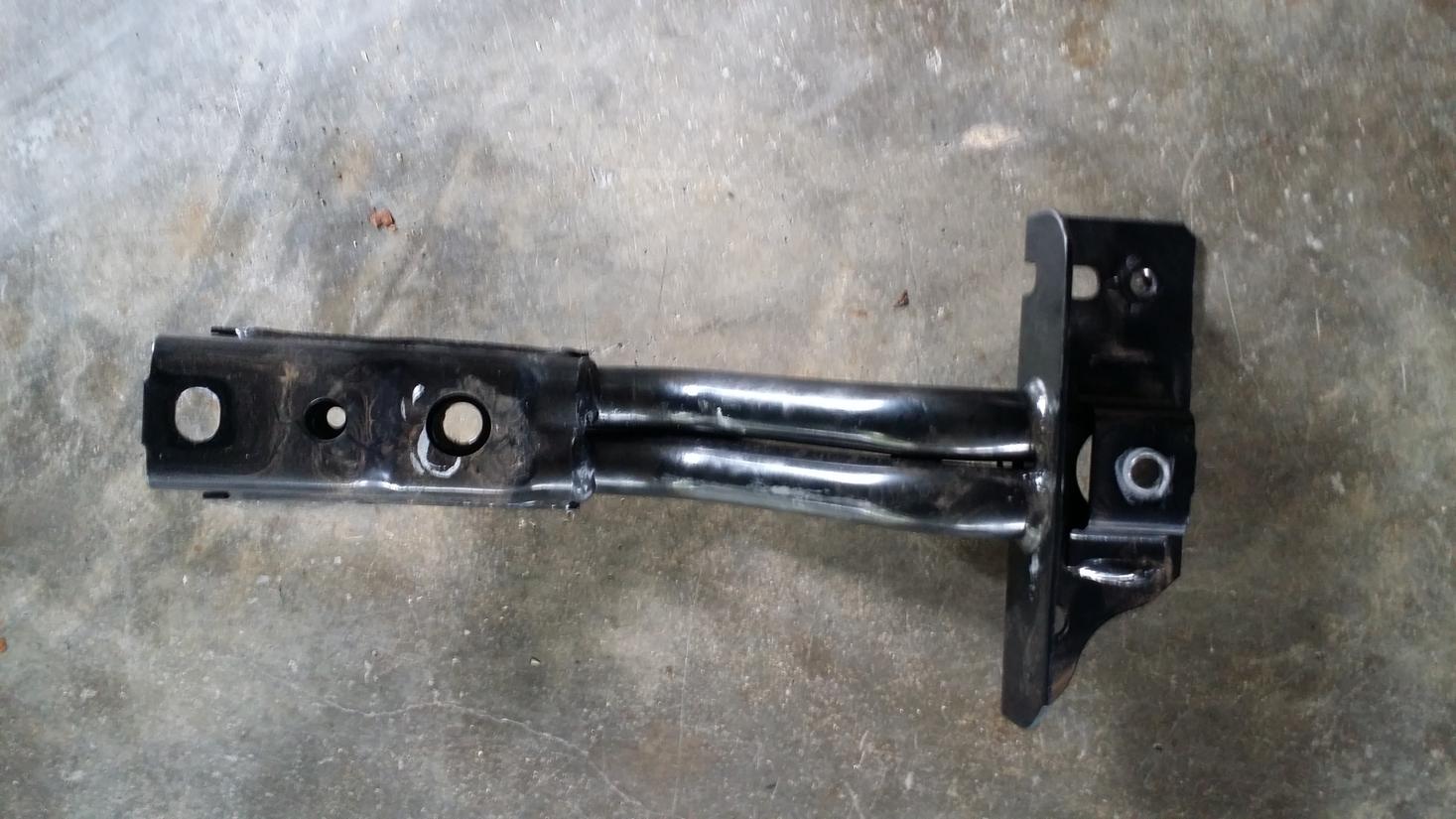

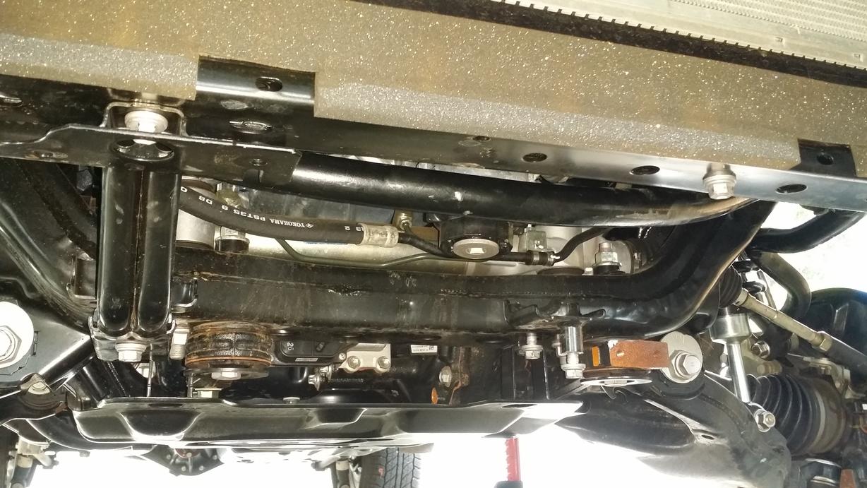

I just installed my boss kit but when using the sway bar spacer to move it foward, it hits the bracket. Any fix or ideas to put the bracket back without rubbing?
I know you have Toytec, but I know that Icon supplies thick (I think 3/8" maybe?) washers that space these brackets down to clear the re-located sway bar. You could go that route, or even smarter--- just get 2-4 washers of the same thickness and put them in between the bracket and frame when you mount the bracket back up.
Or--- just ditch your sway bar altogether.
thanks swimmerdude. spacers was hiding in the box... will post pics in a few days of my full build. thanks
