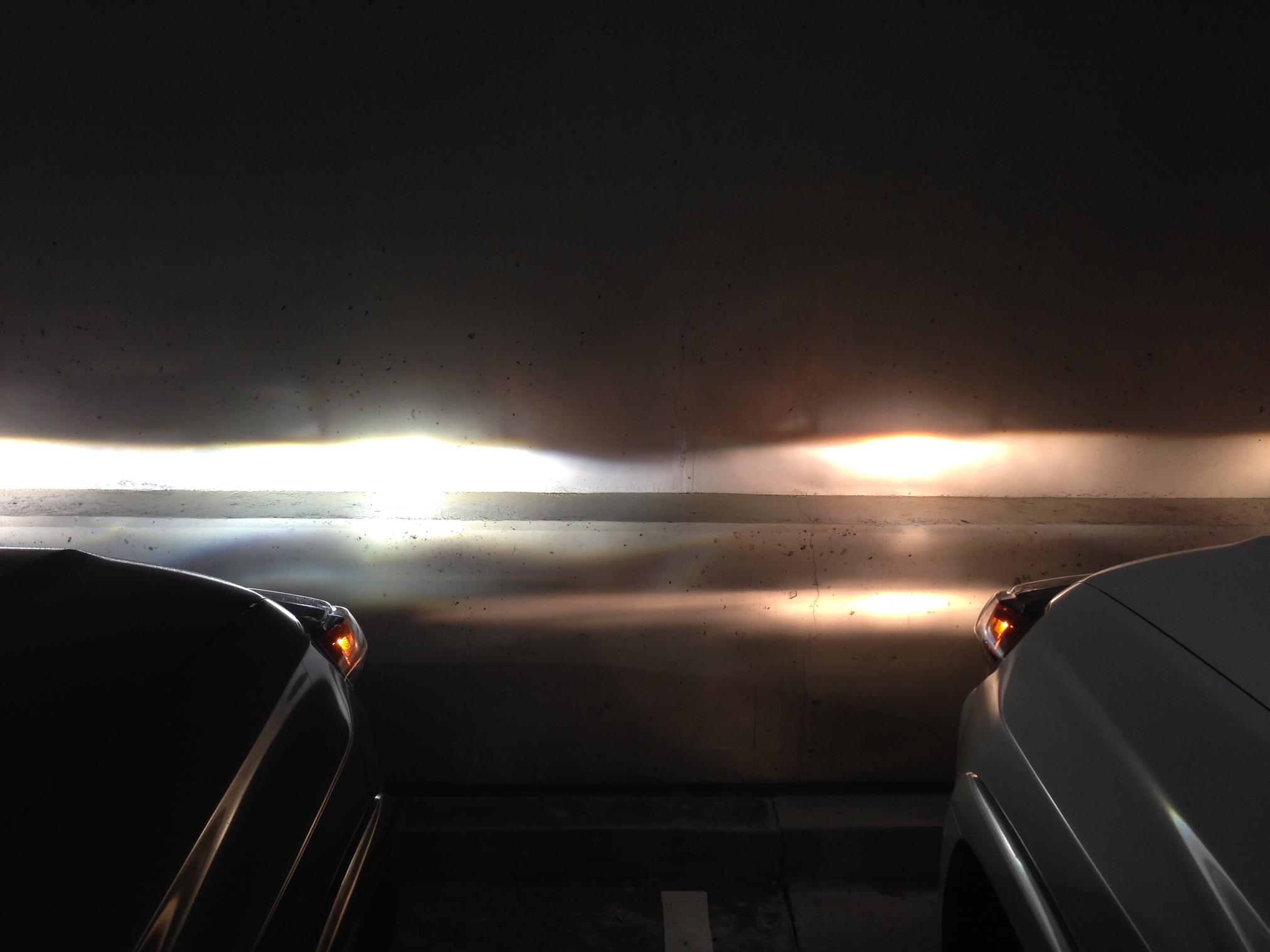

I met up with BTLAW tonight to see what the light output of the TRS pnp kit vs. the stock output. My understanding is that BTLAW (left) uses a 35w bulb @ 4300 Kelvin with the Denso ballast. Pretty dramatic difference...
