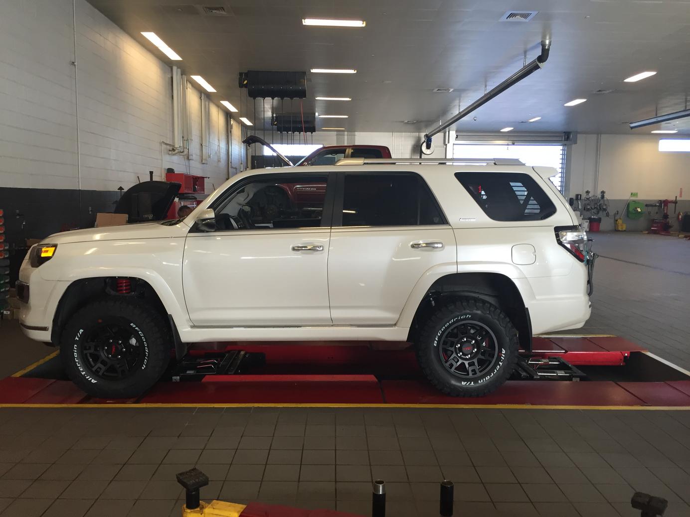

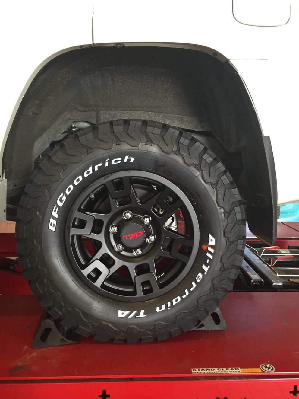

I have a 2014 Limited as well and initially started with a mild build. In my opinion there are lots of options out there, but the best one I found was to delete the XREAS suspension off the vehicle and replace it with Bilstien 5100 shocks all the way around. I then added an adjustable coil over in the front and the Superflex HD rear spring. These will probably be overkill for you if you aren't planning on adding bumpers in the future. I would call ToyTec and speak with them about what you want to do and they can build or recommend a kit for you. My goal was to add about 3 inches of lift to my truck and then replace the wheels and get some better rubber. If you add a 17 inch wheel and get a good AT tire, you can get away with a 32 inch tire, but you may have just a little rubbing in the wheel well. There are lots of options and this is just the way I went with my build. There are also lots of resources on this forum and even videos about builds. Good luck.
2014 Limited
Meant to add this to my post above, here you go.

really like your set up here. curious with the lift was any mpg lost? or was it so nominal its not worth mentioning.
Hey Floridaflyguy, I did see a slight loss in MPG with the change in tires. I don't believe that the lift changed the MPG, but switch from stock tires to KO2s did cause me to Lose a few MPG.
