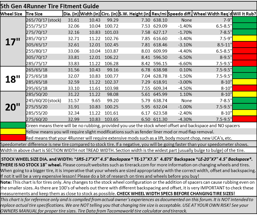

I've got the same size wheels on my limited (20x9 +18offset) and no spacers. I like the stance. Tires should have been 275/55-R20 to better match the factory diameter. Some useful info...
285/70 R17 on 17x8, 4.5in backspace and 0mm offset. No wheel spacers needed.
Just know...combining thicker wheel spacers with larger tires increases the likelihood of requiring a body mount chop due tire hitting.
