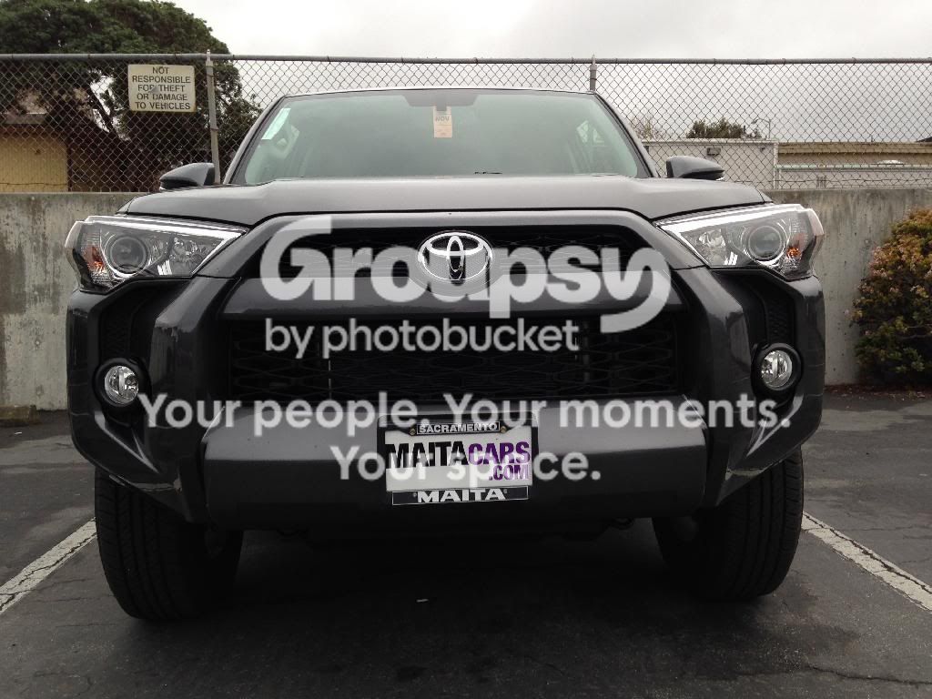

I didn't really like how the front plate looked. I was inspired by others' solutions to the problem. Here's my fix.

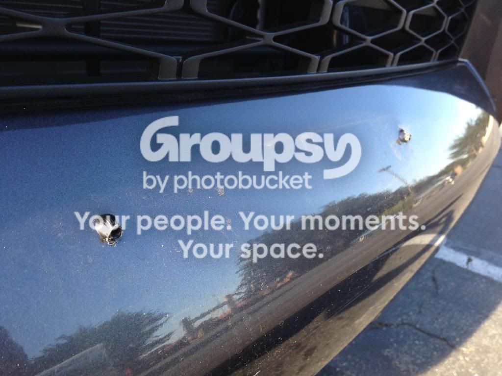

California state law requires a front license plate, so dealers are obligated to attach one prior to sale. If you can get to the dealer before they destroy your bumper, you won't be left with this after you remove the front plate mount:

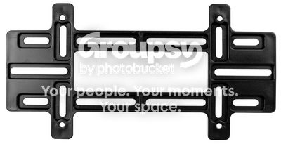

Here's what you'll need:
I found this at my local O'Reilly Auto Parts. It is "Custom Accessories" brand model # 92651 and I think it cost all of 5 or 6 bucks. You could use any license bracket that is similar, but this model fits into the gap under the Toyota emblem PERFECTLY. "Almost like it was made to go there" kind of perfect.

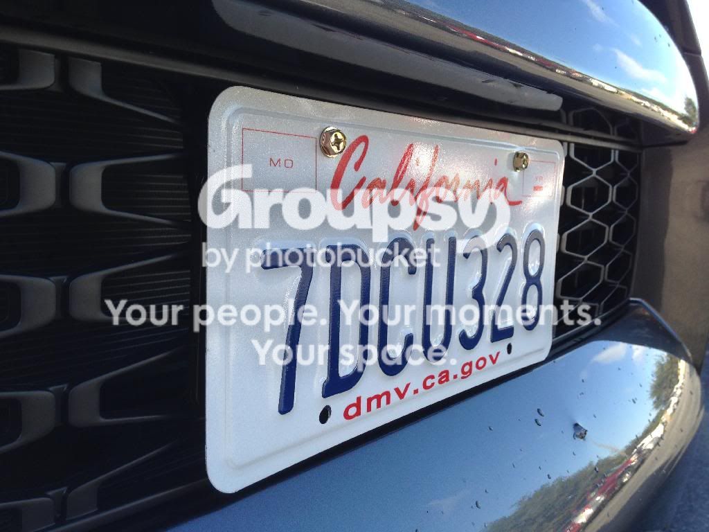

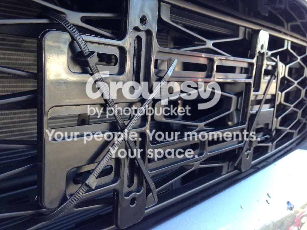

Next, lace 4 zip ties through the outer corners of the plate bracket. Tighten each one little by little as you go around, making sure it is centered. You'll be left with something like this.
I know, I know.... Zip ties aren't always my favorite, but in this case they are ideal. The bracket is super snug and there is no permanent damage. I can remove it later and leave no scars.
Be careful that the 4 holes for the plate itself don't line up with the plastic grill behind. You want the screws to be able to pass through. The rectangular hole pattern didn't give me any problems.

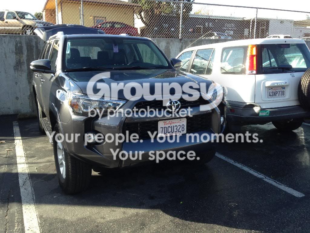

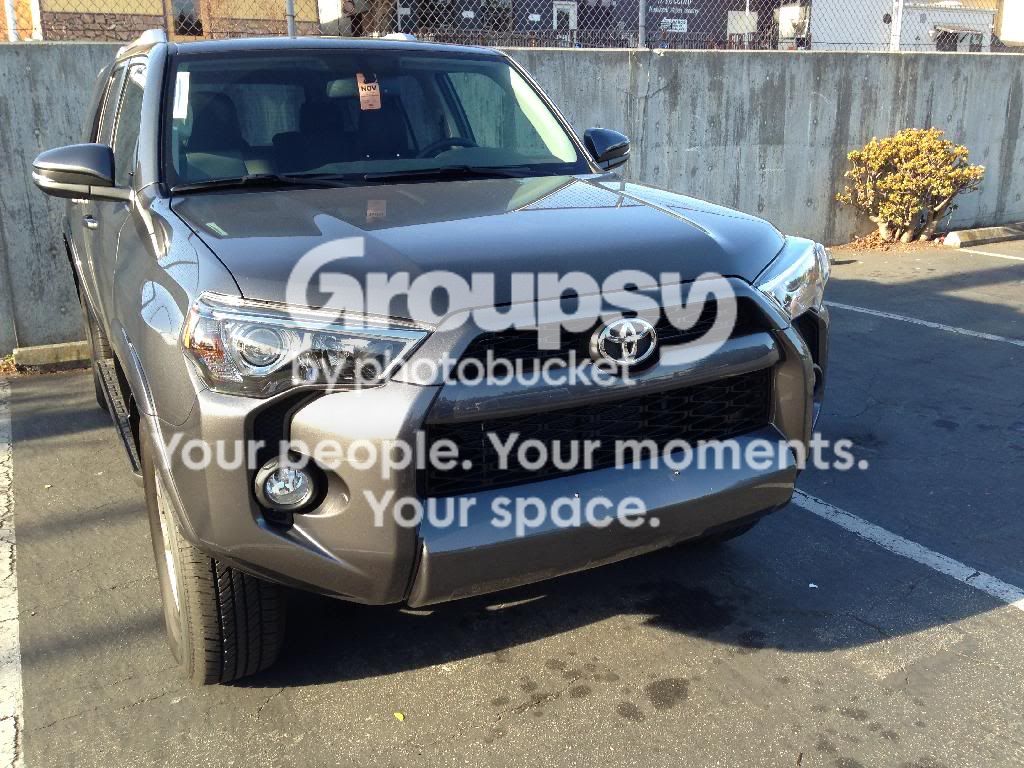

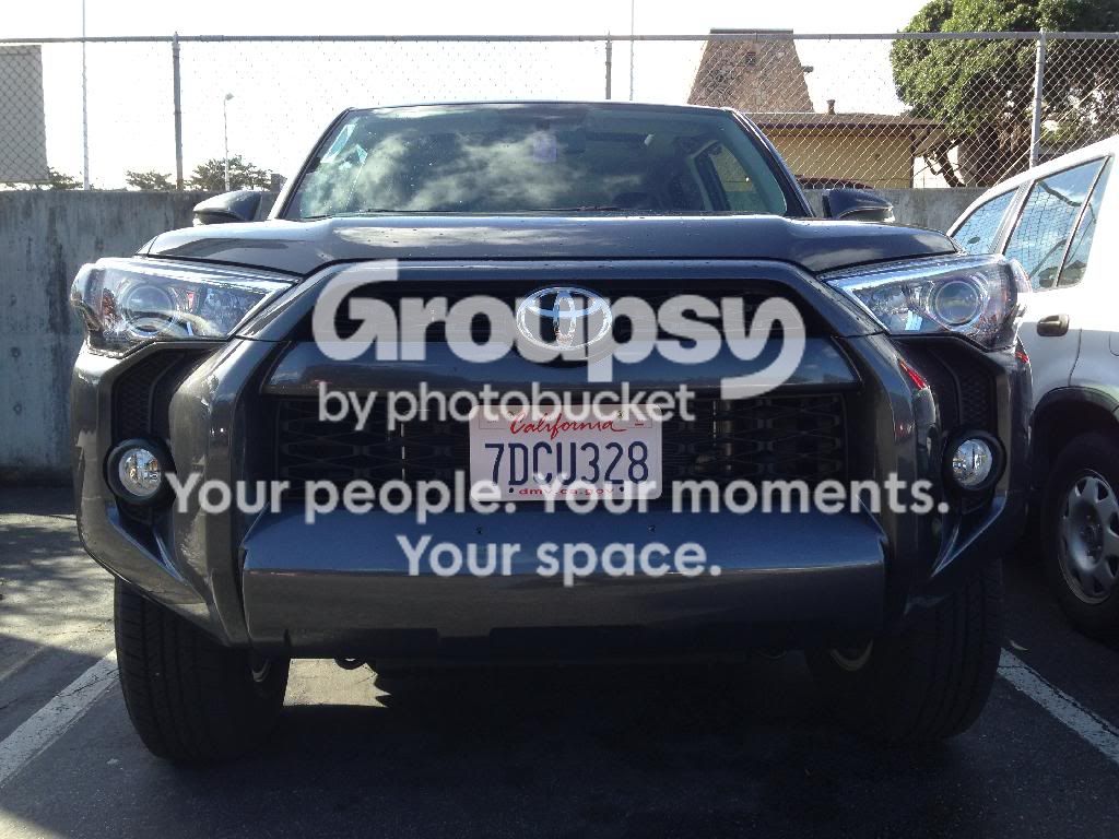

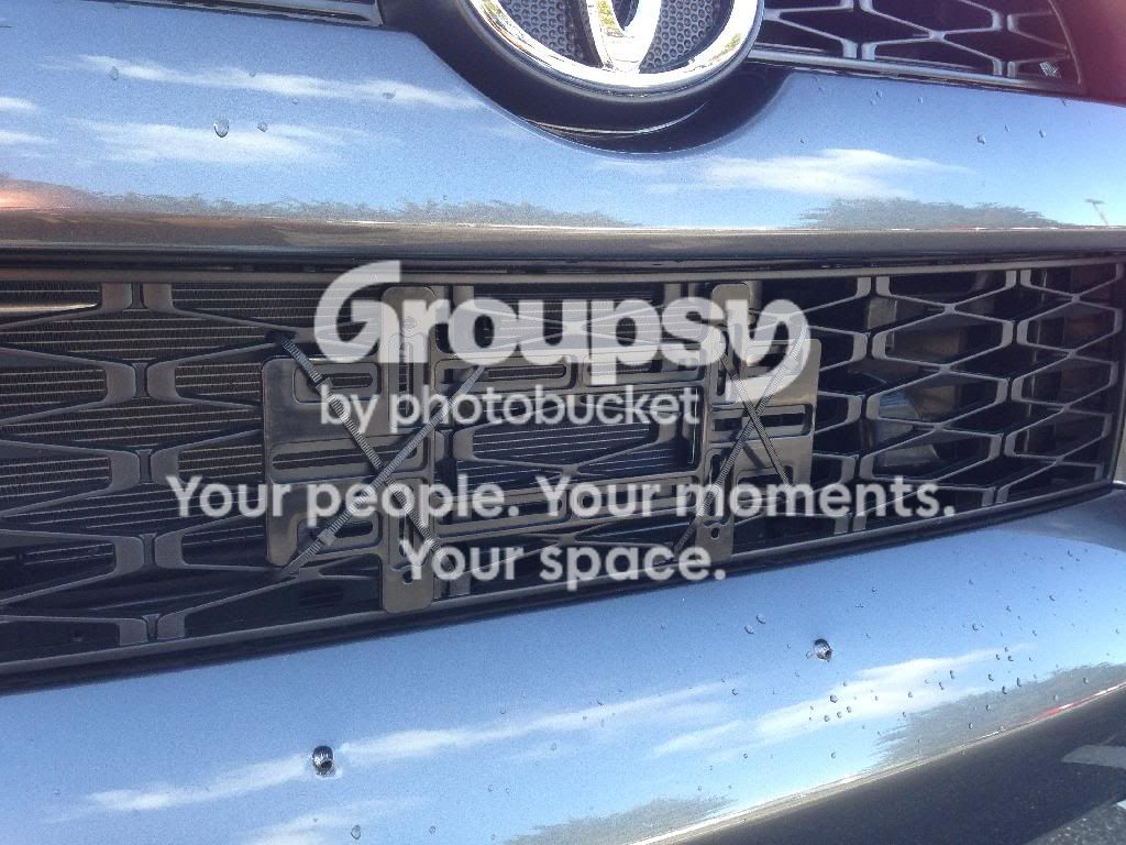

Before and after pics:
It fits in there very well. I think I got a clean result.
Maybe I'll put a frame around it. Don't know yet.
I plan on using something like this to plug the existing holes in the bumper, after I flatten those nasty pimples down. LOL.

Additionally, after I get the raised bump part to flatten out, I'm thinking I'll need a wider flange to cover the hole and any surrounding unsightliness. I'm sure those plugs are great if you just have a hole to fill on a vertical bumper surface. Unfortunately, that's not the case with my bumper.
I didn't have a very good result with BumperPlugs because of the way the drilled holes bubble up - I couldn't get the plugs flush with the bumper. I actually broke one of the plugs trying to reposition it & had to order a second set.

Exactly. Maybe a heat gun or grinder to shave down the bubbled up-ness. Unless there is another way someone could suggest. :noidea:

I don't really have any concerns about cooling. There is lots of room around the plate for air to flow and the plate sits a good distance from the face of the radiator. Plus, the electric fan makes it a non-issue.

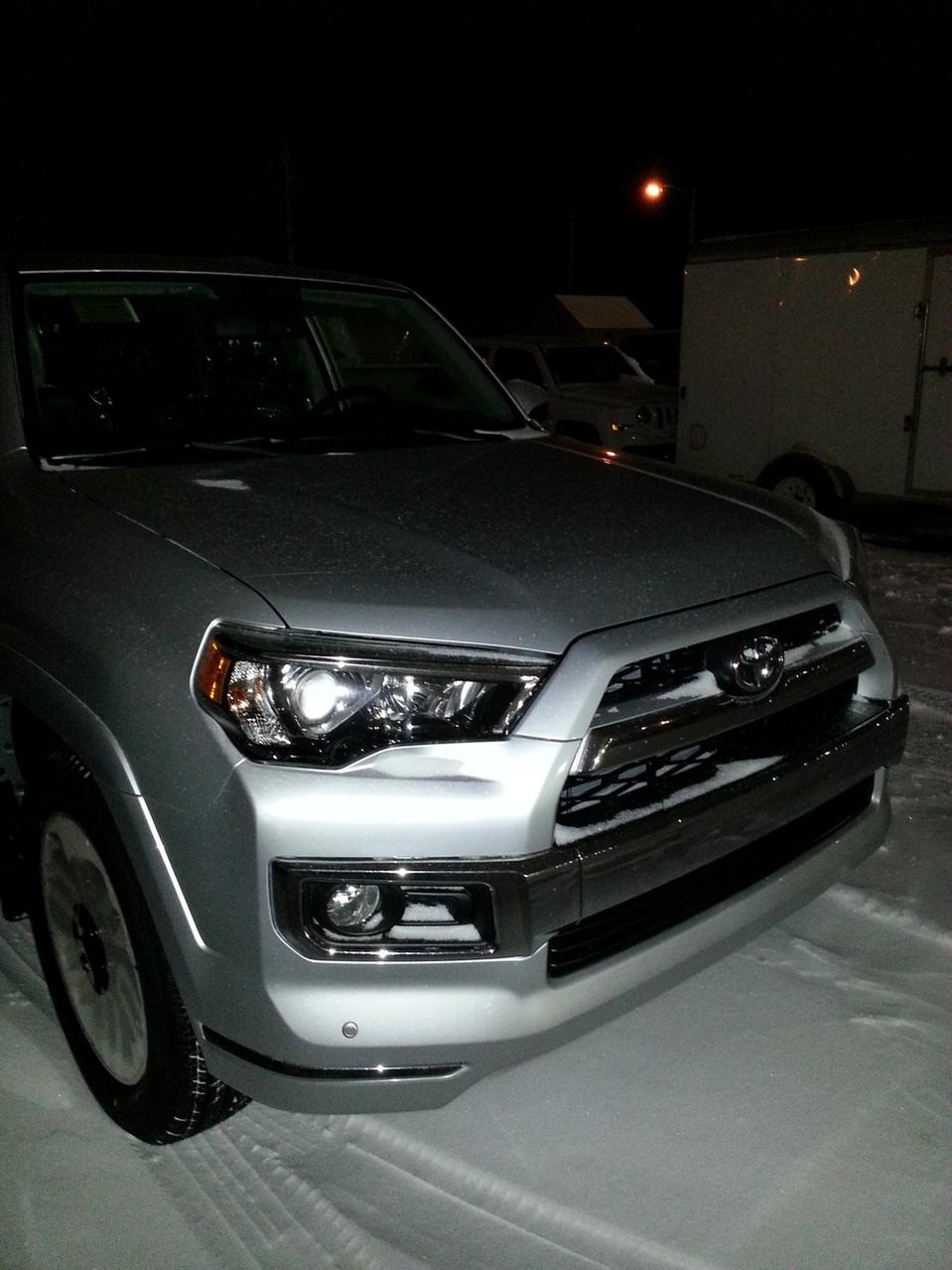

So, just to clarify; that license plate holder is screwed on by the dealer?
It's not factory or port-installed?

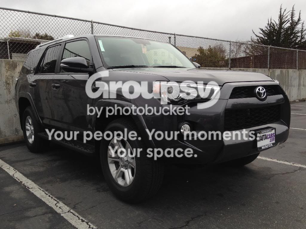

no its not. evidence, a few hours after it was taken off the truck at the dealer sitting in the back lot waiting to be PDI the next day. unfortunately the suggested placement doenst work on the LE since the location isn't big enough to mount a plate without hitting bodywork that would rub.

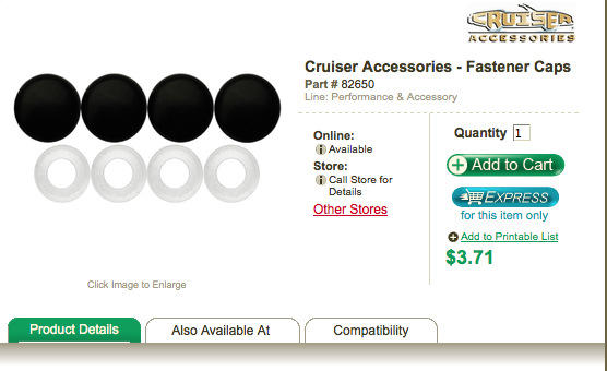

Just go to your local Auto Parts store and get some of these-

Be advised that most zip-ties will get brittle with age and will eventually crack and fail. Heat, cold and direct sunlight (UV) will degrade them too. I'd check them after a year or so.
not sure if this will work, how about just using the original license plate bolts but paint the bolts the same color as your 4runner - it looks like black -give the bumper a faintly 'industrial' look. maybe even add a small black molding or chrome strip held by the original license plate bolts.
