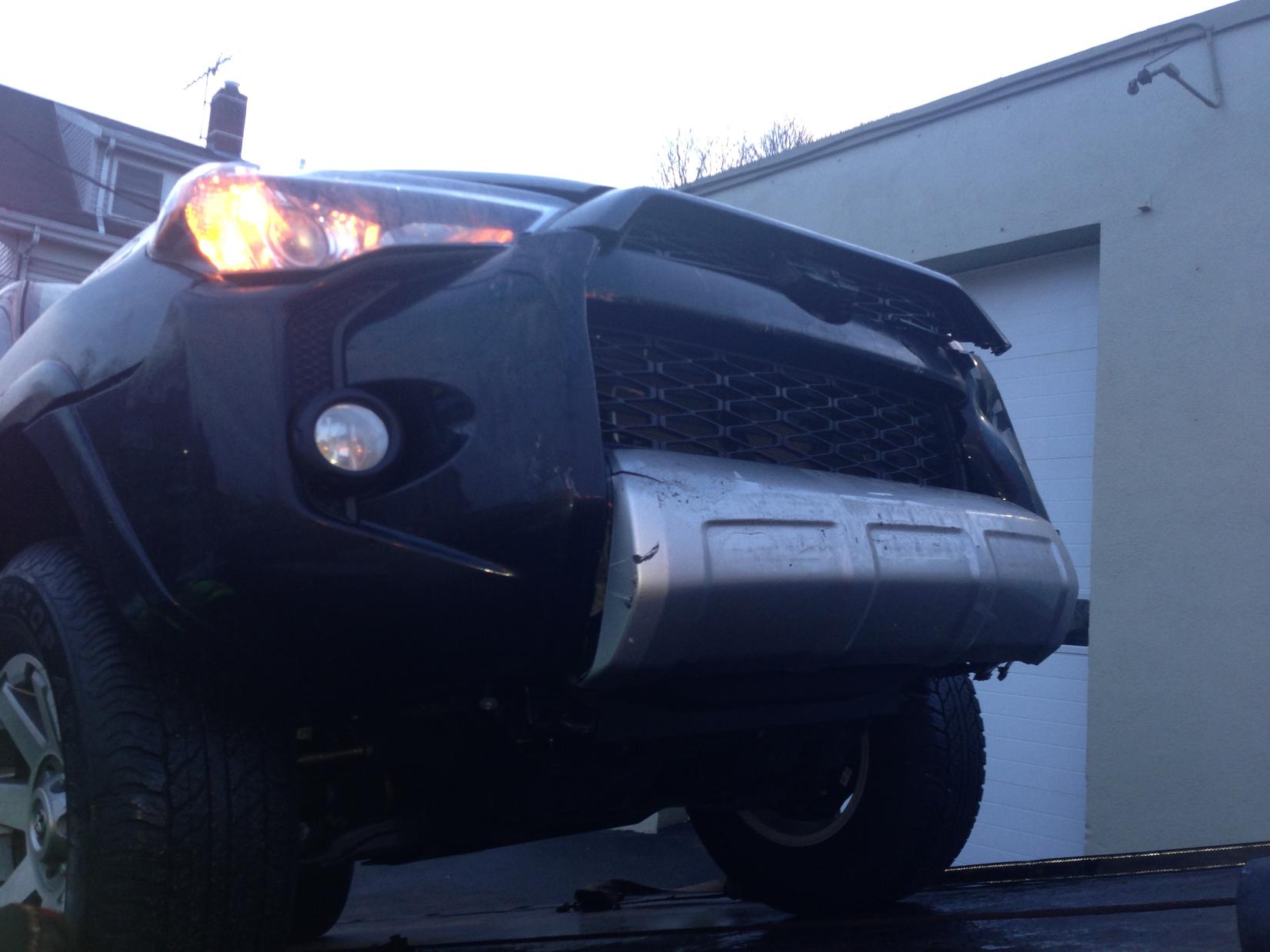

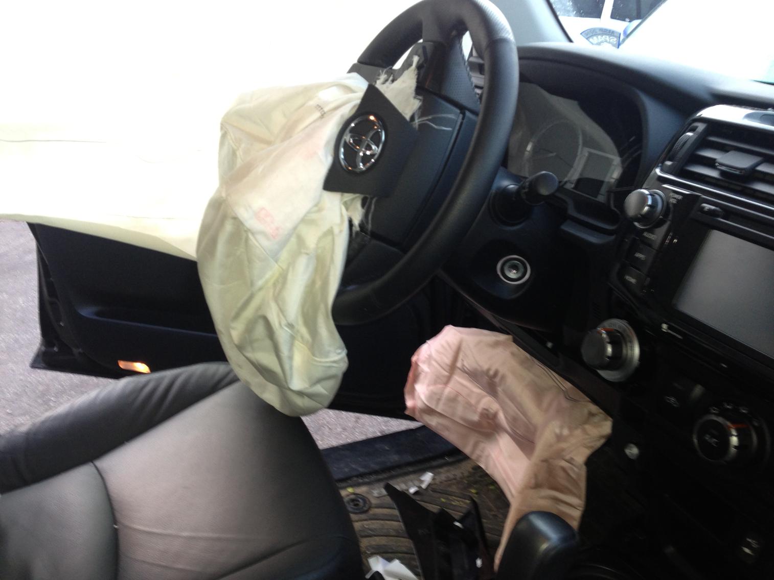

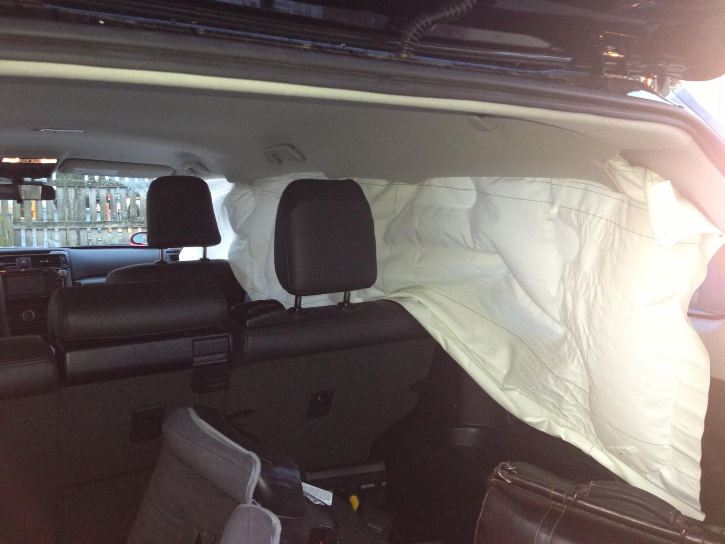

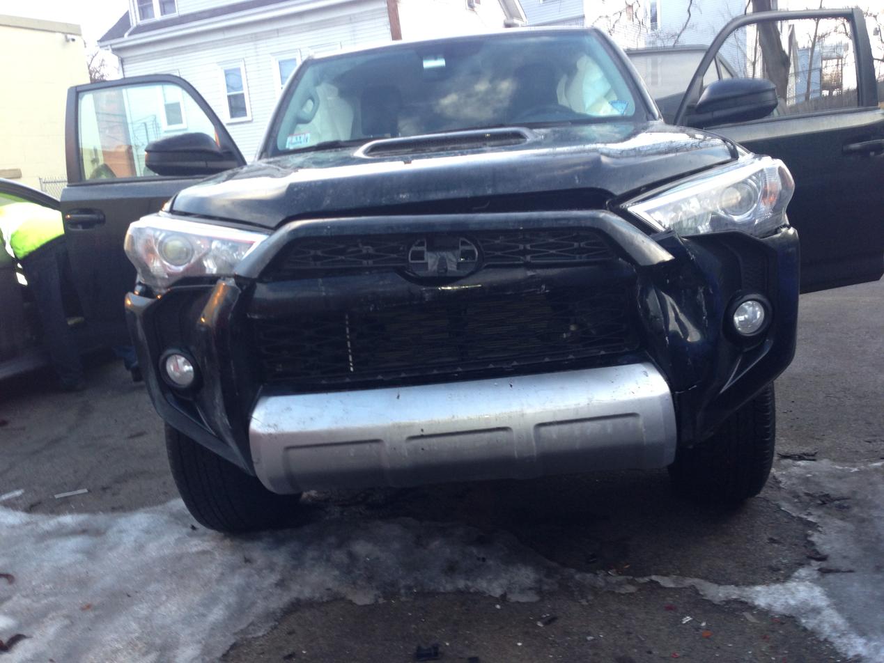

Front damage honestly doesn't look too bad from the pictures. Side curtain bag is typically deployed if yaw sensors detect certain rate of side roll or spin that could indicate potential roll or passenger sideward movement. Better a curtain airbag than a body or head against the interior. If vehicle in back went under you possible sensors detected upward movement of the truck and thought you were spinning or rolling.
All deployed airbags will have to be replaced, all sensors designated with those components so all front sensors and all side sensors on the side of deployment, usually clock spring in steering wheel, seatbelt and pretensioner on side of deployment airbag modules, pillar trim and headliner, seat cover if seat bags deployed, etc. each manufacturer has requirements of what has to be replaced. Good chance of hidden damage but may not be enough to make up another $10k.
I've got to figure out how to keep the airbags inflated. I could go camping, roll the truck on it's side & have a comfy place to sleep! In all seriousness though, cosmetically, I'm rather surprised at the lack of damage to the front. I'll be interested to see the hidden damage list. Still glad you're ok.
