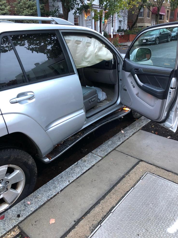

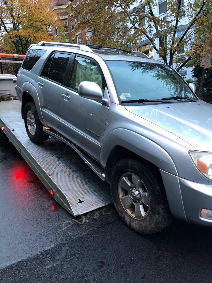

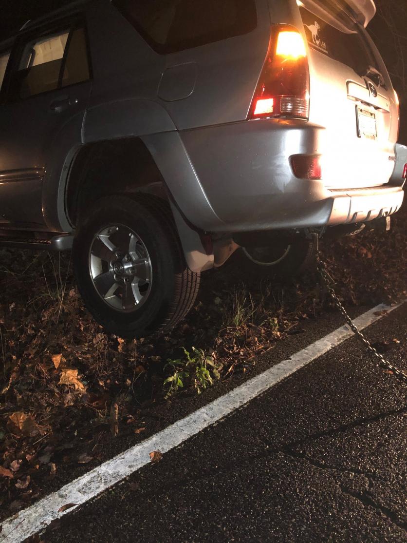

Ugh... so my vsc/trac control system had been off for awhile recently (seeing warning lights) and i ended up sliding off the road around a turn when my rear tires spun after i barely hit the gas shortly after it rained. Fortunately, it seems like the only damage was to my side running board, however both side curtain airbags deployed and of course both the front seat belt pretensioners blew. I've checked for frame damage but there is none.
Don't want to let my insurance adjuster look at it because they'll almost assuredly total it. Would rather fix things myself or possibly through a body shop if I can get it done at a reasonable price.
Can't seem to find instructions for doing this anywhere online. Can anybody help me figure out the procedure and what i'll need to do and buy? Any thoughts or suggestions on this would be greatly appreciated. Trying to save my Truck instead of having to spend tons of $$$ on a new one during tough economic times. Love her and she runs great!
