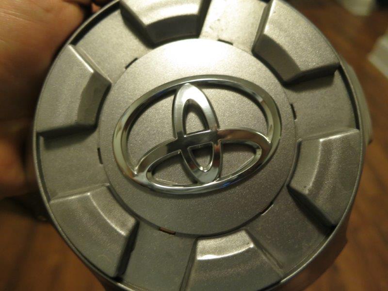

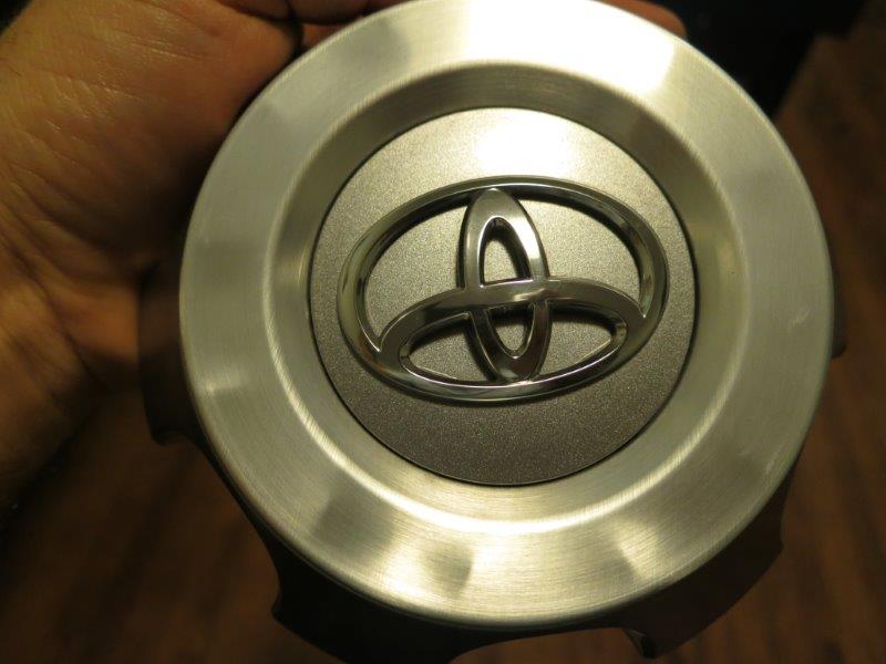

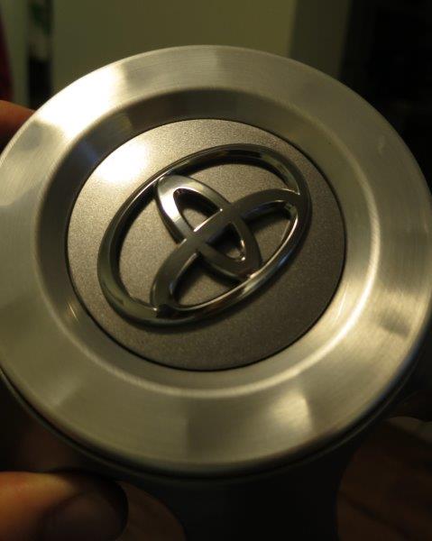

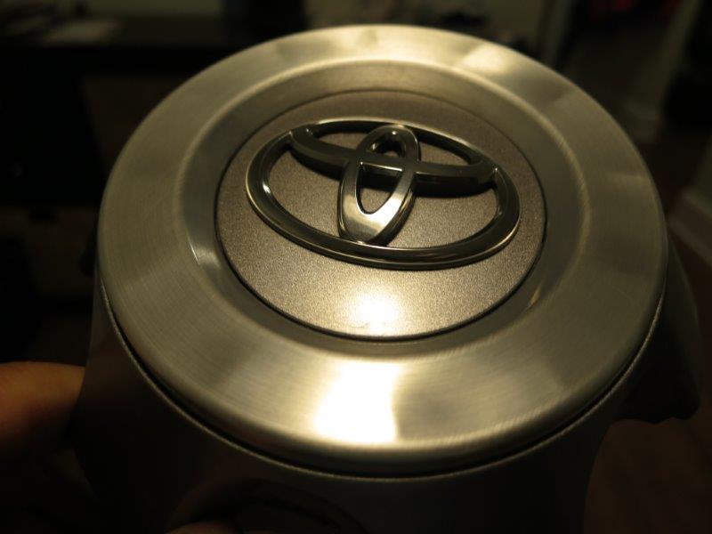

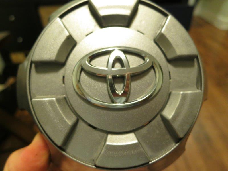

Check out the pics. Please let me know if your 2014 Trail edition Wheel cap rings are doing the same. PLEASE

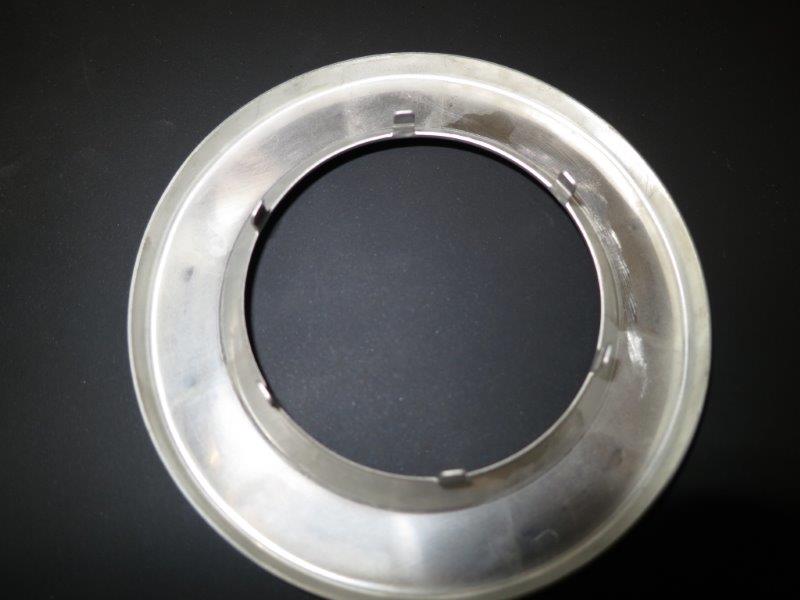

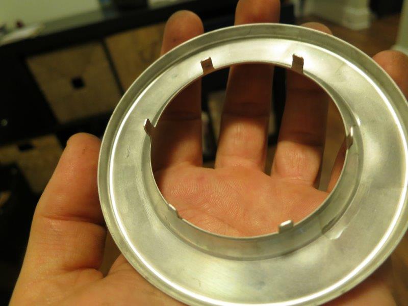

So my brand new 2014 trail edition has 3000 miles on it, and I noticed dents forming on the thin aluminium rings around the wheel caps. My dealer said someone was vandalizing the vehicle, but I could not see how or when since it was in secure parking all the time, in a building of elderly people, and there are no other marks ANYWHERE on the truck or wheels. So toyota warranty will not apply. They never even took them off to look at the other side.
So I was furious, and took them off the wheels to discover the tabs that attach the metal rings to the uneven plastic backing where not tight, causing the rings to rattle against the plastic.. I also noticed that the dents are exactly the same shape of the plastic below, which is not continuous, but ridged.
I don't know if the rattling did this, or the touchless car wash I always use. If it is the car wash, it would be because the metal ring is so thin and flimsy sitting against an uneven surface. Either way I am very disappointed that Toyota will not stand behind a very inferior product. Two dealers refused to entertain the idea that this is a cheap product that is not well designed.
If toyota is serious about listening to feedback, they sure are not showing it. The attitude at service is "no way would toyota produce something inferior" guess what, they did.
If anyone else has a 2014 Trail edition, please let me know if you are also getting denting on these rings. All 4 of mine are showing the same. If i can prove a pattern, they may at least redesign them so they will not dent.
