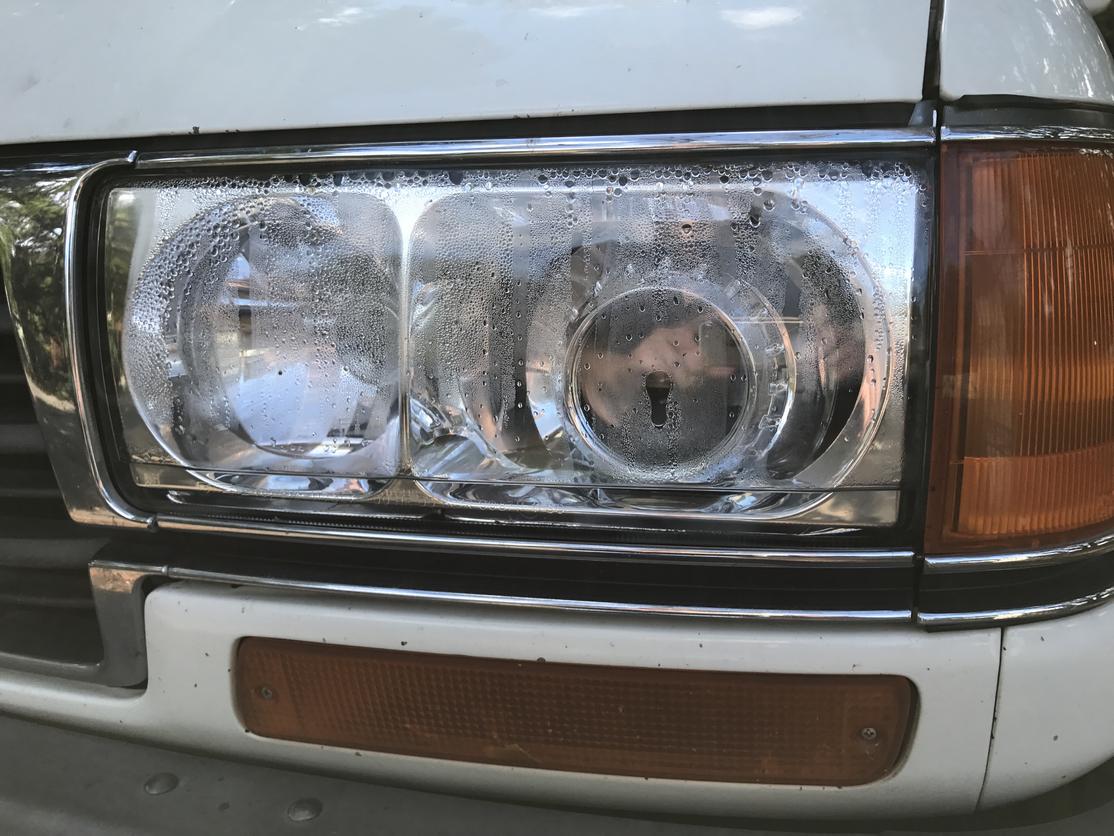

Let me tell you about headlight condensation..

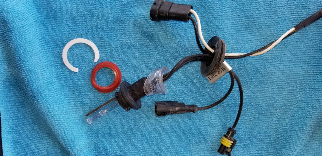

did your bulbs not have an o-ring when you installed them? everything should be sealed up.

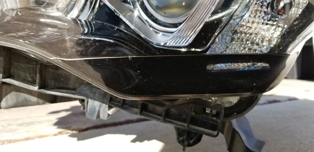

I installed a HID kit 2 years ago. Last week I noticed some condensation on my left headlight. Today I removed it and noticed this.
I didn't see any cracks or bad seals except the HID grommet was a little warped and the washer was brittle and fell apart. I can't figure how so much water got into it.
