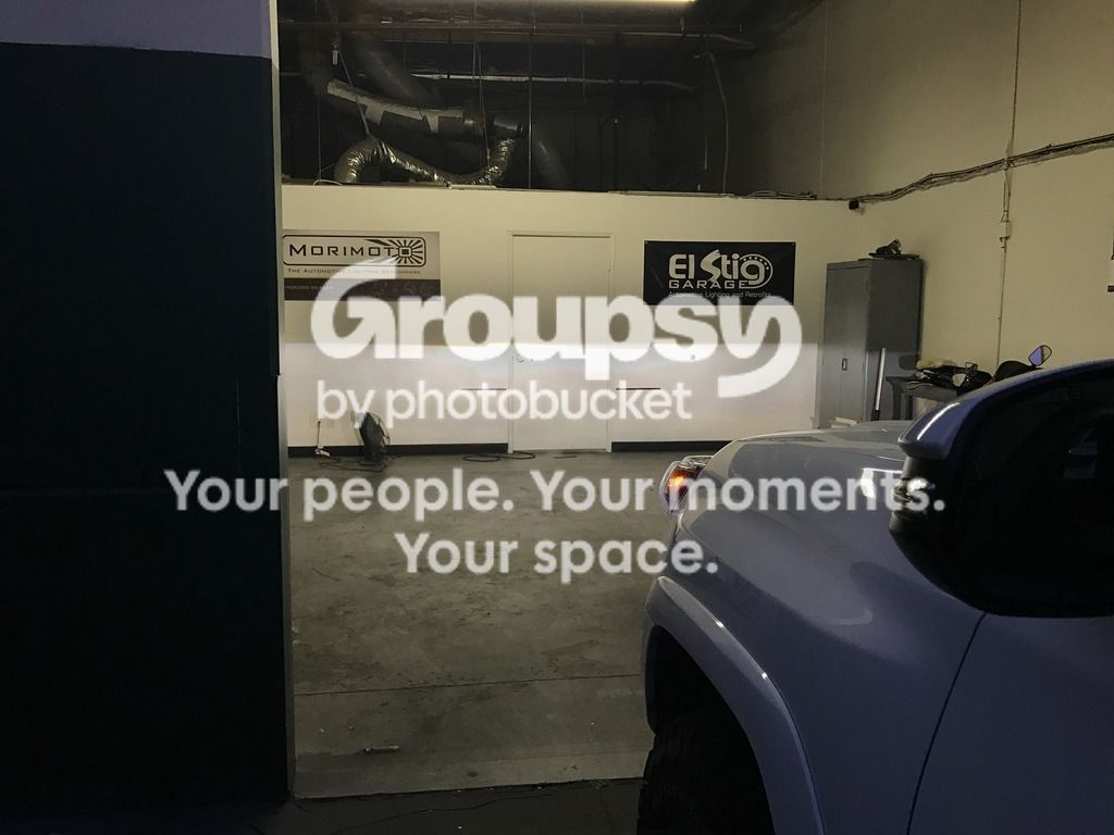

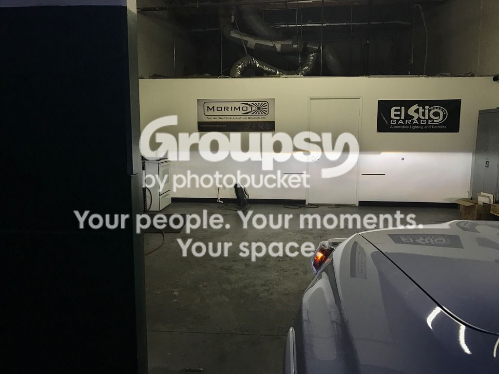

Here are photos of my cutoff. Exact same retrofit using IS350 projectors, clear lens upgrade and tuning.
Morimoto 35w ballast with Osram nightbreaker bulbs. Will be replacing bulb and ballast with 45w hylux and Osram CBI's soon for more output :)

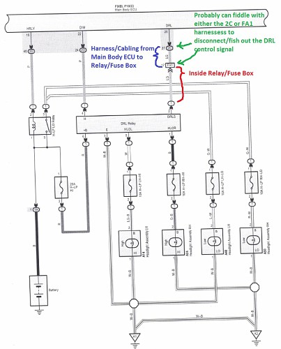

This is what I've found and what I plan on doing. This came from [MENTION=119516]jicko[/MENTION]
"In my post above (there is the diagram), if you disconnect the DRL signal(anywhere along the line, from pin37 of 2C or the LG/LightGreen wire inside the harness or pin17 of FA1 or the LG/LightGreen wire inside the Relay/Fuse Box/underneath the relays&fuses) from the Main ECU to the DRL Relay, you isolated the DRL from the high beam.
Now, you can take that DRL signal, and use it to drive something else..... probably should thru a relay tho.
I hoped that it is clear enough?"
Sorry it's so small. (that's what she said)
Trying to put in a drl on off switch. Is connector 2C the one at the bottom left side kick panel facing backwards? I spotted a light green wire there but not sure, there are a couple more light green wires around.
