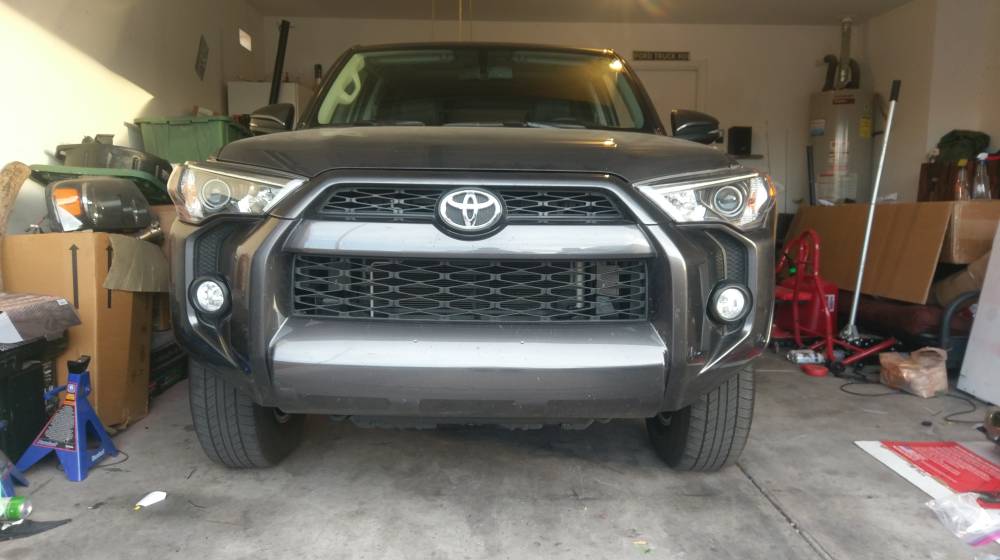

These were TYC headlamps. I didn't want her to not have a vehicle to drive for 3+ weeks so I just went ahead and bought spares. I'm going to sell the old ones. They're basically brand new looking.
Sent from my HTC 10 using Tapatalk
The best part about this retrofit is the stealth look that doesn't draw attention until you need lights!

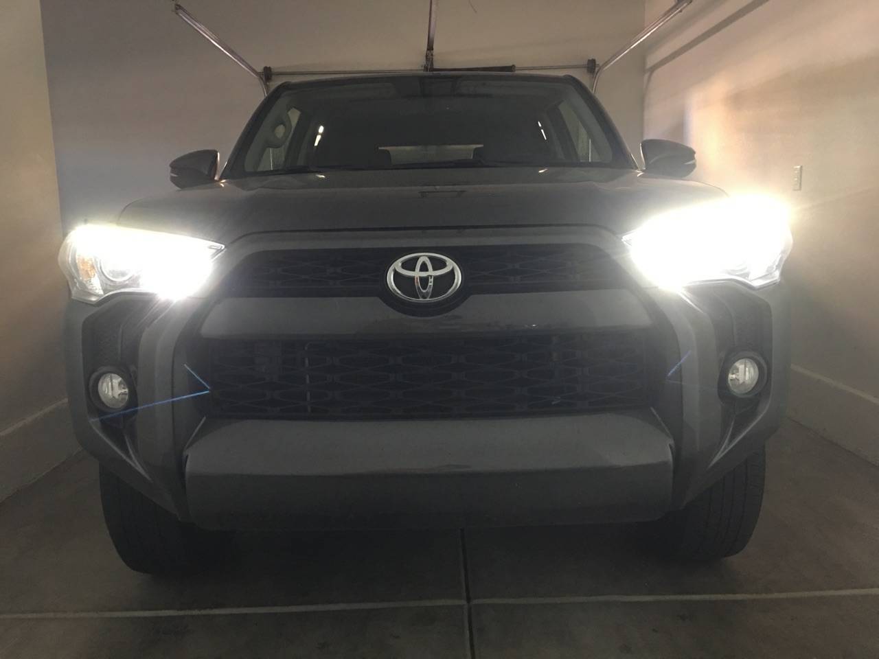

All done!!!! These things impress the SH*T out of me! I mean, they're better than my mini H1's and my D2S 3.0's.

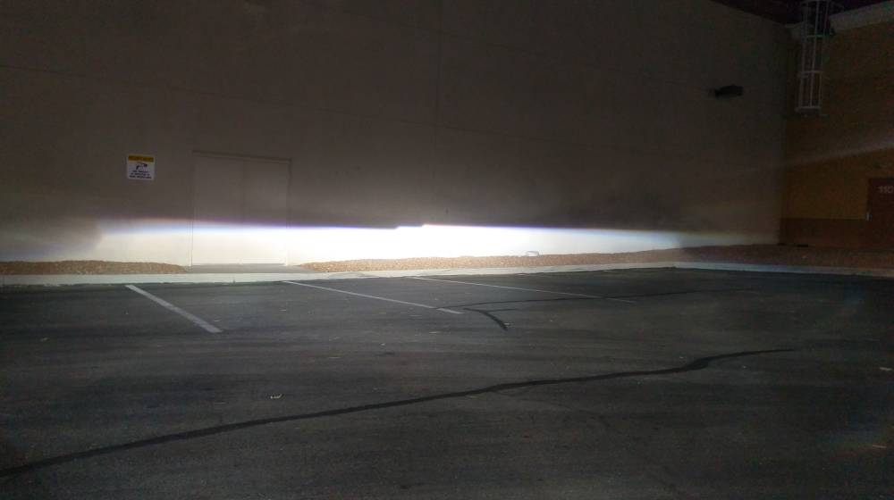

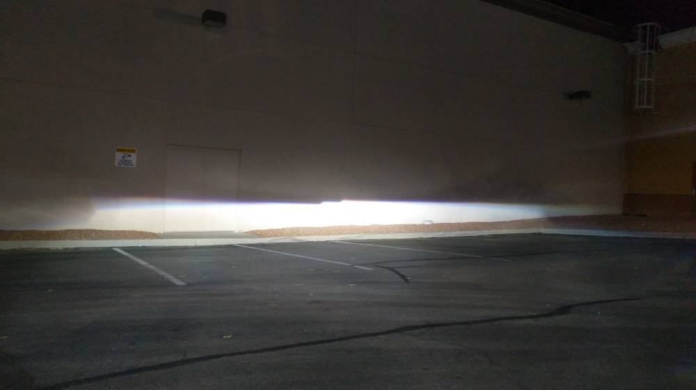

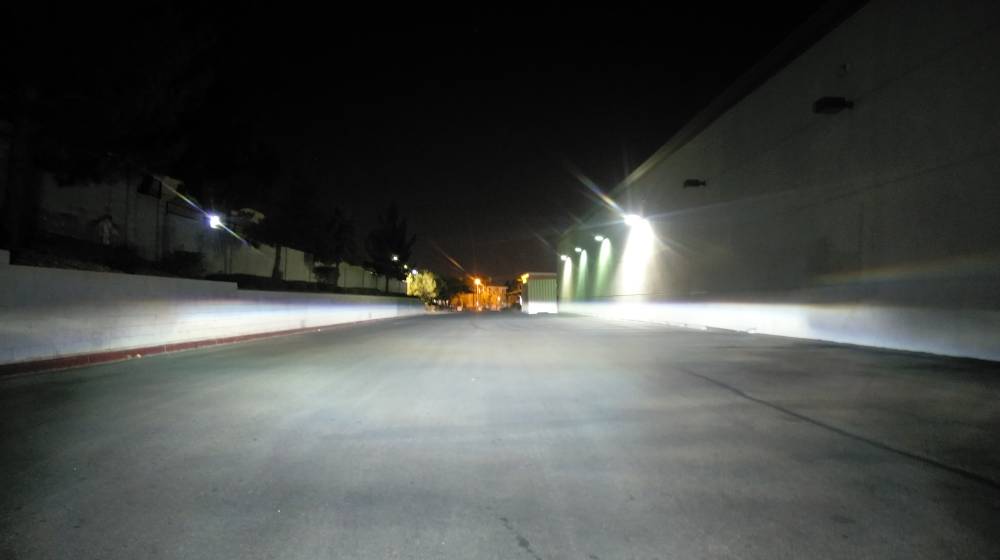

I did make a slight mistake upon installation but I kind of like the outcome. I installed washers in order to point the projectors inward because I thought they were pointing outwards. If any of that makes sense. So in some pictures it looks like the projectors are not aligned and some that looks like there is only one on. This is not true they're both working properly. I may break them back open and remove the washer from the projectors. I'm not sure.
I hope you guys like them! She loves them.

Very nice work, you really have patience. I agree that you've misaimed them inward. Your steps should look like this ...
___/ ___/
.... but more importantly, you've given up a bit of beam width. One of the great benefits of proper HID projectors is the improved spread.
Whether that's worth a do-over? ......

Good points but if it doesn't bother her then I'm not gonna break them apart. But if I drive it too often it'll bother me and I'll break them apart. It wouldn't take long. I'd just have to be careful with the glue.

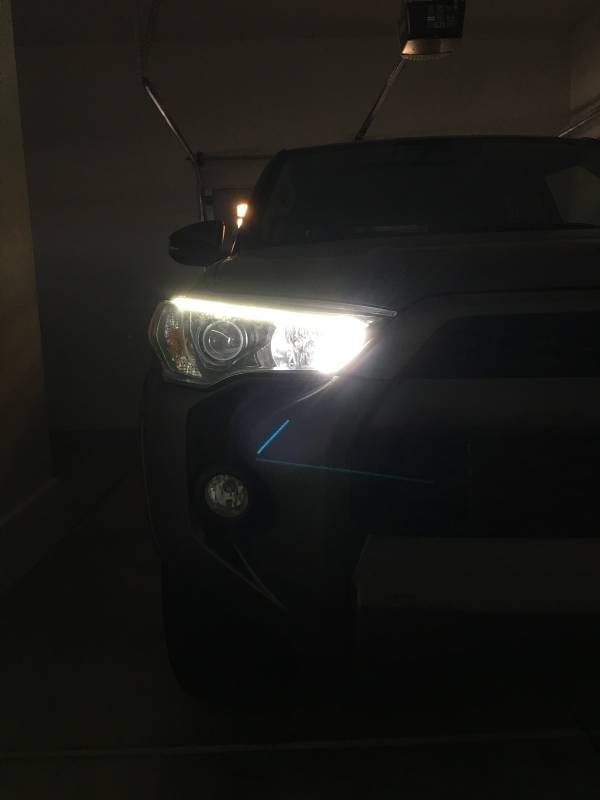

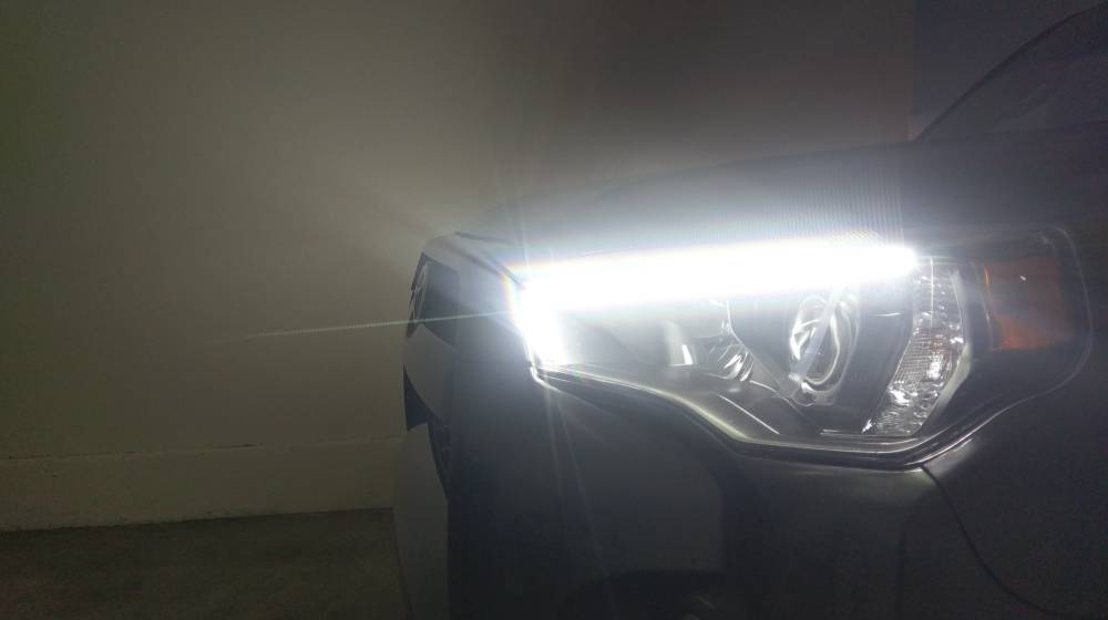

As soon as I posted the pictures of the cutoff, I realized I didn't post pictures of the running lights. Just to be clear, these come on all the time. As long as the ignition is on. Then when it's turned off they stay on for 15-20 seconds. They look mean!
Sorry this picture sucks. It's hard to get the camera to focus solely on the LEDs

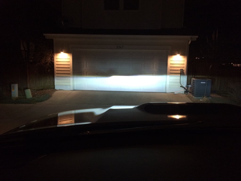

Here are photos of my cutoff. Exact same retrofit using IS350 projectors, clear lens upgrade and tuning.
Morimoto 35w ballast with Osram nightbreaker bulbs. Will be replacing bulb and ballast with 45w hylux and Osram CBI's soon for more output :)
