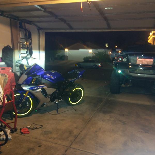

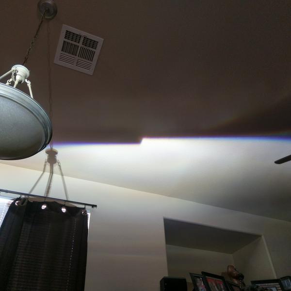

I havent had a chance to get nice closeups and still havent got any of the cutoff but its got the nice blue/purple cutoff like my Morimoto Mini D2S retrofit in my '14 Forester XT. Just not as sharp.

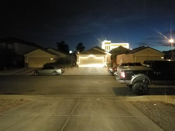

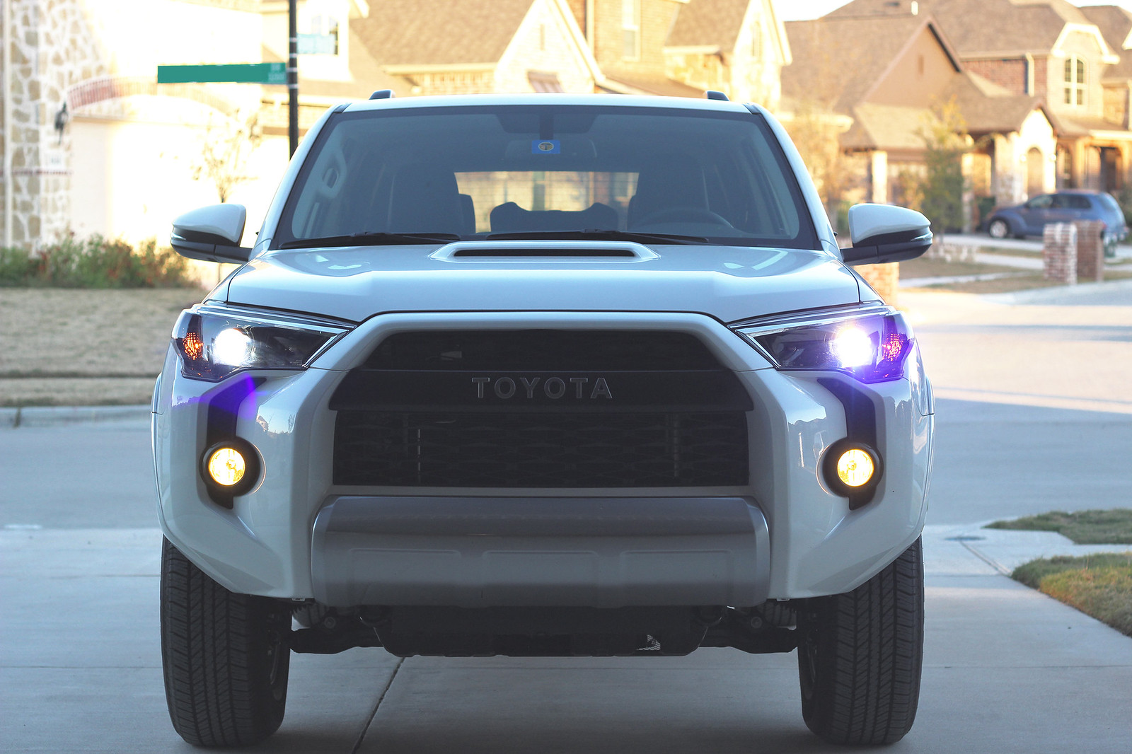

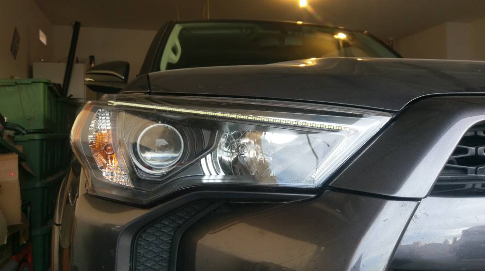

I will be making a build thread here really soon and will have more pics but here is at least one headon shot of my 4R frontend:
**edit: Lightwerkz has some closeups: 2016 Toyota 4Runner ? Black Out + HID Projector Conversion | Lightwerkz Gallery
I did the same retrofit through El Stig here in LA. Added a diode halo as well. Night and day difference in light output, hotspot, and clarity.

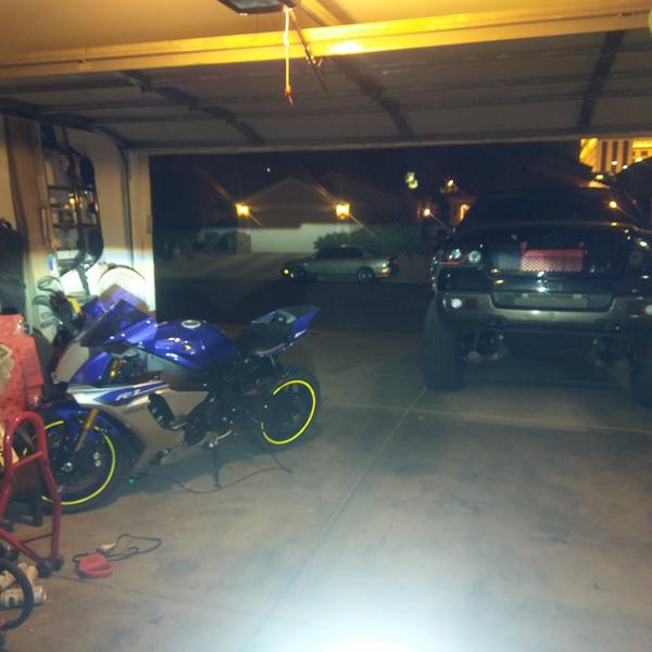

They are considerably better. The IS pros are a HID specific projector. Making them far superior to the T4R OE pros. Just as a reference I found. Here is the IS pros with their stock lens. The second pic if of the clear lens from the STi-R lens.
Stock Lens
STi-R Lens
The pictures don't lie.
I wish you had the stock halogen projector to compare. People just dont understand what a difference this makes...

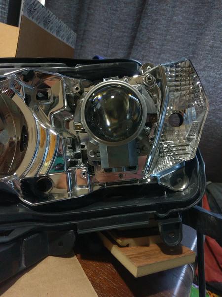

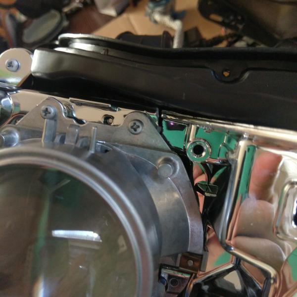

Another update. I got the Right headlight pretty much assembled. Just waiting on paint.

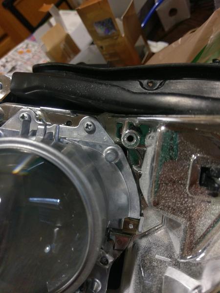

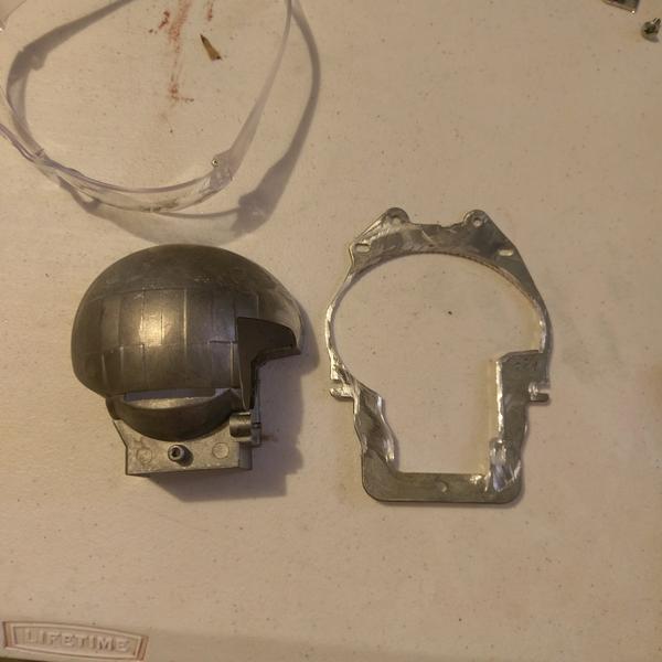

When I was bonding the back and front of the IS pro I broke a screw for the projector lens bracket. You can see it just to the left of the middle of the blue film. It actually doesn't seem to affect the output of the bulb. I guess time will tell. I may end up doing a quick epoxy job on that hole, but we will see how the alignment/test fit goes.
jakeko-albums-is350+projector++15+t4r-picture43293-i-broke-screw-projector-lens-bracket-you-can-see-just-left-middle-blue-film-actually-doesnt-seem-affect-output-bulb-i-guess-time-will-tell-i-may-end-up-doing-quick-epoxy-job-hole-but-we-will-see-how-alignment-test-fit-goes.jpg
This is the cutoff I found to be the best in my opinion. GF approved as well.

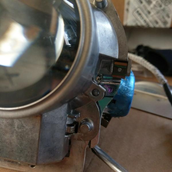

Well....I found something very unfortunate.

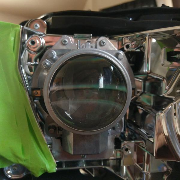

Here's the projector mounted inside the OE headlight shroud.
jakeko-albums-is350+projector++15+t4r-picture43309-well-i-found-something-unfortunate.jpg
And here is the unfortunate part. There is a huge crack that separates the halogen housing from the adjustable headlight portion. Which is a huge problem. It's just to the right of the top right screw on the projector.
jakeko-albums-is350+projector++15+t4r-picture43310-there-crack-here-you-can-kinda-see-im-going-epoxy-hope-holds-i-dont-have-%24-buy-new-headlight.jpg
Kind of a crappy quality/potato picture, but this is the projector warming up.
And this is it somewhat warmed up. This is the best I can do for now.
jakeko-albums-is350+projector++15+t4r-picture43312-kinda-warmed-up-i-think-cut-off-looks-great.jpg

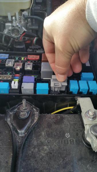

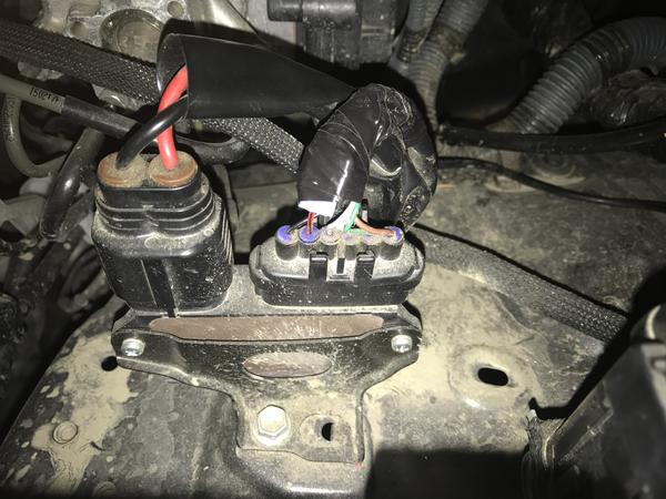

Okay, I think I figured out the LED wiring. I found in a post...http://www.toyota-4runner.org/5th-gen-t4rs/169979-drl-disable-but-keep-auto-headlights.html
In this post the they perform bending pin 2 in the headlight relay inside the engine compartment. I'm going to do this as well as connecting the LED's to the power block that is directly behind the fusebox inside the engine compartment where the headlight relay is located. I found on the last page that this power block comes on with ignition and disables 60 seconds after the ignition is off. Of course I'm going to double check this with a light tester to be sure. Here is what I'm talking about.
And here is the Power Block directly behind it.
The user than found this has a Canadian vehicle. So I hope it's not different for some reason.

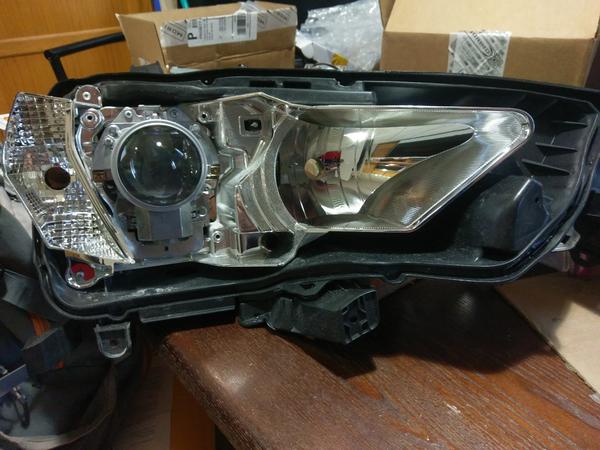

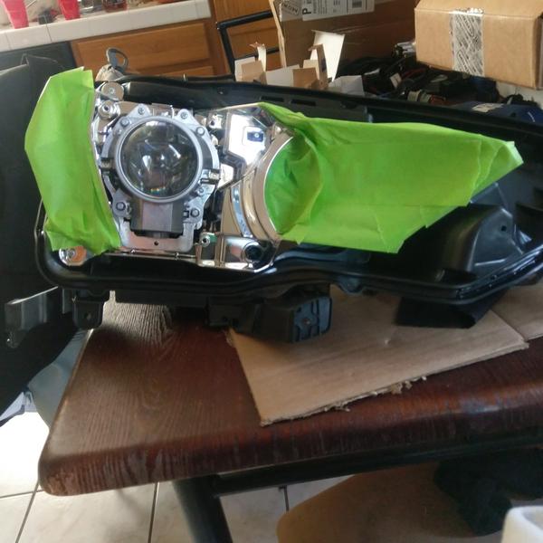

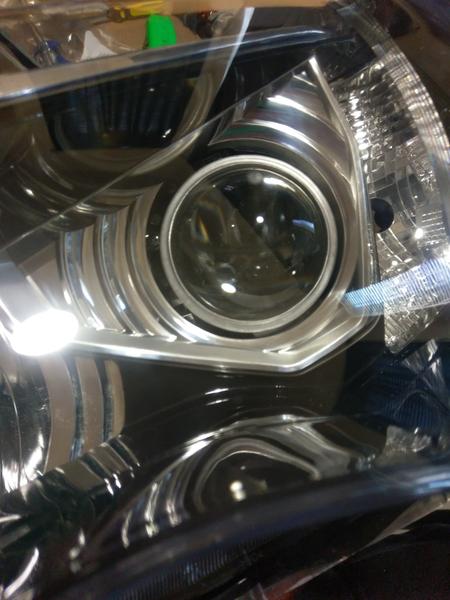

I got both projectors in their housing. I'm not happy with how the aesthetic shroud fits over the inner portion of the headlight but I'm not sure what I can do about that.
Here it is. It's not sealed yet, obviously. I need to install in her vehicle first to make sure the cutoff is level. It just looks a little cockeyed to me. Not the projector but the projector inside the shroud.

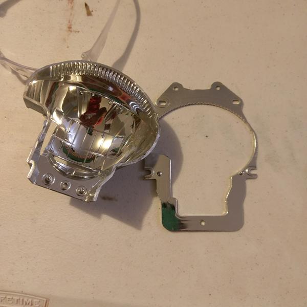

Also...I went a different direction cutting the other OE pro bracket off. This is what it came out looking like.
And here's another picture.
Honestly in the end...it didn't matter much because the entire bracket doesn't fit flat in between the IS pro. I had to trim. And when I was done, it pretty much looked like the first one I cut. HA. But I did find it easier, overall, to cut it that way. In this case, you can easily cut and trim to your needs. Plus the more metal that is there, the stronger and easier it will be to work with.

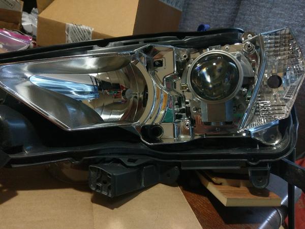

Here's the projectors mounted inside the shrouds. Along with my Epoxy job. Which seems to be holding up just fine.
Oh, BTW. I did have to trim some on the inside of the headlight shroud in order for it to fit properly and not rub. That's what all that white dust looking stuff is.
Left side.

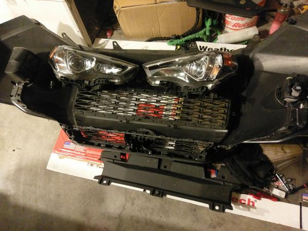

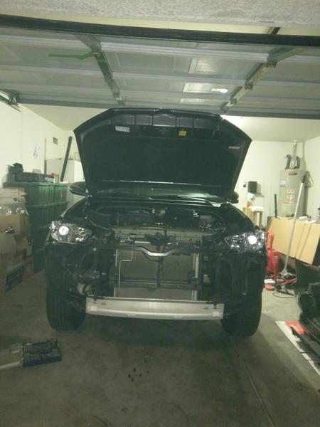

Big update...Kinda
I pulled the bumper, headlights and put the new headlights in temporarily. Overall, I'm happy, but the passenger headlight still needs work. It's the one I broke the lens screw on. I think I'm going to drill it out and worst case scenario, drill all the way through and use a bolt/nut to secure the lens. It needs adjusting and I know it can look better. Other than that, I think they look awesome so far!
Here's what I pulled off the truck.
This is the cutoff of the Halogen projectors. Front a distance, they're not bad. But wait for it.
Here is the bumper off, old headlights out and new headlights in. They are bare and don't have the clear housing or aesthetic shroud around them. Strictly for fitment and analysis.
Warming up...
And.....BOOOM
Like I said, the right/passenger side needs a little tuning. But damn and I'm happy so far.
