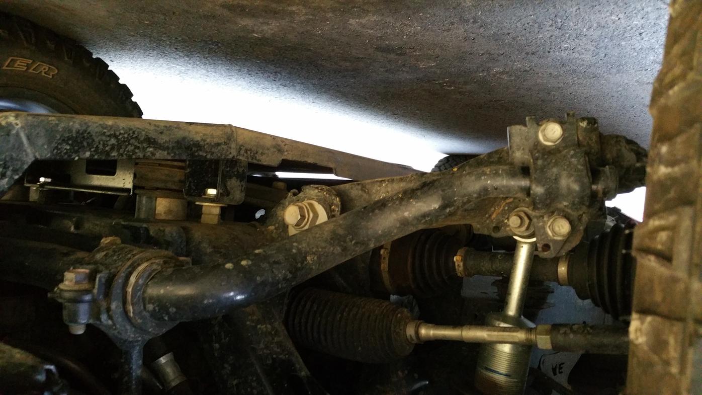

Interesting thread only because I have this same sound. But I believe i've located mine as being part of my suspension as I only hear at bombs and intial movement of the vehicle. I've check bolts, everything and from what I can gather its just the inital movement of my spring/coil because after that one movement or bump I never can really hear it. I've triple checked all my bolts, nuts space. Look at your front suspension (upper and lower a arms). Do you have some space on your lower play arm where the bolt slides through? Here is an example.
I know the picture is upside downm,i apologize, just got done with surgery yesterday and it takes a long time to move at all. You see the bolt that has the adjustment for alignment, that is where you may appear to have a 'gap' i believe that is WHERE your sound is coming from.
Let me know
