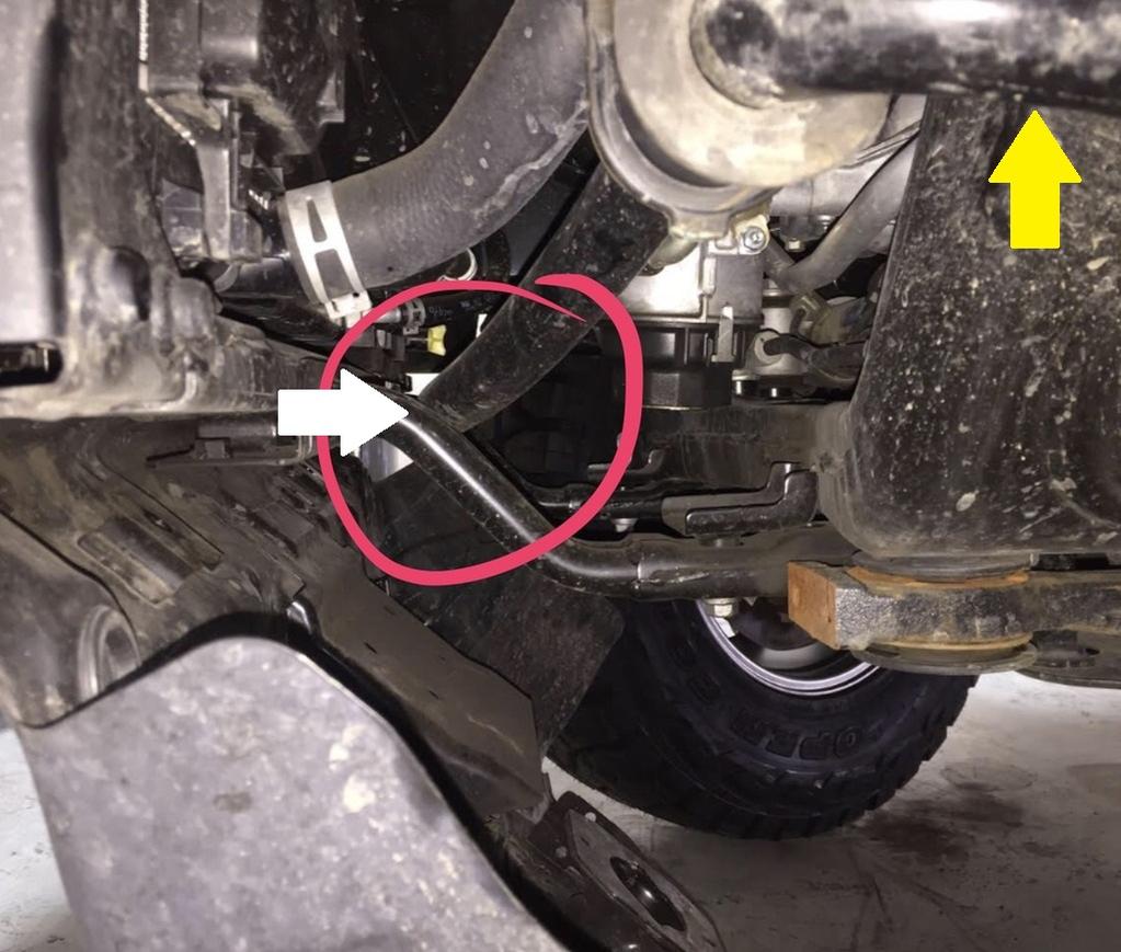

I had same issue for the longest time and I discovered my sway bar was sometimes hitting the lower radiator support bars.
I removed those braces when I installed aftermarket skid plates and no longer have the issue. Ignore the yellow arrow on picture, I stole this pic from another thread
That is a bad idea. Those braces are structural supports for the front suspension. ARB makes a kit that has a new driver side support with more clearance so your swaybar won't rub. Look at my build thread for more info
I have looked at how structural it is and I dont see them being that important. You have to remove them for aftermarket skid plates. They are hollow tube and the skid plates are as strong or stronger than those hollow tubes. And I don't believe they are for suspension support, they are simply a radiator support. But the skids will do the same job
