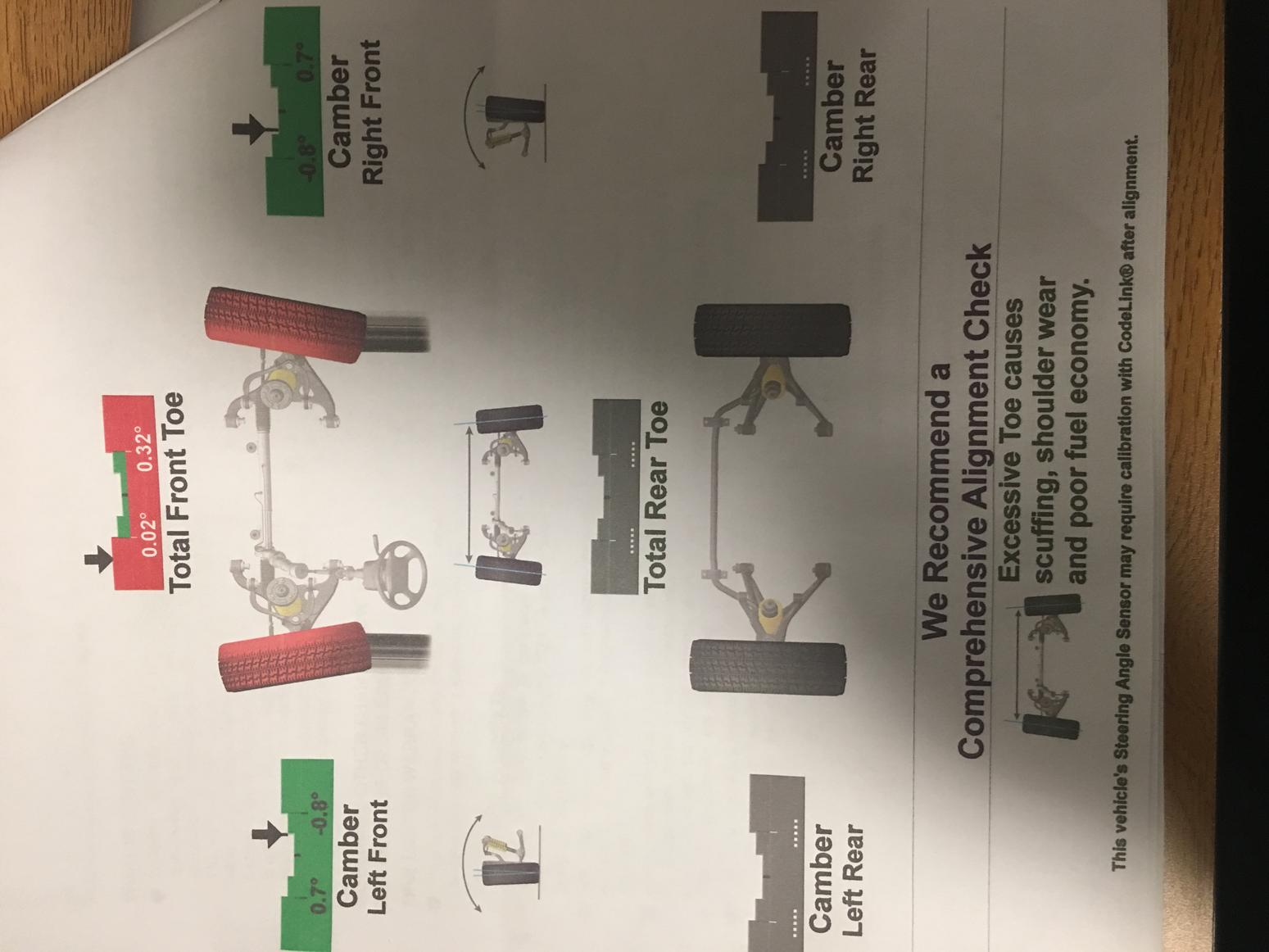

Went in to the stealership for my routine warrantied 15k mile inspection, fluid top up and so on. When I went to pick it up they told me toe was off? I am aware of what these values mean but I'm curious what you guys think about this, seeing as my truck only has 15k miles on it. I haven't hit any curbs at anything higher than just barely rolling, no wreck, no lock up breaking, nothing.
One thing that ran through my head is if they are just doing this to get an extra $50 out of me for an alignment. They said this can cause improper tire wear but my tires are all wearing very evenly and my MPG is average right around 19-20 even with a good bit of city driving.

Attached is the alignment sheet.

That looks like a "quick-checker" I've never really liked those machines, they don't seem to be as accurate as I'd like. To me it just says "total toe is off" which means either the steering wheel is off-center (because maybe when they did the quick check the didn't make sure it was centered properly) or because the alignment is actually off...

And I agree... that report looks like some sort of scam. The only way to check alignment is to put it on an actual alignment rack. Stupid dealers are always looking for ways to steal money from owners. Don't ever trust anything they say. It's sad, but true.

As I said above, that print-out looks like a "Quick Alignment Checker", in my experience they can usually be somewhat accurate on Toe, but when it comes to Camber & Caster they are almost always off. Additionally if you've seen that most of the time lube techs are doing the quick checks, there's a margin of error there.
"Total Toe" means that both sides added together exceed the specified value, Total Toe can be use to determine which way the vehicle is pointing; so if the quick check was done and the wheel was turned slightly, that'd easily throw those numbers off.

This is what pointed towards me saying that this is just a bunch of hooey so they can extort $50 from my right cheek.
