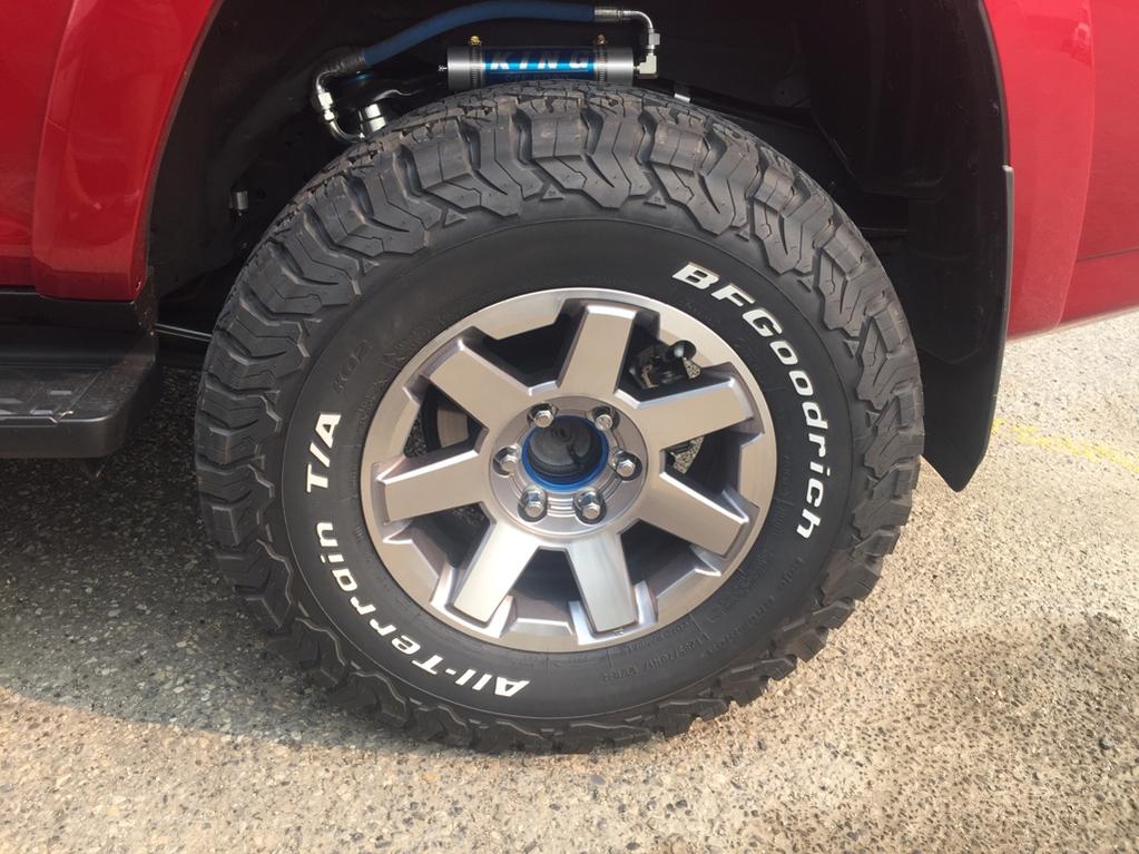

my TEP with stock rims and 1.25" spacers for reference

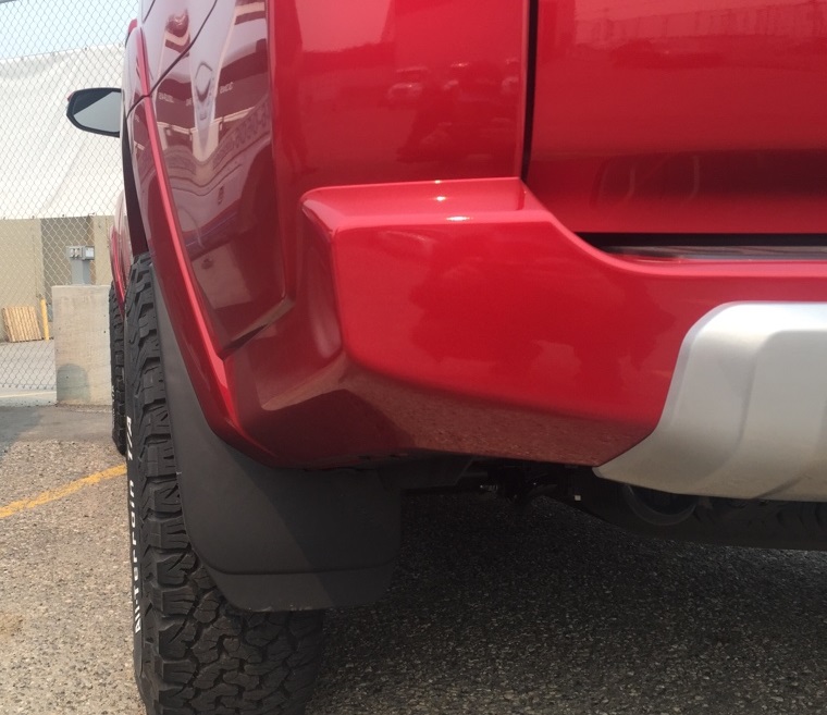

Actually, I think the Pro wheels might stick out a little more than the trails. Probably not enough for what the OP is going for, but they did have to trim the Pro bumpers at port because of rubbing. I am assuming this was because of a difference in offset.
Not the increased tire diameter? Granted I don't know what the offset is with it being a narrower wheel.
They are the same size as a stock trail. Maybe the ATs have a little more diameter? I have no idea what the offset is either.

There are several wheel calculators to show the difference...yet the TRD Pro wheels stick slightly more outward than stock, but not as much as the stock rim with a 1.25" Spidertrax spacer.
Based on the wheel specs from [MENTION=9411]Diesel[/MENTION] above, the Pro wheels stick out 5mm more than the Trail. Not near enough I am sure for the OP.
