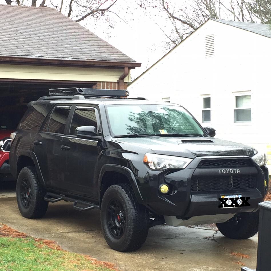

Heres a pic pf my 2014 TEP with TRD Pro Rims and Spider Traxx spacers. Absolutely love it and zero issues!!! :-)

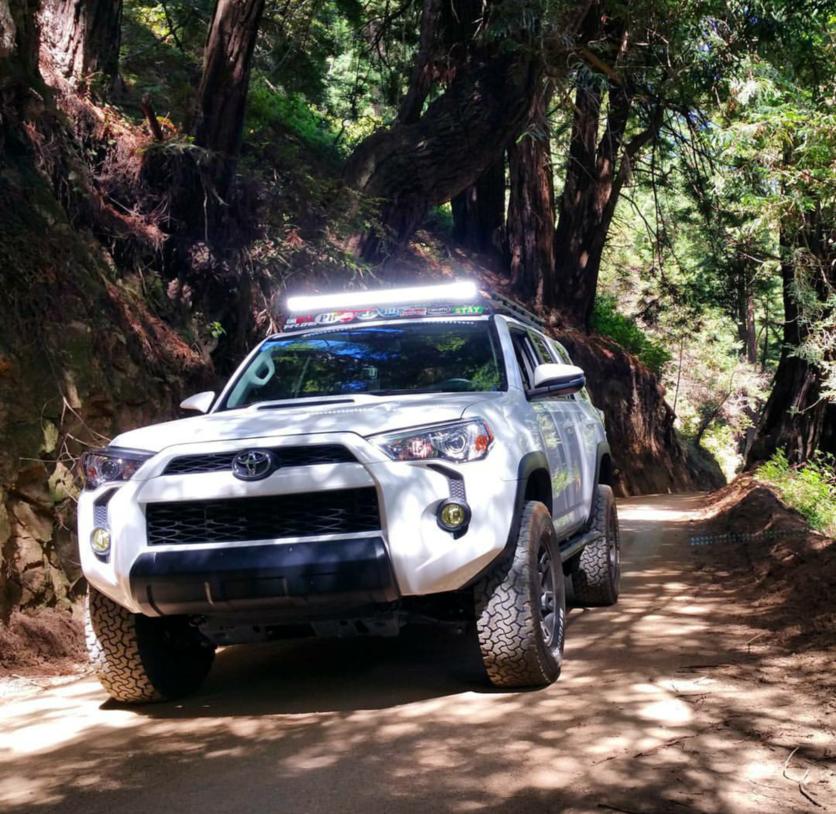

TRD PRO wheels with 265/70/17 Nitto Terra Grapplers and Spidertrax wheel spacers. No regrets.
