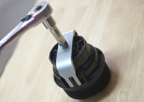

I have been using the assenmacher tool for about 4yrs now and is not absolutely needed but at Under $20 IMO why not.
I have the assenmacher tool as well its great.
when I got the new truck I got this one from a spec racing on ebay. The tundra guys swear by it along with the aluminum canister from the venza.
both are great, I like how the a spec one grips the canister by the tabs so there is less of a chance of it slipping, but then the assenmacher doesn't slip.

Has anybody ever broken one of those tabs with type of tool? Since the factory tool is designed to distribute the torque over 14 flutes instead of 2 tabs, I'll probably stick with the AST TOY640. Both types are probably fine though.
I have a 2016 changed the oil using the 640 socket and followed the DIY. Pretty straight forward. Will likely add a fumoto valve in the future.
If you break those tabs you're doing something wrong. Changing the canister filter is a pretty low torque operation as far as vehicle maintenance goes. I've used that tool for 5 oil changes thus far with no issues on the OEM plastic cap. I wouldn't worry about it.
i agree, the canister shouldn't be on that tight.

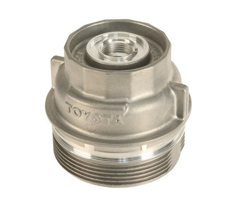

If you are really worried about breaking the canister, for about $30 you could upgrade to the Venza's aluminum housing.
On another note I did break my kd tools oil filter wrench on my corolla the first time I didn't let the dealership change the oil. That's when I bought the assenmacher wrench and use a 18" breaker bar to loosen it.
I like that idea; what screws into the threads at the top (of the pic)?
Thanks,
Thanks,
There is another cap. It's used to drain the oil before removing the housing.

I bought the tool off amazon, works great. Also bought the aluminum housing because, well why not replace plastic with aluminum for $35 on something that important.

I just got my motivx tool and the aluminum oil cap but it doesn't seem very snug, lots of play? Like if I twist it, it looks to just be torquing on the two tabs... Can't see inside but definitely hitting on the two tabs... Is that right?
the filter cap removal tool fits good on the plastic toyota filter cap. not tight but to me secure .. better than the $10 soft thin metal cap removal tools .. good lock on this motivx socket.. since I do not use dealerships IMO I really do not need it but perhaps some day I will need it ...
I half figured that would be the case given it's high rating, that is work well on the plastic cap. I might try and find another that works on the aftermarket aluminum cap (I believe the stock Venza cap). Thanks!
