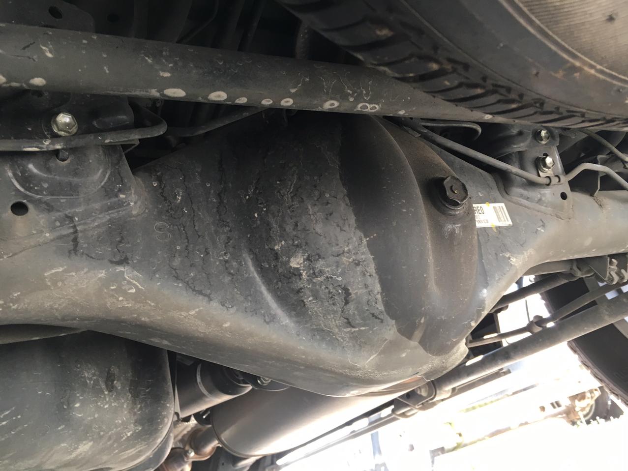

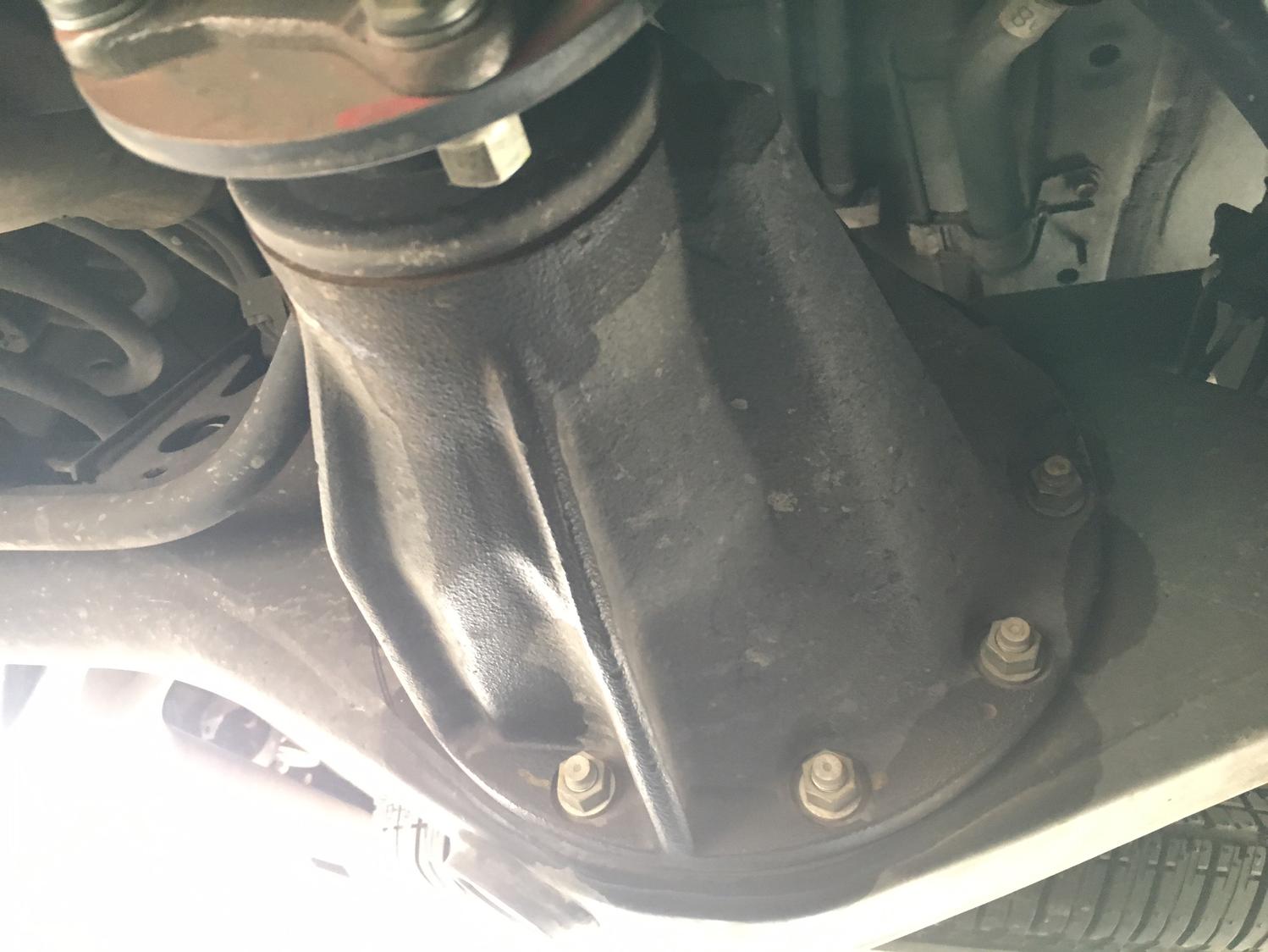

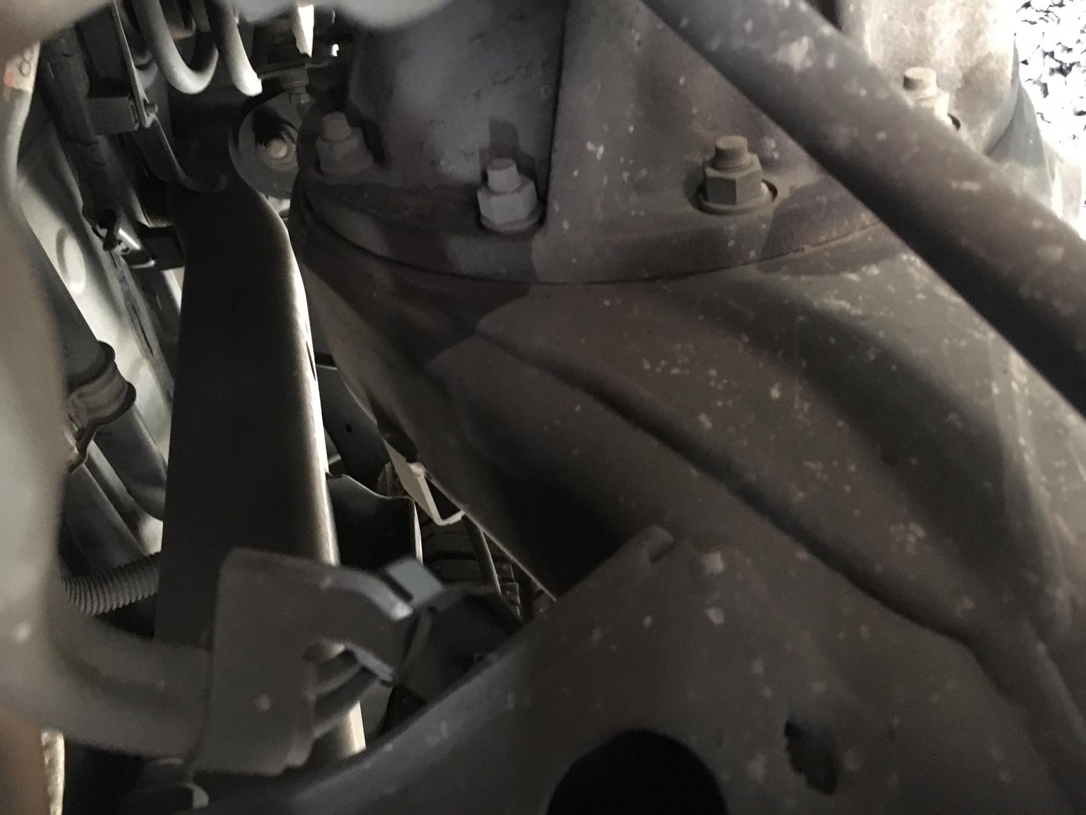

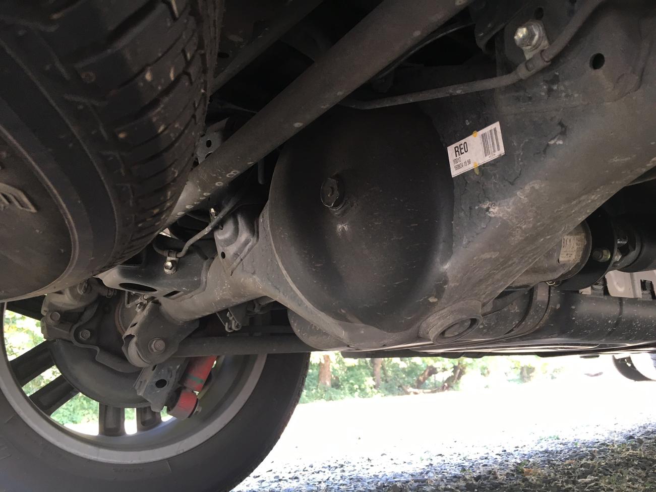

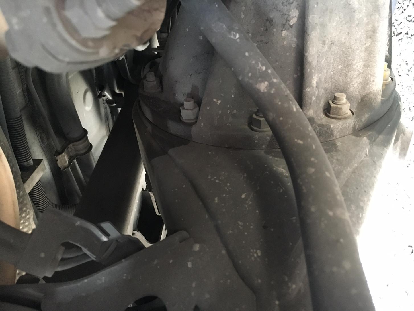

One other thing to mention. Does anyone have a rear diff that appears to be somewhat seeping oil. Nothing drips but you can see how it is oil has seeped up from the front of the diff to back over the rear housing (appears that the dust/dirt is oil stained). Then you can see how it is seeping out between each bolt that holds the main housing together. I will go out and get a picture of it.
I had the wife originally bring it to the dealer for the seeping diff. I actually checked the oil level and it was a touch low. The guys all told her nothing was leaking and it was fine. Even though the car only has like 15k on it. LOL Seems a little unusual to me. LOL That was the last time I had my wife bring it in. Now they are dealing with me.
Here are the pictures of the rear diff housing. There is some oil residue on the bottom of the housing due to them lubing up the u-joints and the seal at the driveline. Some of it leaked down to the bottom of the housing. But the rest of it has been there.
You can even see how the oil has came out of the top of the housing and is coming down the back side. Thoughts?

That oil leak/slick doesn't look right. I'd jack up the rear end, put everything in neutral and have someone rotate the wheels while you have your hand and ear by that diff to see if you can hear and feel any vibrations coming out of it. Maybe (big maybe) the assembly wasn't done right in the diff, or something gave out early??

Also, pull your rear oil drain plug if you want and check the fluid for metal. If the diff gears are acting up, it would be pretty visible in the oil, especially with such a new vehicle. Or did the dealer already check that?
