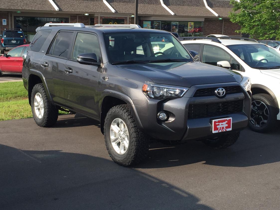

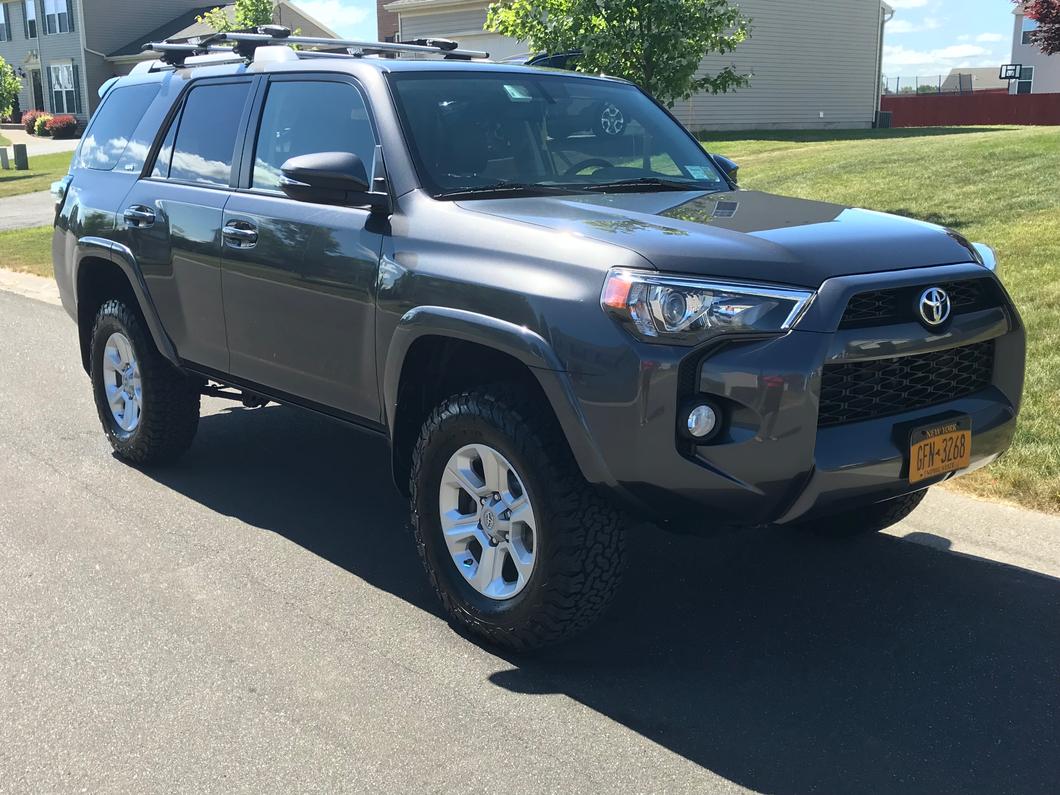

I started with swapping the OEM tires with BFG All terrain KO2's when I bought my 4runner. These tires are surprisingly quiet. Recently added Bilstein shocks all around with a spacer in the back. The front shocks are adjustable and set to 1.75" of lift and the rear has a 1" spacer with new shocks. I'm really happy with the setup since it gives me a little lift more aggressive tires without sacrificing ride or MPG.
1st pic - no lift; 2nd pic lifted
