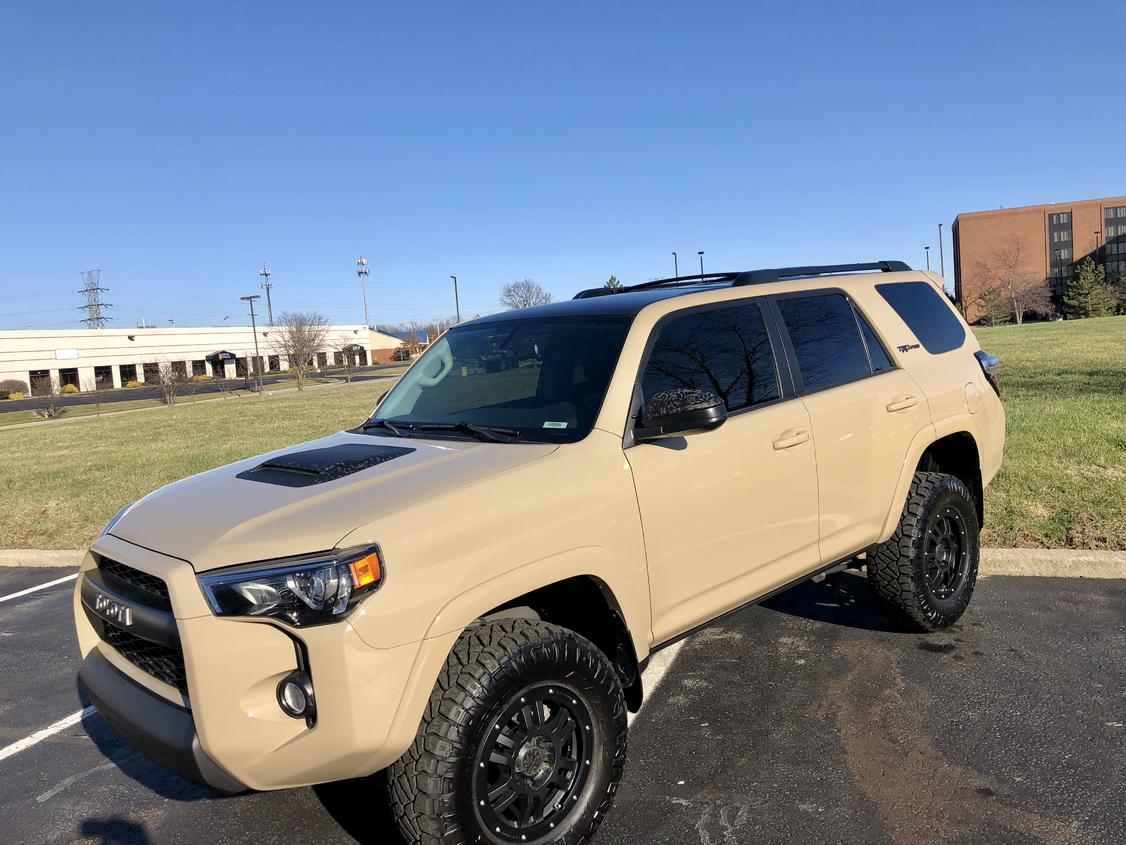

I have a 2016 with 65K miles, I am having my local shop swap out the Original Front Coilovers (along with the Toytec Spacers I put on in 16) for the newer PTR13-89160 Front Coils to remove the CLUNK. I am thinking I should replace the rear absorbers with resi's at the same time. I can't find the Toyota Part Number anywhere for just the rears, I already have the fronts I bought as take-offs from a guy.
Anyone have the part number for the rears with resi's handy?
