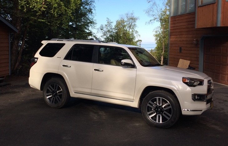

Thank you for all the help. Picked it up yesterday. No running boards because of the snow depth. All I need is a second set of wheels and tires for the winter, and how to set the TPMS on those.

32 years in the making an we're still arguing about what rear axle they come with, Love it!
Congrats on the new ride OP
Exactly...you know I had a 1984 4Runner, so this is the bookends of my 4Runner history. The first and the latest.
